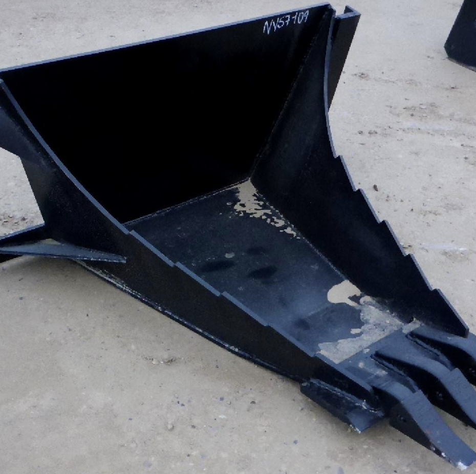

I am in the exact same situation as you. I have 14 acres of small trees, brush and privet mixed into a hardwood bottomland forest. I rented a bobcat with a Xtreme duty brush cutter a few weeks ago and it did a pretty great although messy job clearing 4 or 5 of those acres. By messy I mean, chunks of trees and stubs sticking up. But overall it is a great start to my clearing endeavor. I can at least get in there and assess what to do next. I am mostly concerned about getting out the 2-6 inch garbage trees intermixed with my nice hardwoods. I am leaning towards a stump bucket. Push the 2 and 3 inchers straight over, I think my 4000+ pound Branson can handle that. The bigger ones that won't push over straight away I think will with a couple quick cuts with the stump bucket. Once those trees are gone I can come back with the bush hog and clear the little stuff. I think it will be WAY easier than getting on and off the tractor hooking up chains. MTL has a pretty nice stump bucket for $469. It is a couple hours from me so I will save the $149 delivery by going to pick it up. Here is a look at the stump bucket.
Same price and considerably more heavy duty than the Titan one. At ~350# I don't think it is too heavy for my FEL rated at 2200# That is the route I am going, think it is the right one for me. And maybe it will prompt me to get a grapple to clean the mess I make.

Do ypou have a link to the MTL stump bucket? Thanks, Jon
I found that one on Ebay by searching "stump bucket". The $469 DOES NOT include shipping. Shipping is $149 extra. Might not be a great deal if you have to pay shipping. I live 2 hours north of their headquarters, so I am going to go pick it up and save $100. You can look at all of their attachments on Ebay of their website.

I almost thought about making something like this with a piece of 1/2 plate I have laying around. But I have a few more projects that a stump bucket will be handy for so I think I will spend the money and go that route. Also, I was planning on clamping to the pre drilled tooth holes on my bucket, but I was worried about bending my bucket.
