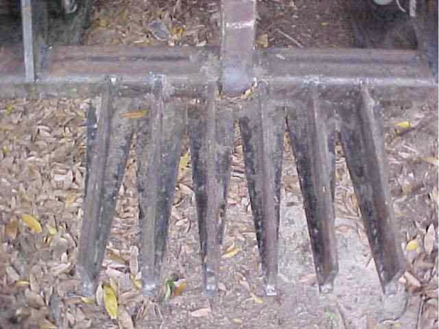

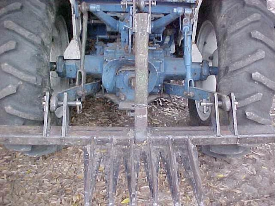

One of the regulars on here 7 or 8 years ago posted pictures of his "TreeGetter". I saved the info, but unfortunately, I've lost track of who it was that made it. He welded it up to fit the 3-point hitch on his compact tractor. I believe he got the idea from a design made to go on the front-end loader of a much larger tractor. He went with the 3-point hitch mount, since his tractor did not have enough lifting power to do much good mounted on the front end loader.
In operation, he just backed up to a bunch of saplings with the hitch down low. Once the saplings were wedged in, he lifted the hitch and pulled them out, roots and all... leaving none of the stubble left by brush hogging. He also said he had success pulling out up to 2.5 or 3 diameter trees with this, depending on the tree species.
The pictures below are of an incomplete version of the equipment. Eventually, he added teeth across the entire bar, so he didn't have to aim at each specific sapling. I've since seen another version that I thought looked better: It had diagonal braces running from the horizontal bar (near where the lower 3-point hitch arms attach) up to the vertical arm near where the upper link attaches, forming a triangle of braces. This seems like a much stronger construction to me. It would better resist bending of the horizontal bar when pulling up a sapling that was off-center. (Unfortunately, I don't have a picture of that unit). I've always thought this concept was an interesting one, however. One of these days I'll try it out myself.
Some info from the original builder:
The crossbar and the upright for the top link are made from 2 X 3 X 1/2 wall tubing.
The fingers are 15 inches total length (that leaves 12 inches sticking out from under the crossbar) and are made of 1/2 X 3 flat bar.
I left 1/2 inch in the center of each finger and tapered them back 11 inches. Each finger has a piece of 3/8X2 flat bar welded edge ways and welded to the crossbar to prevent the fingers from bending.

Neal,
That is a great build. I have sandy soil so pulling up trees will not be very difficult and my FEL has 4000 lbs of break out force so plenty for the task.
Regretably I have no metal working skills but if I did I would construct one. I may contact a local welder to see what it would cost to build one. Andy thing you would do differently now that you have used it for a few years?
