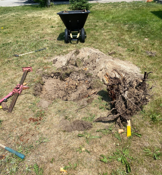

By far the easiest way is a tree/post puller for about $1200.
