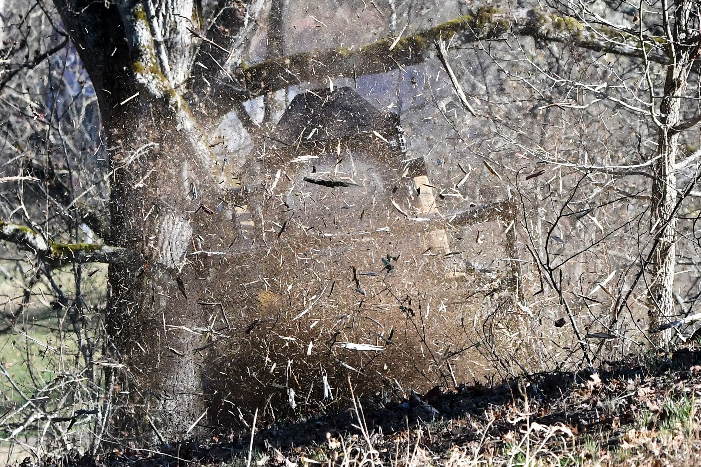

I'm currently paying $185/hr to have forestry mulching done. He gets more done in an hour than I can do in a full day with a small backhoe and tractor equipped with a grapple.
