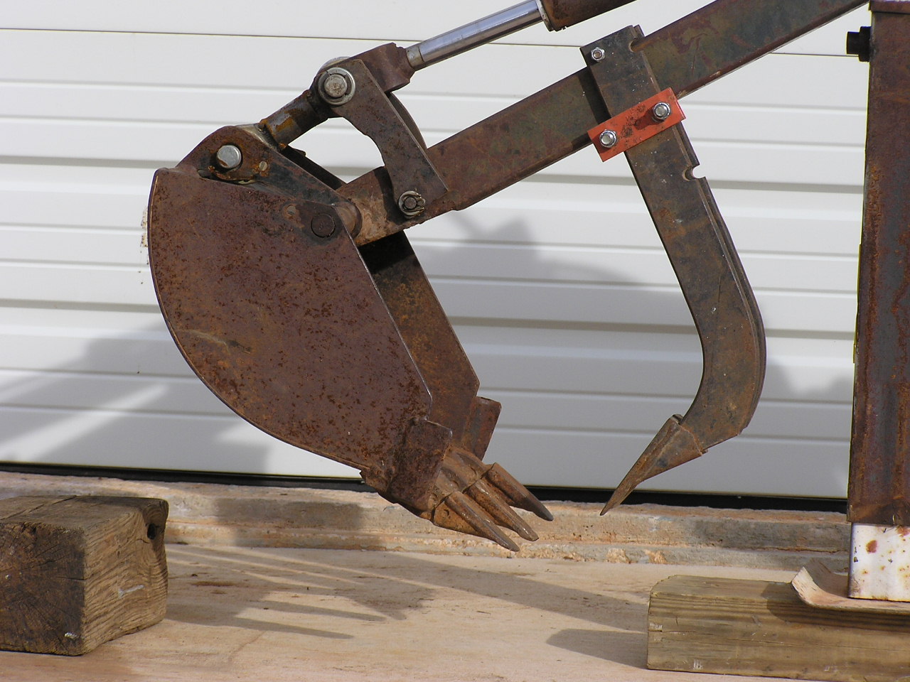

It works pretty good so far, I've been ripping out some sort of clumpy bushes, like a bunch of tree saplings grouped together, at some property my mom owns. I was trying to ram the brush hog over them but they were so tall and thick it would just push them over and ride over top of them. So I came up with that instead. Yank out the clump, then turn around and pick them up with my bucket/forks and put them in the fire.

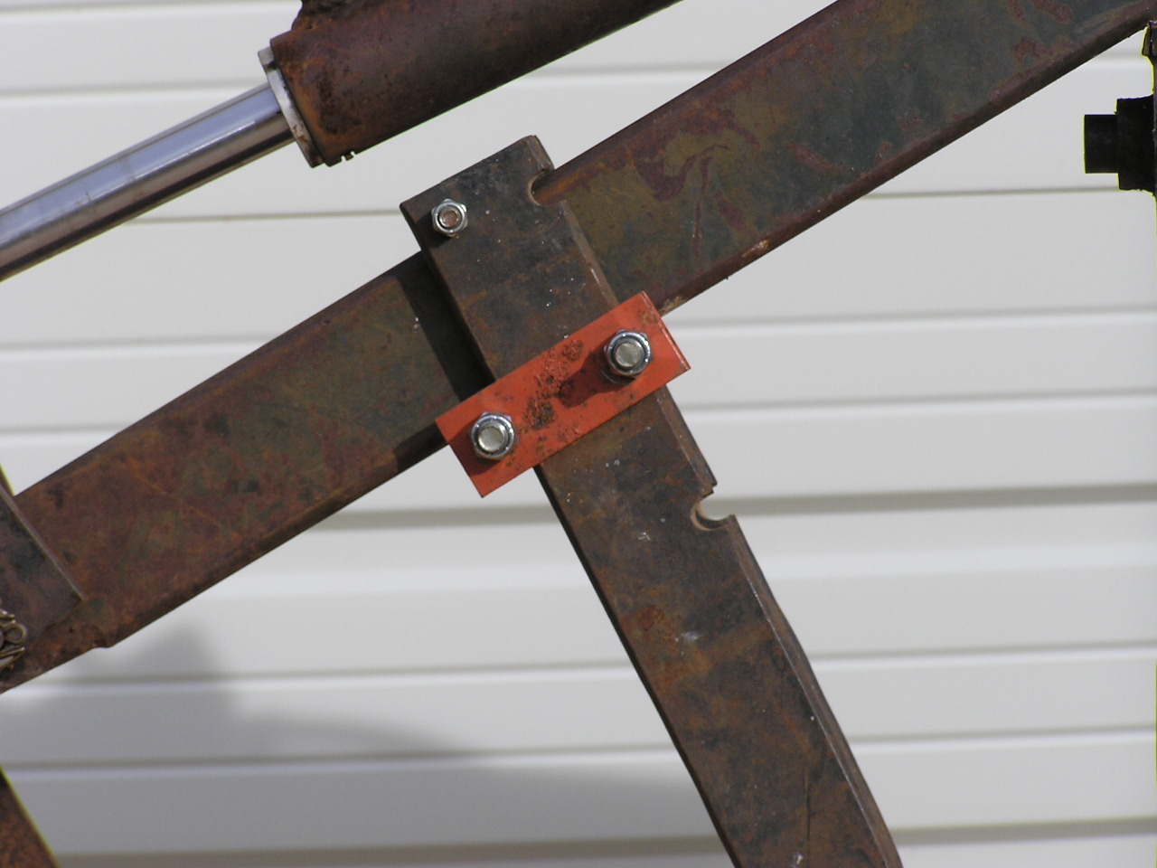

The rippers need a little cant to the outside, junk gets built up between them but it's more of an annoyance, it doesn't really effect function. I bought a torch this week so I can cut and bend some steel for rippers and put the ones in the pics back into the box blade.
Bamboozled, I picked up a 6 ft piece of 2x2 to start making one of these tonight. My intent is to use it to cut stump roots on each side prior to pulling them out. I wanted the longer distance away from the rear of the tractor if it will work better than a subsoiler.
I plan on getting a scarifier tooth at TSC for it as my land pride box blade has the teeth that have notches in them instead of bolt holes.
Would you do anything different in Revision 2.0?
This is on a Kubota L3301/HST.
My idea is to back up on the stump, cut roots on each side, then turn around and try to work it out with either a piranha tooth bar or the grapple. I have about 20 that are from 4" to 8" diameter cedar and hardwoods that I cut about 3 ft tall.

-------- I picked up a 6 ft piece of 2x2 to start making one of these tonight. My intent is to use it to cut stump roots on each side prior to pulling them out. I wanted the longer distance away from the rear of the tractor if it will work better than a subsoiler.

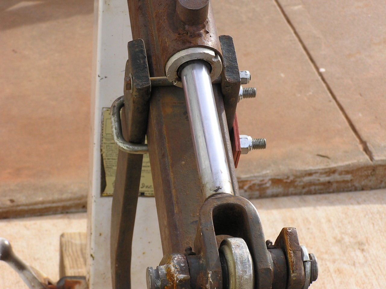

This might work for you.
I drilled a hole at the top and used square u-bolts to fasten them on the boom.
If you are just using one ripper, my suggestion would be to mount it through the tubing to center it up. You could notch out the end of the tubing, then drill a mounting hole and slide the ripper into the end.
My other suggestion, if you are going to try to cut roots, would be to knife edge the ripper shank. Either by grinding it or adding some flat stock and building it up with weld, then grinding it. I did this to my subsoiler awhile back but I haven't had a chance to test it yet. I need to do something similar, try to cut/rip about 50 small stumps out of the ground, from 2-6 inches in diameter but I plan to use my subsoiler as mine are all cut at ground level.
When I did my subsoiler, I welded a piece of 1"x.25" flat stock in the center on the front of the down shank. Then built up the weld until I had enough to grind into a knife edge. That baby is sharp enough to cut paper, at least for the time being....
