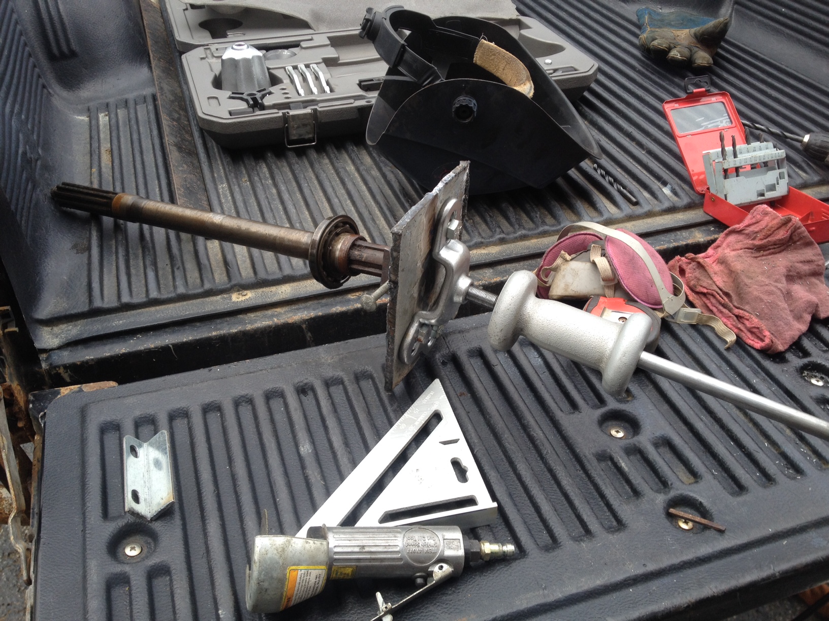

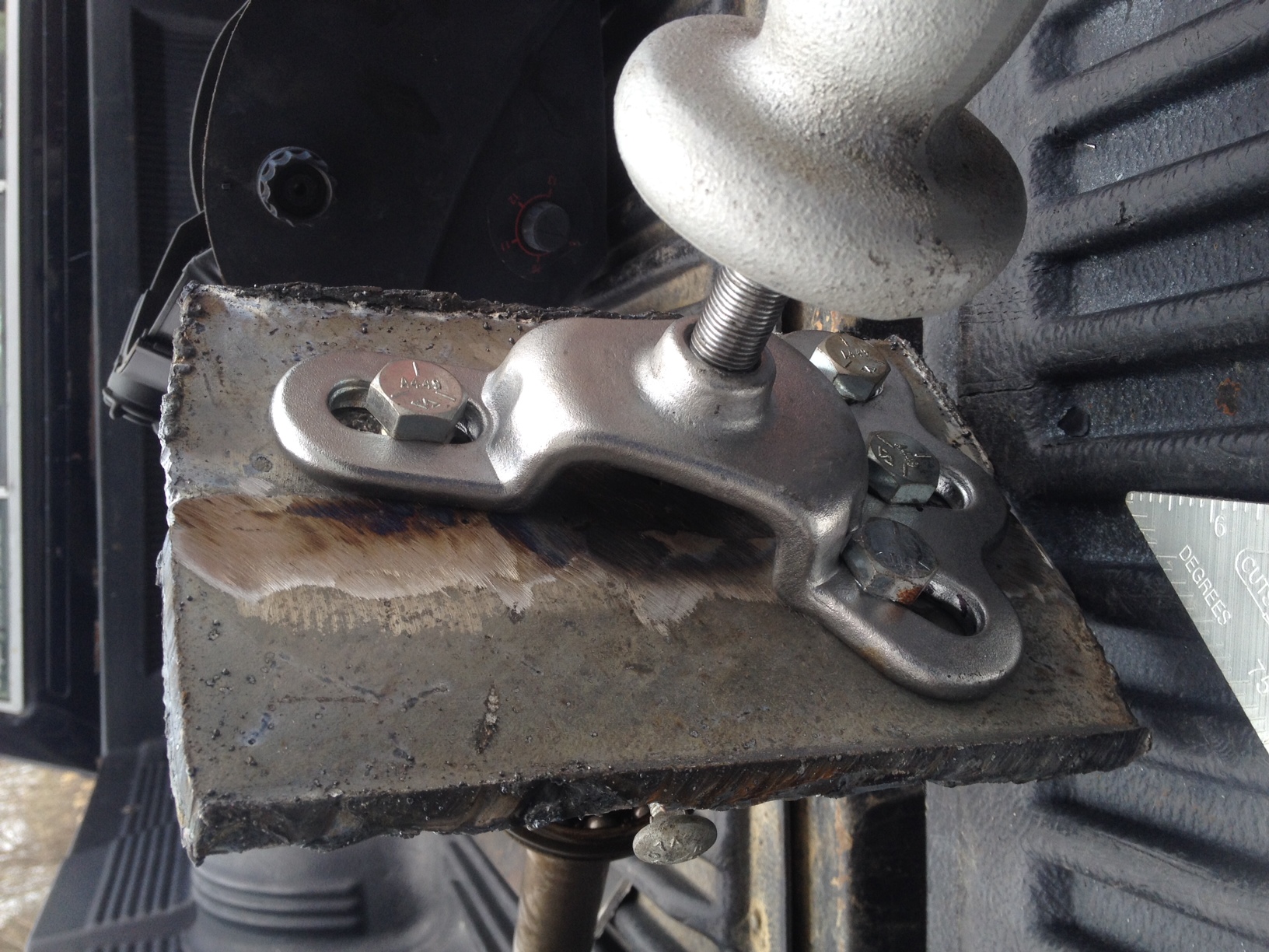

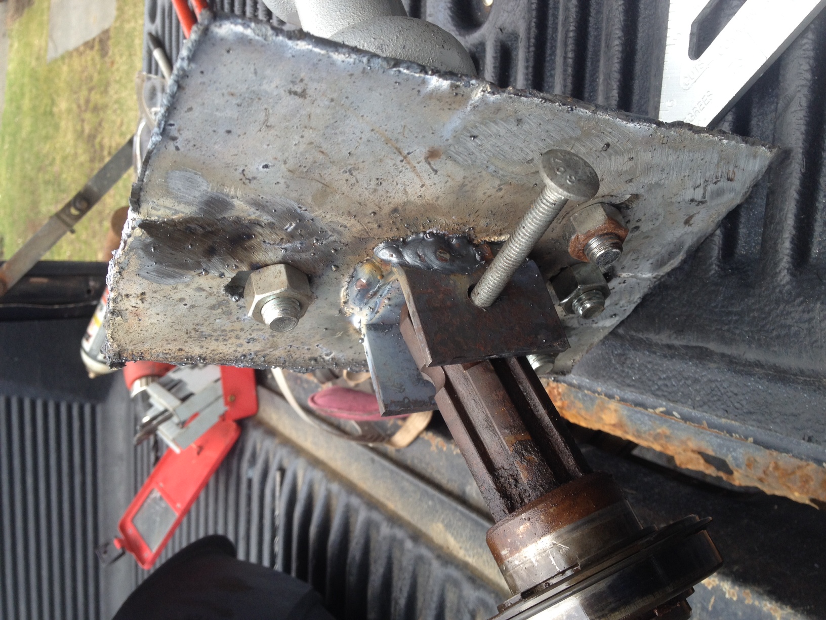

Well, I got it out. It's amazing, I had tried a 6' pry bar attached to a chain last week too. No luck with that. I shoved the bar into the ground and created a nice sturdy hole and let it rip. PTO shaft wouldn't budge. So I tried the D-ring method, but I couldn't get it tight enough and it kindof acted like the chain, it seemed to take up too much of the blow from the slide hammer. So I tried to think of ways to hook the slide directly to the PTO, or more solidly, anyway. Considering I'm working on it at my parent's house, it's not uncommon to see my father wandering around with the dog. He walked by and suggested the method that worked like a charm.
I found a piece of heavy angle iron, grabbed my plasma cutter and cut it down the middle. (I couldn't find anything else thick enough). Ground it down, welded it into a flat piece of steel. I traced the slide hammer end in marker, cut out the holes and bolted the universal end of the slide to the plate. On the back side, I bent up a piece of band iron into a U-shape, drilled two holes and welded it to the larger plate. I stuck a bolt through to hold it to the PTO shaft, gave two very solid hits with a 5lb slide hammer and the PTO shaft ended up in my lap. Excellent.
Now the hydraulic pump is out, sitting on my workbench in my basement. Sometime this week I'll start pulling it apart. I've attached a few pics to make it clearer what I did to get the shaft out.

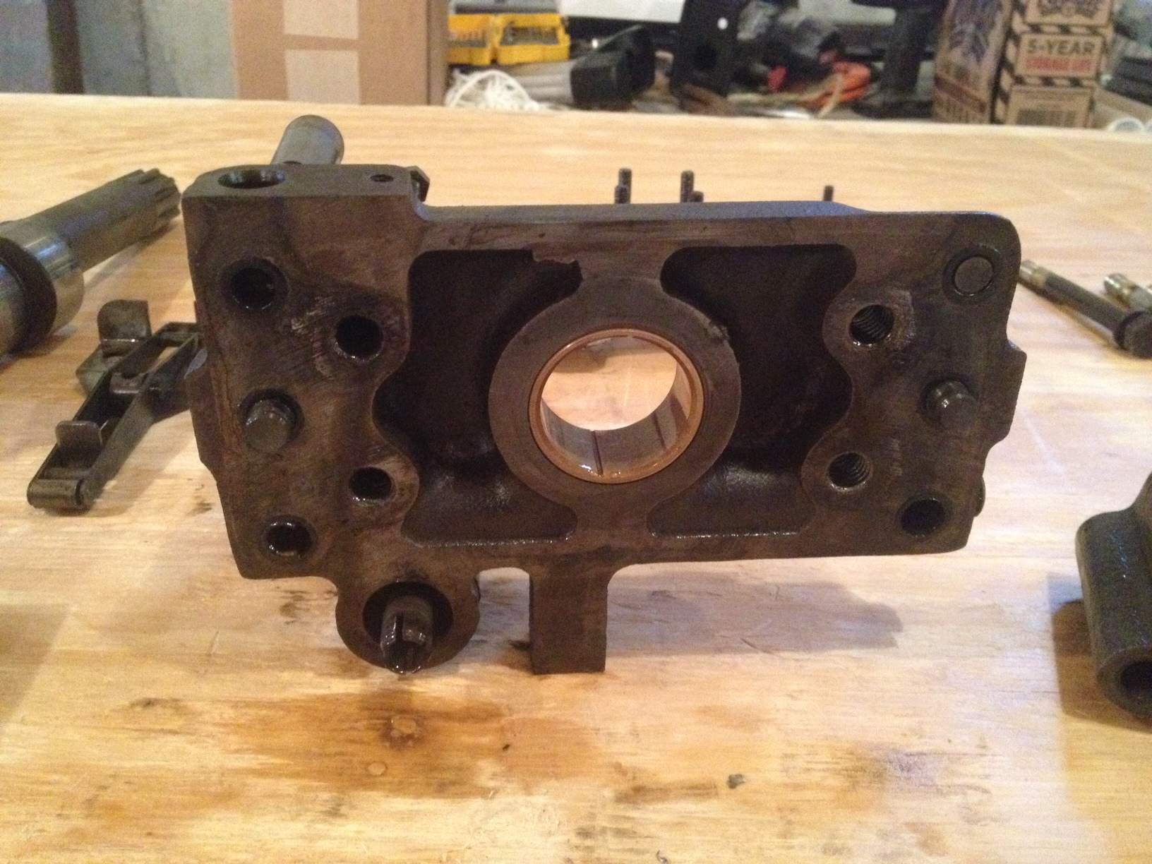

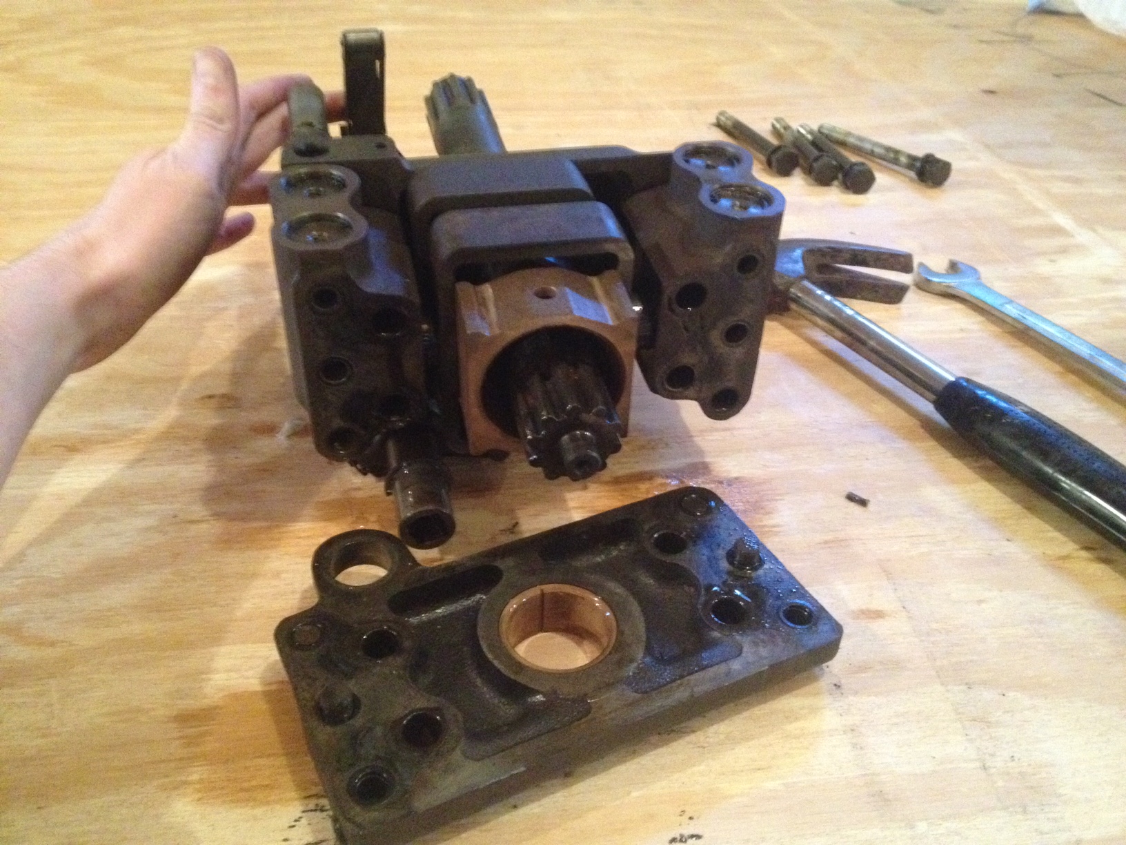

I've got the pump torn down, I just need to grab my snap ring pliers to get the valves out for inspection. It looks like work may have been done to it at one point, though I can't be sure. I found a piece of debris in the pump that might be the remnants of a broken piston ring. I find this odd because my pump is fitted with the filter, but I digress. There is a little marring of one of the brass journals, but I can't feel it with my fingernail so I'm not overly concerned about it. I forgot to take pics (my hands were very oily, so not a lot of pics) of the brass cam blocks. There is a little marring on them, too, but not on surfaces that make contact with anything else. It looks like debris fell on top of the pump and as it rotated, got crushed against the pump casting and pistons. I'm checking with my local Massey dealer today to see what he thinks, he used to work on these machines daily so I trust his opinion.
Also, of note- for anyone looking to rebuild their pump, the Vintage Tractor Engineer DVD is truly the way to go. It takes out all the guesswork and goes into great detail. I'm pretty certain I could have pulled this apart and put it back together, but they go into detail about what to look for, and all the adjustments you need to make to the control levers and draft spring to make your hydraulic system function as intended. I highly recommend it!
On to the pics, they're grainy because I was working in my basement. My hands were oily, so cut me some slack. :)

Yep, I had a concern about the brass cam blocks being slightly scored, even though the scoring isn't on a mating surface. Local Massey dealer says they're fine. Looks like a good cleaning, new 0-rings, control valve/spring assembly, and pressure relief valve and I'll be putting it back together. Very promising!
I'm VERY happy I pulled the pump out, despite that pesky seized PTO shaft. The control valve wasn't operable in it's condition. The c-clip and end piece are long gone, the spring was laying in the bottom of the case, and the control lever with the rollers was not connected to/touching any part of the valve. I'd have been quite upset if I put it all back together and it didn't work.
