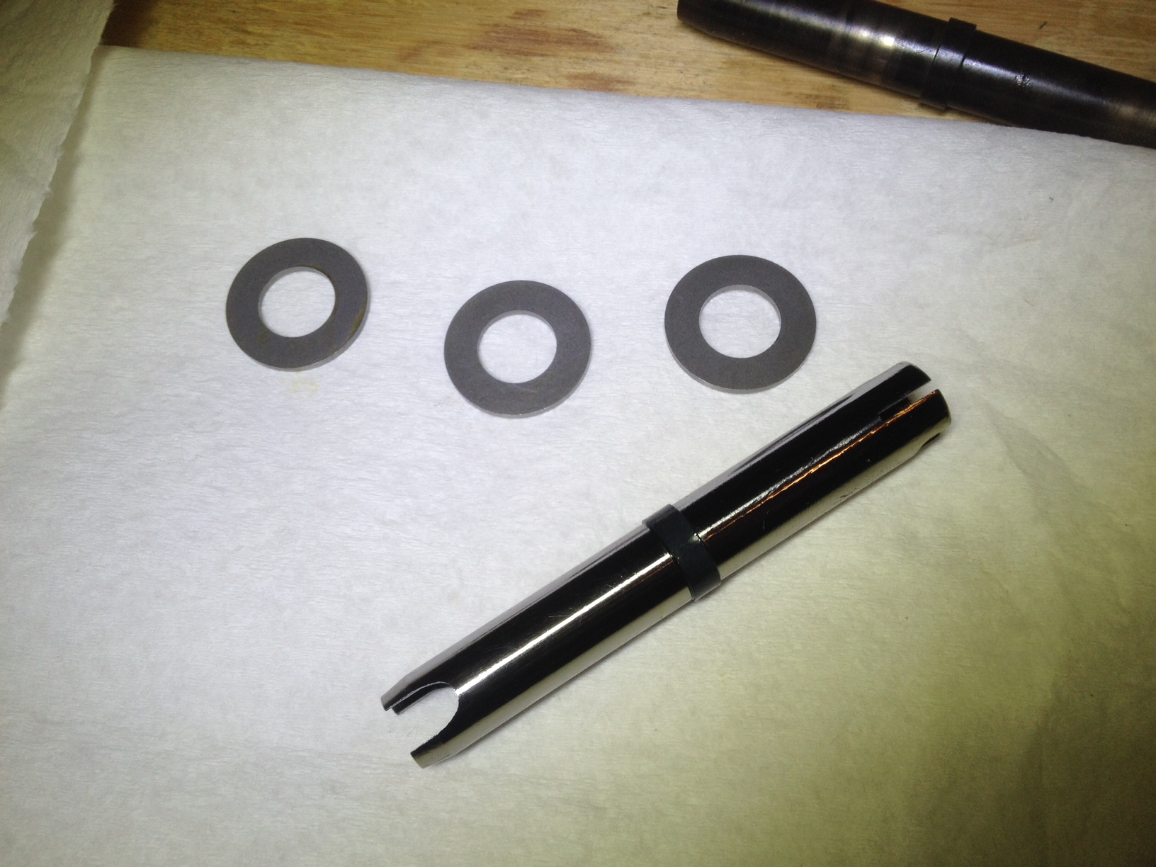

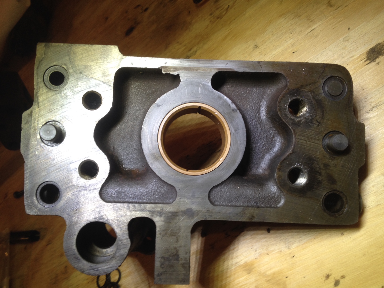

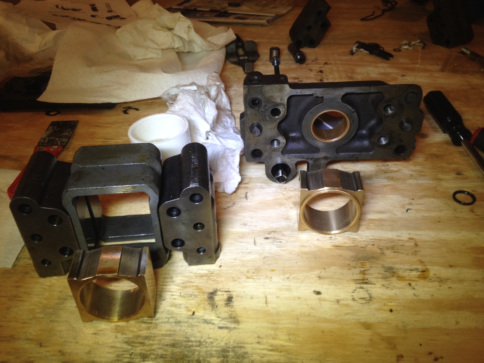

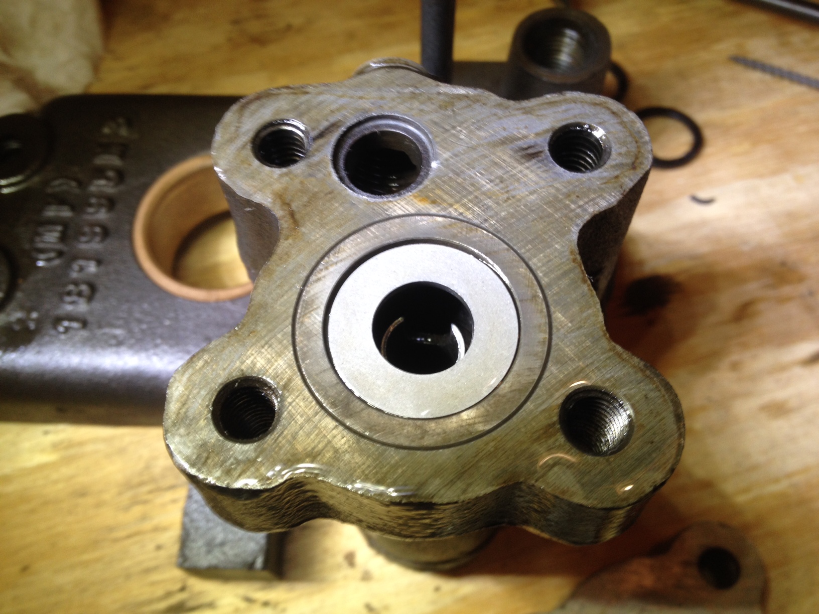

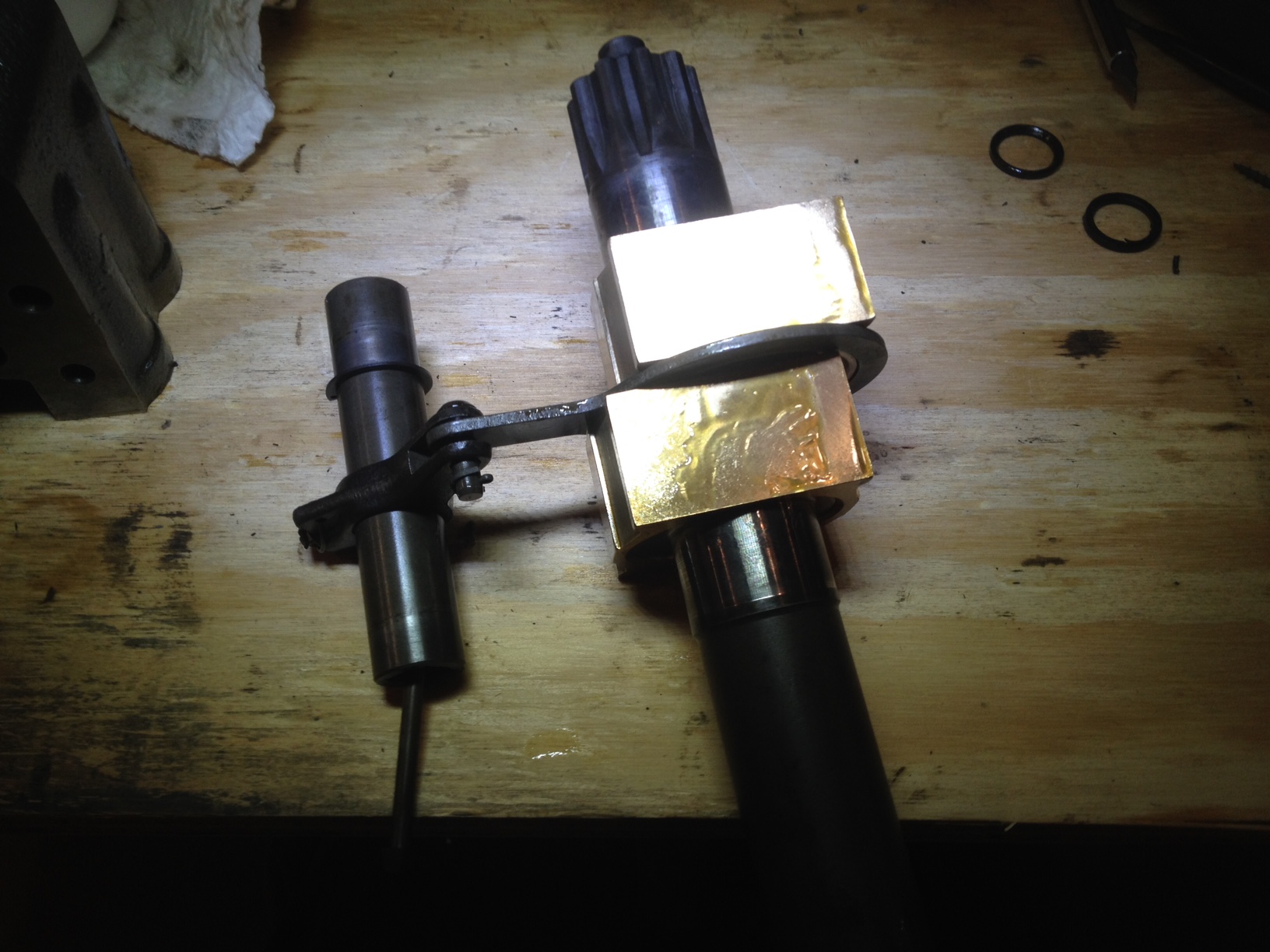

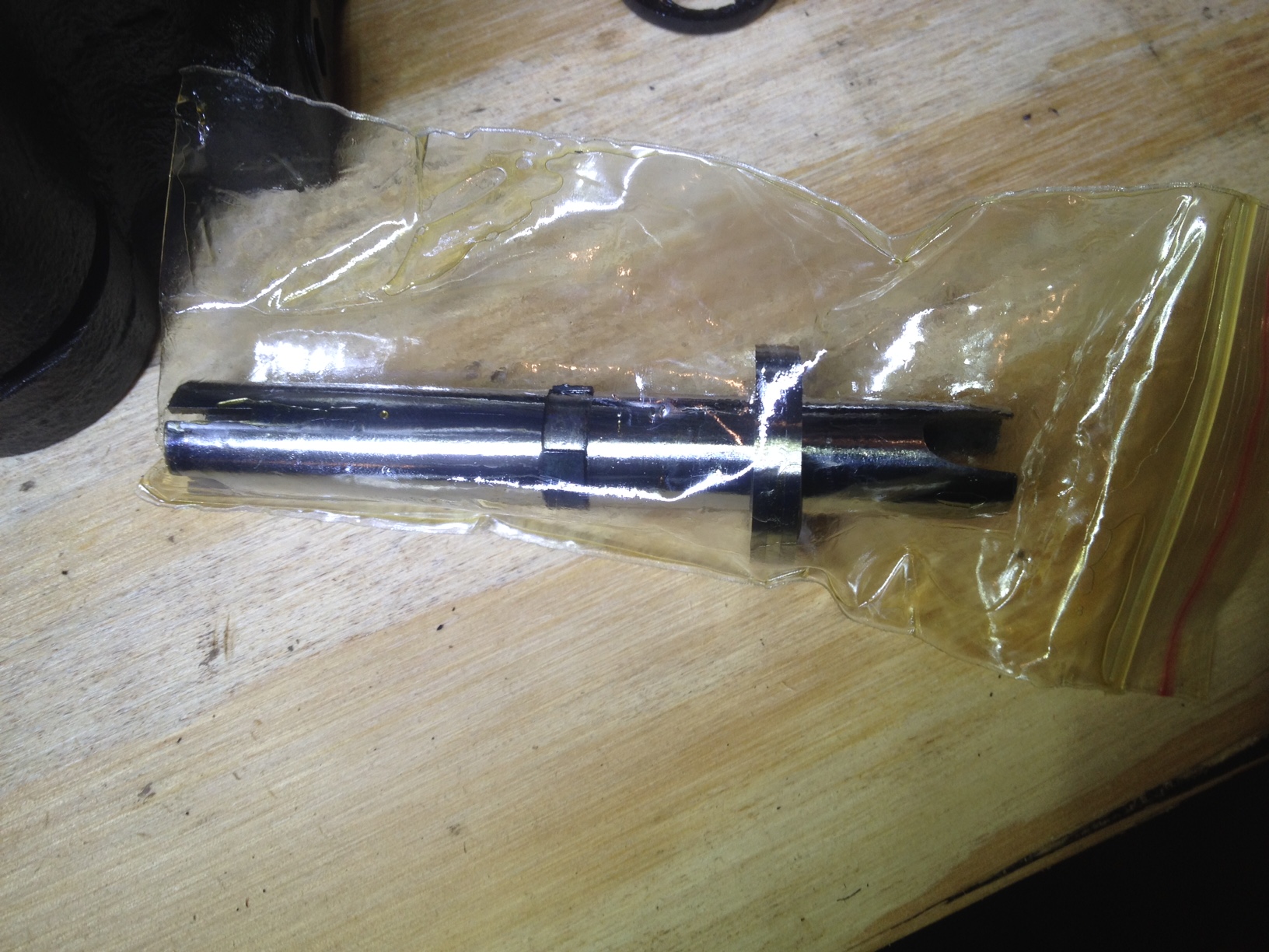

Been awhile since my last update, life gets busy! Here we go:
I finally got the hydraulic pump put back together with new cylinders, pistons, o-rings, brand new control valve assembly, and lots of meticulous cleaning. Torqued the four main bolts down to 55ft. lbs as shown in the repair manual. I'm going to break this up into several posts because I have lots of pictures, as promised. This set shows the pump going back together after cleaning.
1) cleaned out end plate
2 and 3) new control valve
4) control valve fitted into it's orifice
5) pistons and cam blocks as they came out of the rebuild kit, had to take them apart anyway
6) blocks go onto the cam first
