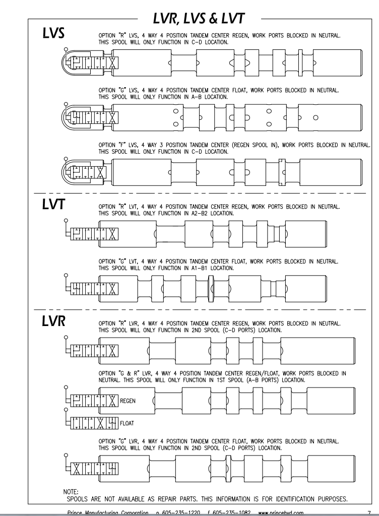

I'm asking not arguing. Doesn't spool require more lands for float than a plain old 2 position valve or can float detent spring be added to any spool valve to add float option?? Why does this state spool with float will only function in a certain location in valve body?
Thanks,Jim

Float is an option, whether it is installed at factory or in the field. It also has to go in a certain bore of the valve.
The float spool does have a different configuration, and you can have float with out detent also.
Once a spool is installed, it is left in place.
You may have to have a special spool for float to work properly, and the detent mechanism is what keeps it in float.
In your above illustration, there are different spools for the valve position, it can be a float spool or not.
Most loader valves will have float and detent.

Thanks for confirming float spool has a different spool from regular valve.
Jim

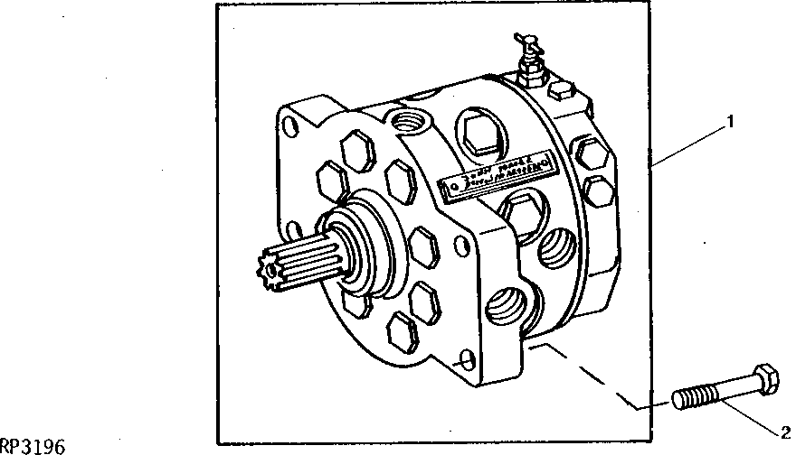

If our tractor has a closed system, the relief is by the pump.
There is no relief valve by the pump on a JD440C. There is a stroke control valve in the pump that controls whether pump actually pumps oil or doesn't pump oil.

If the relief is not on the valve , where is it.
Just about every hyd system will have a relief valve.

JD ag hyd systems have a priority(pressure control) valve that ensures power steering get the last psi of pump output. Some models such as rowcrops have brakes included but utility tractors aren't included. Other than that priority valve the only other valve with relief valve(thermal relief) is the rockshaft control valve. Scv's & FEL valves don't require a relief valve because if stroke control valve in frt pump is functioning properly hyd psi will not exceed stand-by pressure. As I've previously stated my experience is with ag tractors and industrial tractors are a little different and some ind backhoe & FEL valves could have relief valves. I'm confident there isn't a relief valve close to frt hyd pump on a 440C.
