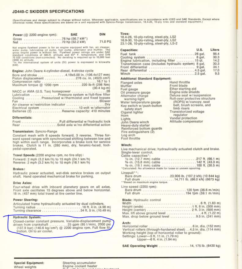

According to hyd spec's I located the stand-by pressure is listed at 2000 psi. Ag & forestry use same frt hyd pump( AR56160) as hyd pump for 440C also fits some ag model tractors. I think as long as stand-by pressure is within spec's you'll be fine. I just looked at factory valves and some of the individual sections do have relief valves.
BUT I'll reiterate that my industrial equipment knowledge is limited but not my closed-center knowledge.
