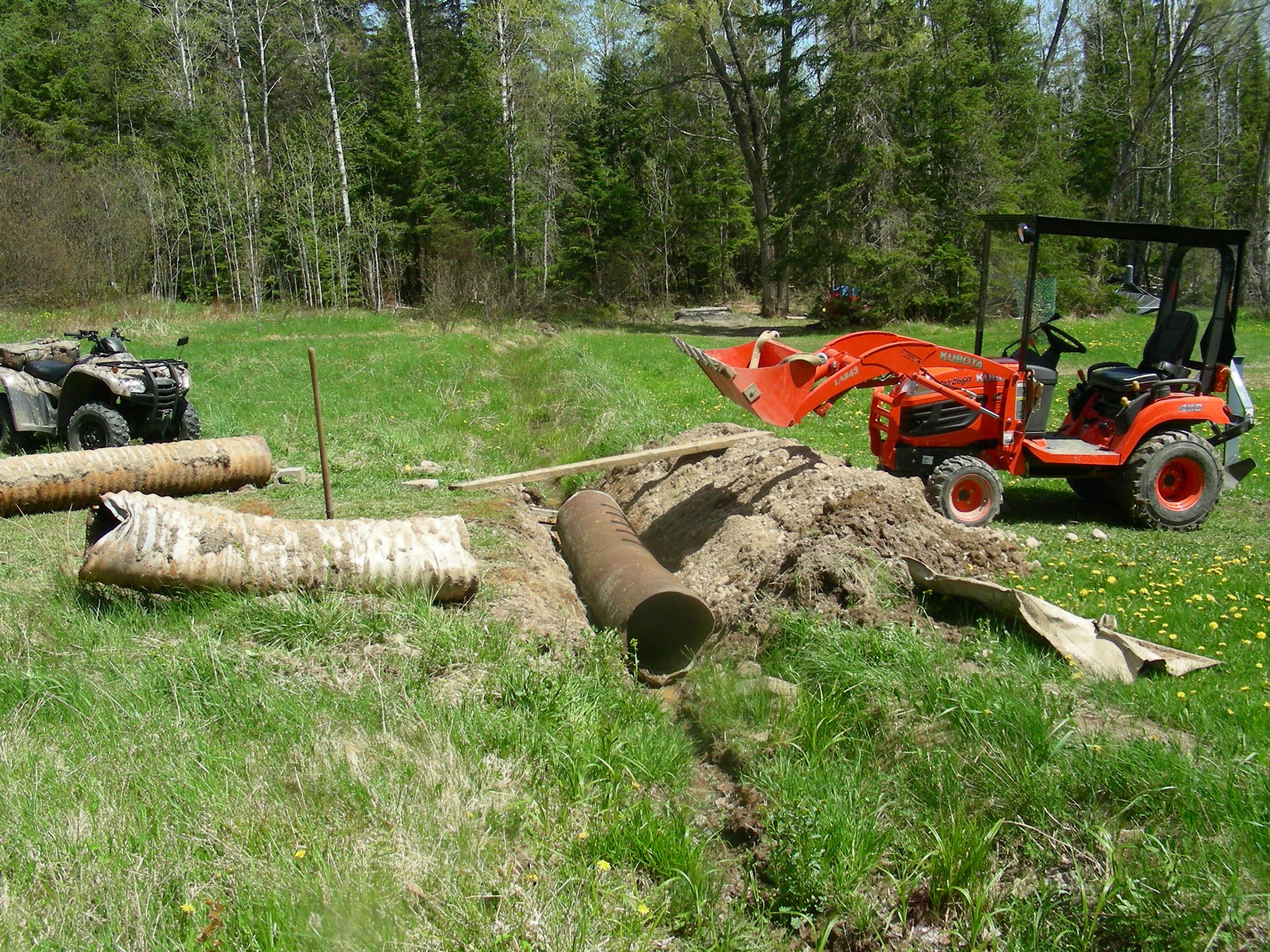

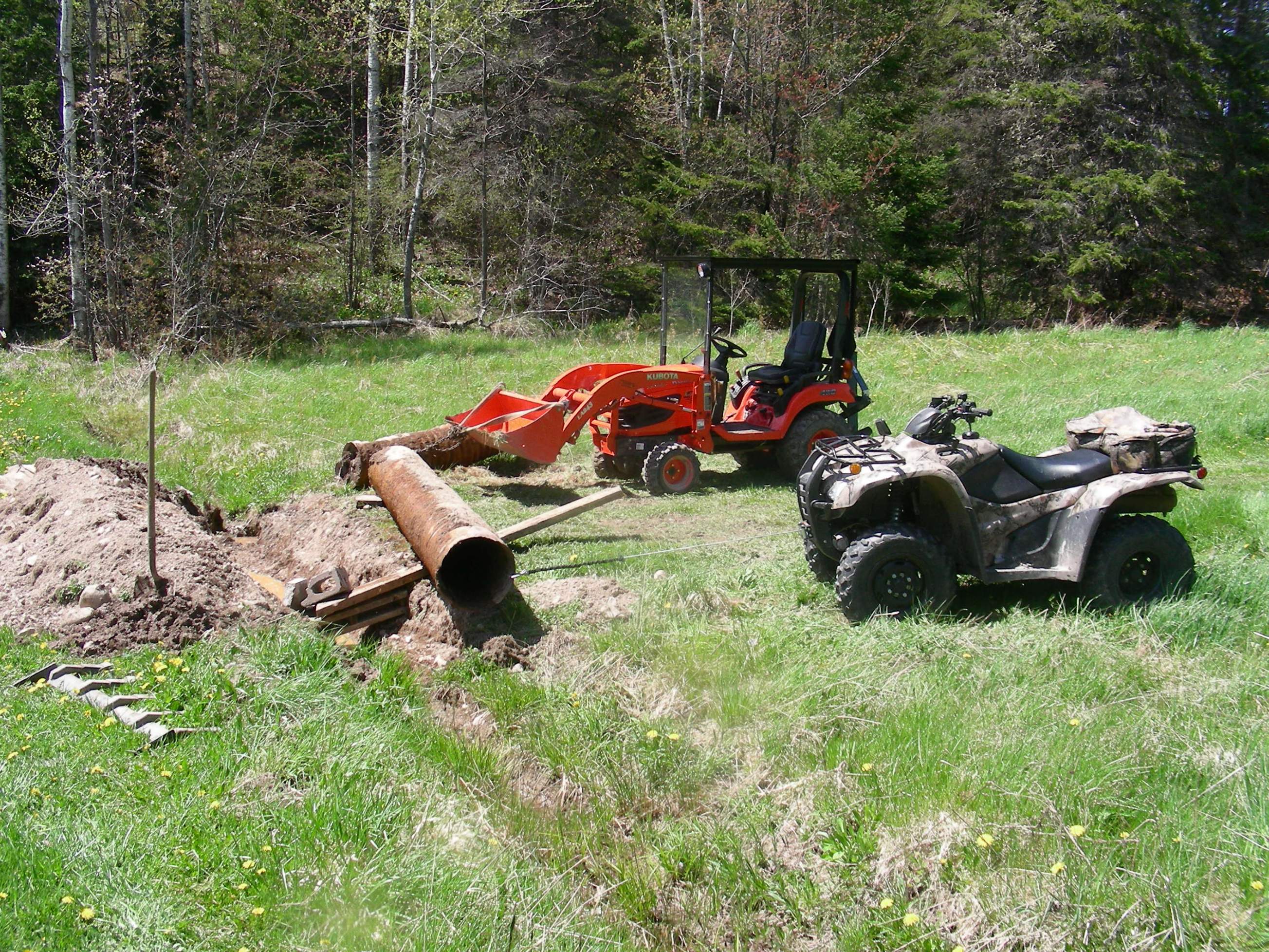

just some culvert fun I had a few years ago , the toothbar was a great help and to make it a one man job I needed the ATV as an anchor point pulling the clay filled culvert out
