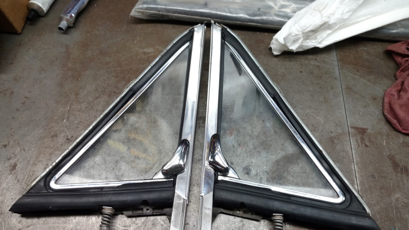

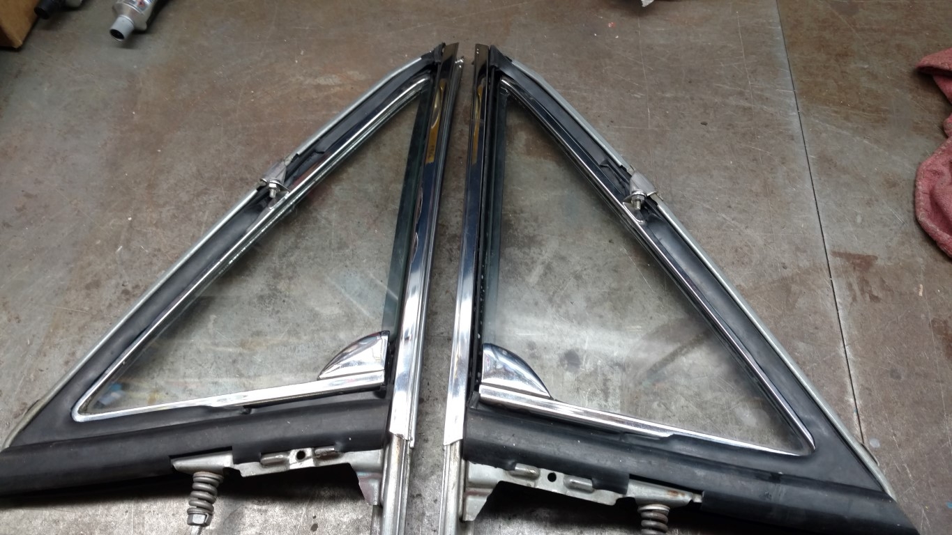

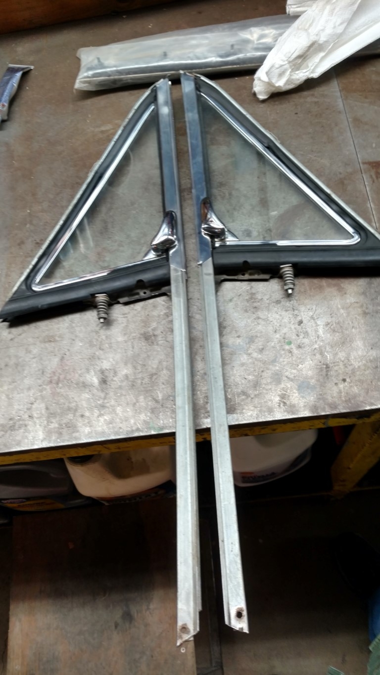

So, I have been working on the vent window assemblies, getting the new seals installed, mounting the windows in the frames, assembling the friction washers in the correct order, and installing the stainless trim on the inside and outside of the vertical tracks.
As usual, tracking down the parts takes 10 times as long, or more, as it does to install the parts. This was the case of the stainless trim pieces. After searching through every likely storage box, I finally found them wrapped in paper towels secured with rubber bands. I unwrapped them and got the ones for the passenger side installed, and the onside piece for the drivers side installed too. But, I couldn't find the one for the outside of the driver's side. Back to searching through boxes and anywhere I might have stashed it. Another search for the channel the door glass slides in came up empty too. Apparently I never ordered those, so I ordered those this evening from ChevIIOnly, should have them in a couple of days, then I can get the door glass in and get the doors fully assembled.
Once I get them done, I'll pull them off and roll the body upside down and get to work on the headliner.
It might end up taking me two years to get this thing back together, you never know.

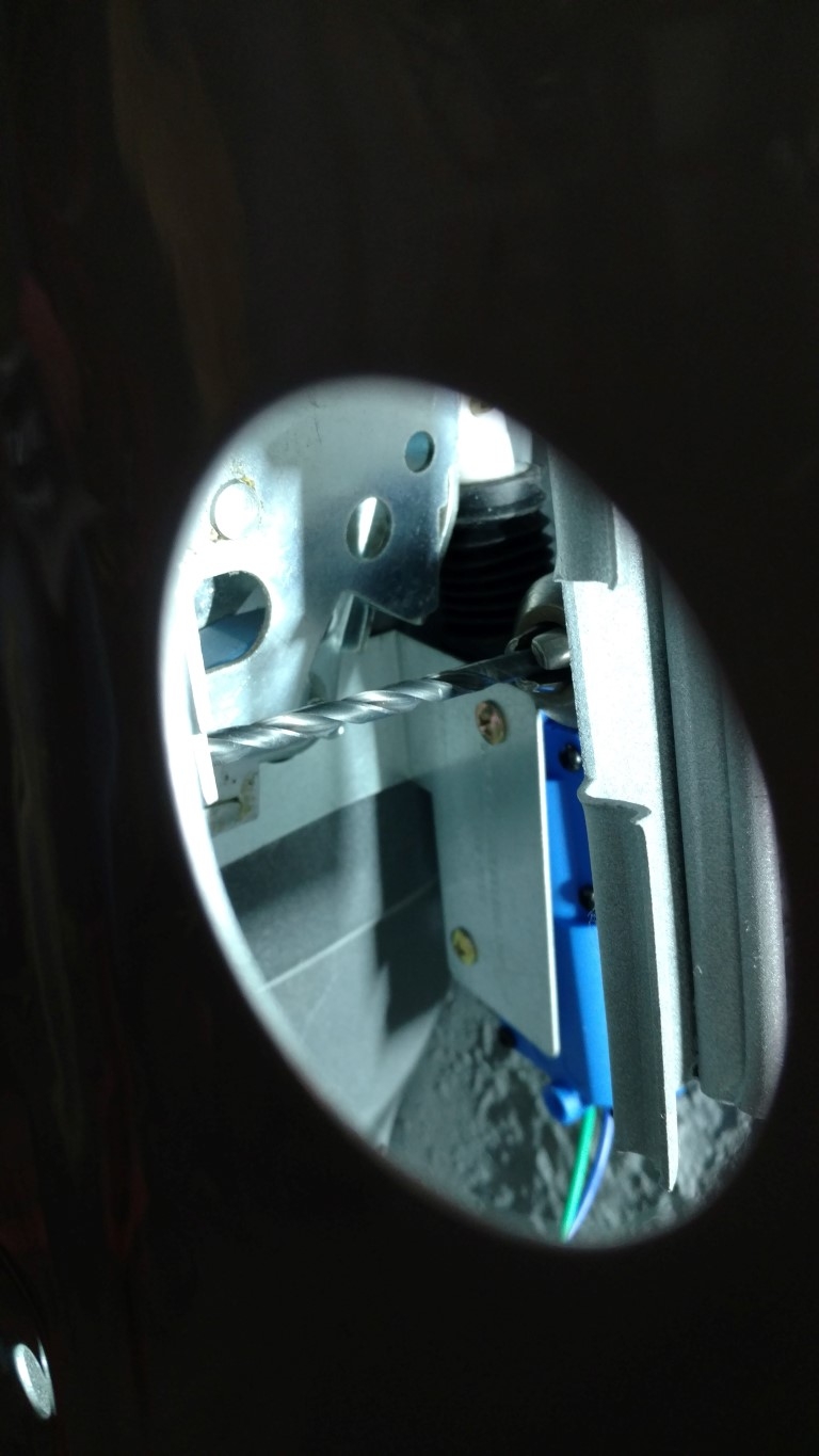

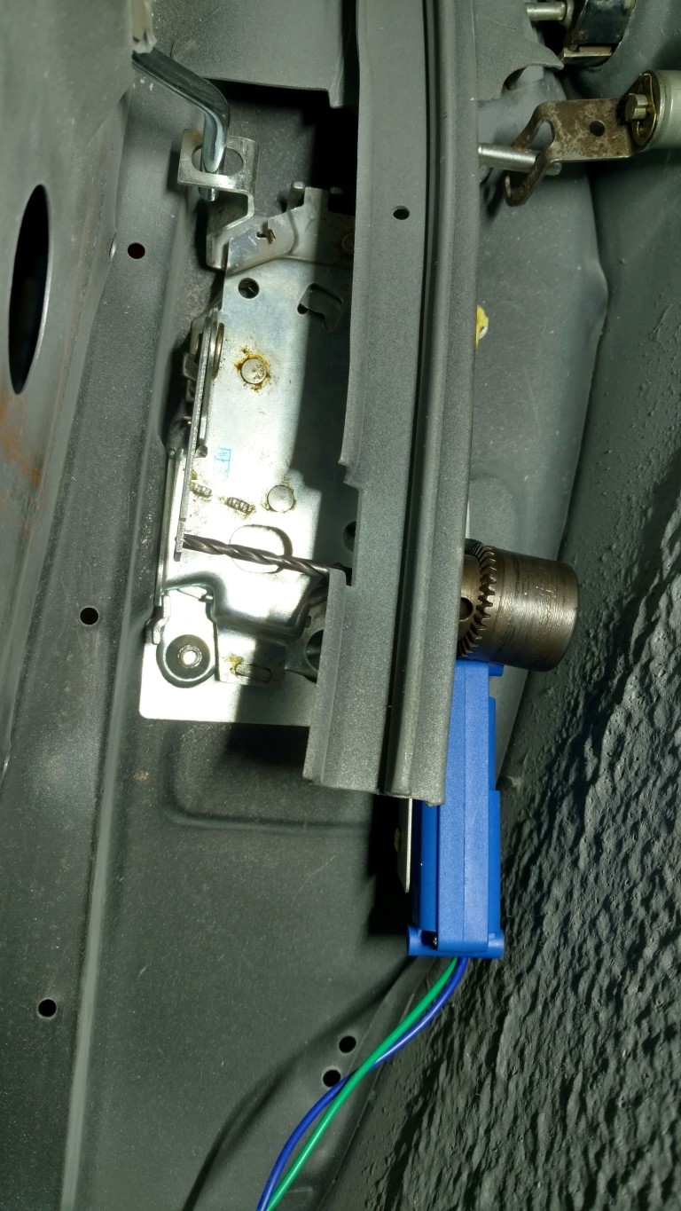

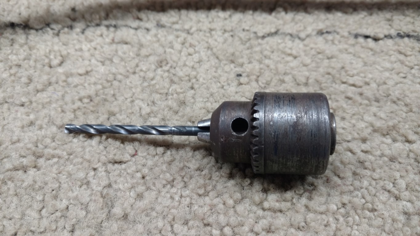

Still working on getting the doors reassembled, and it's not going smoothly, but it is going.
I have both vent window assemblies in the doors, after some head scratching as to why the rubber seal at the bottom had notches cut in it where it laid on the outside of the door. Well, the seal goes inside, and the notches clear the vent window friction assembly.
As I am still waiting on the runs that the windows slide up and down in, I decided to put the inside door latch assemblies in, as they really won't be in the way to install the glass. found all the parts after only a 15 minute hunting expedition. Got everything cleaned up, put the actuator and rod in, but the rod wouldn't go in the hole in the arm on the latch. Pulled out one of the old ones, and the rod fit fine, and discovered there is a clip that holds the rod in the arm that was still on both old latches. Got them off, then cogitated on how the enlarge the hole without taking the latch assemblies out (again, don't ask). After some measuring, I discovered the required hole is the size of a #19 letter drill, but how was I going to get a drill in there to drill it out?
I have and old 1/4" drill chuck with a 3/8" bolt shank that I have used as an extension to get into deep places, so I took the bolt shank off, chucked the bit in it and was able to get it in and turn it by hand to ream out the holes. Put the retainer clips on and the rods snapped into place. Now everything on the door latches works as it should.
Now it I can just get the window runs so I can get the glass installed in the doors. I think I have everything I need to install the quarter windows. If I remember right, those were SOBs to get apart, so I doubt they'll go back together really easy. New adventures await those who decide to completely dismantle a car and then put it back together 10 years later.
