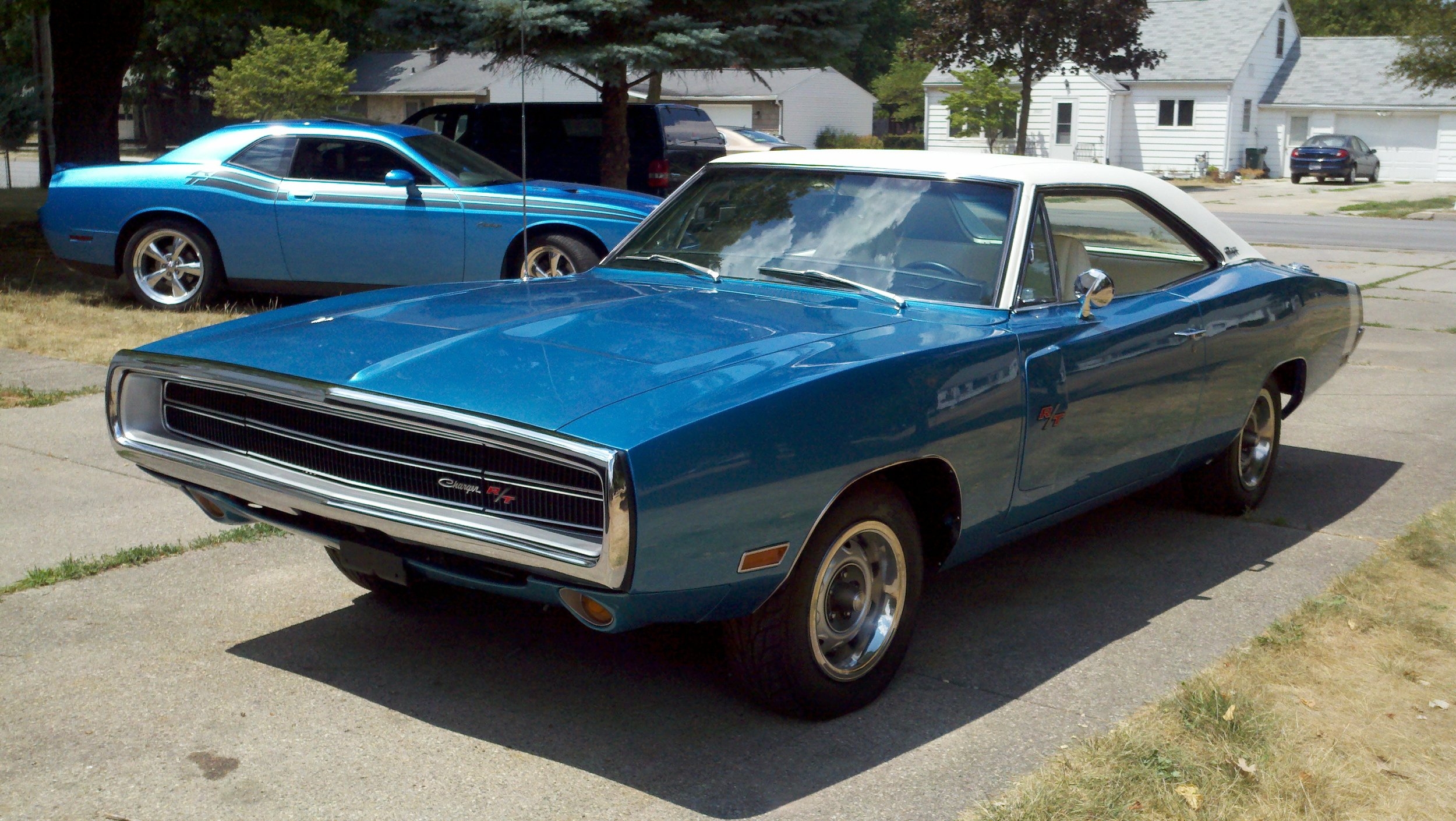

My friend Brian has a 2010 Challenger too, in B5 blue with the 5.7 Hemi and six speed Tremec. Cool, fast car. Also has a 70 Charger R/T 440 with FI-TECH EFI and a 4L60E that I installed for him.

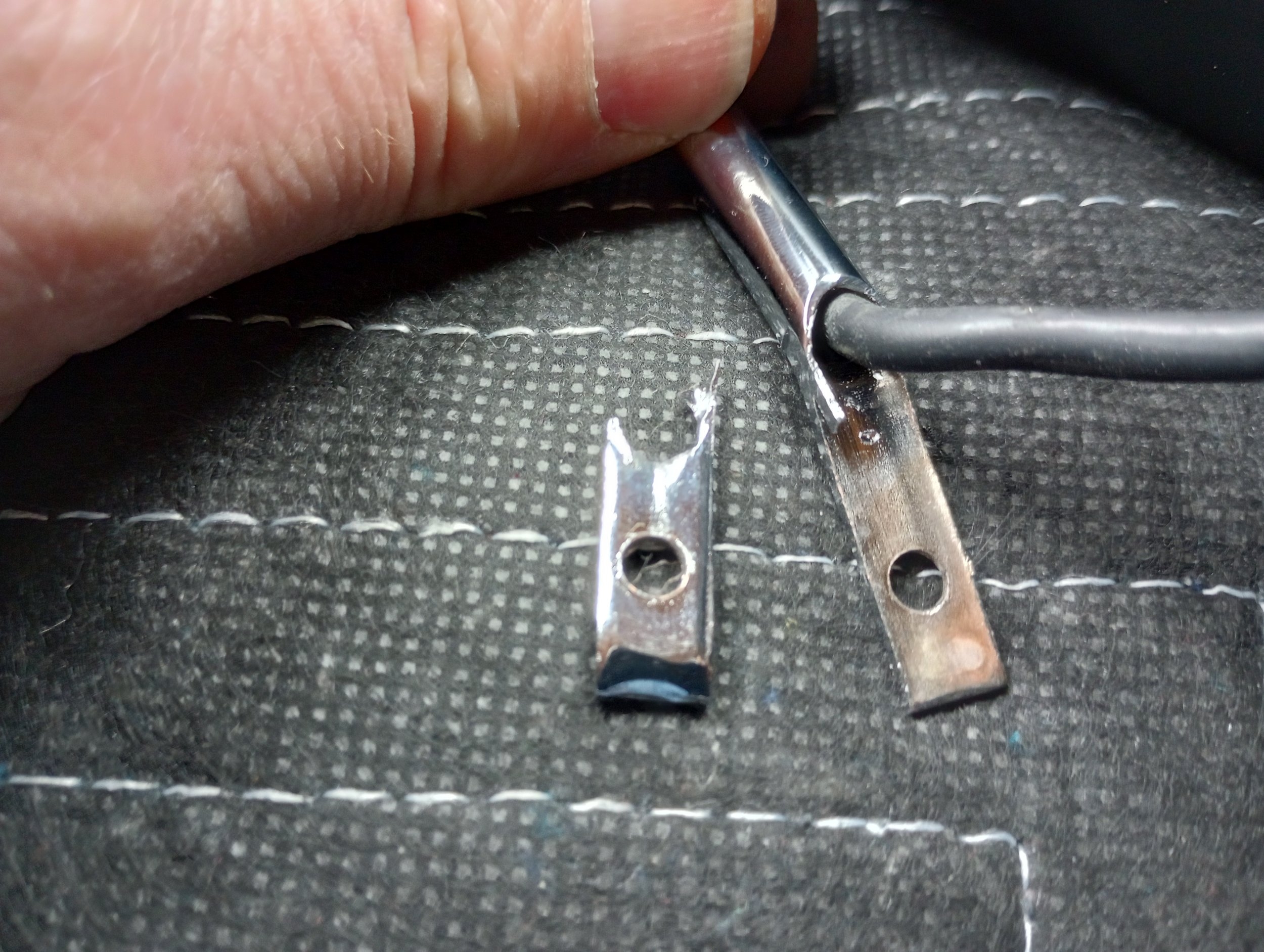

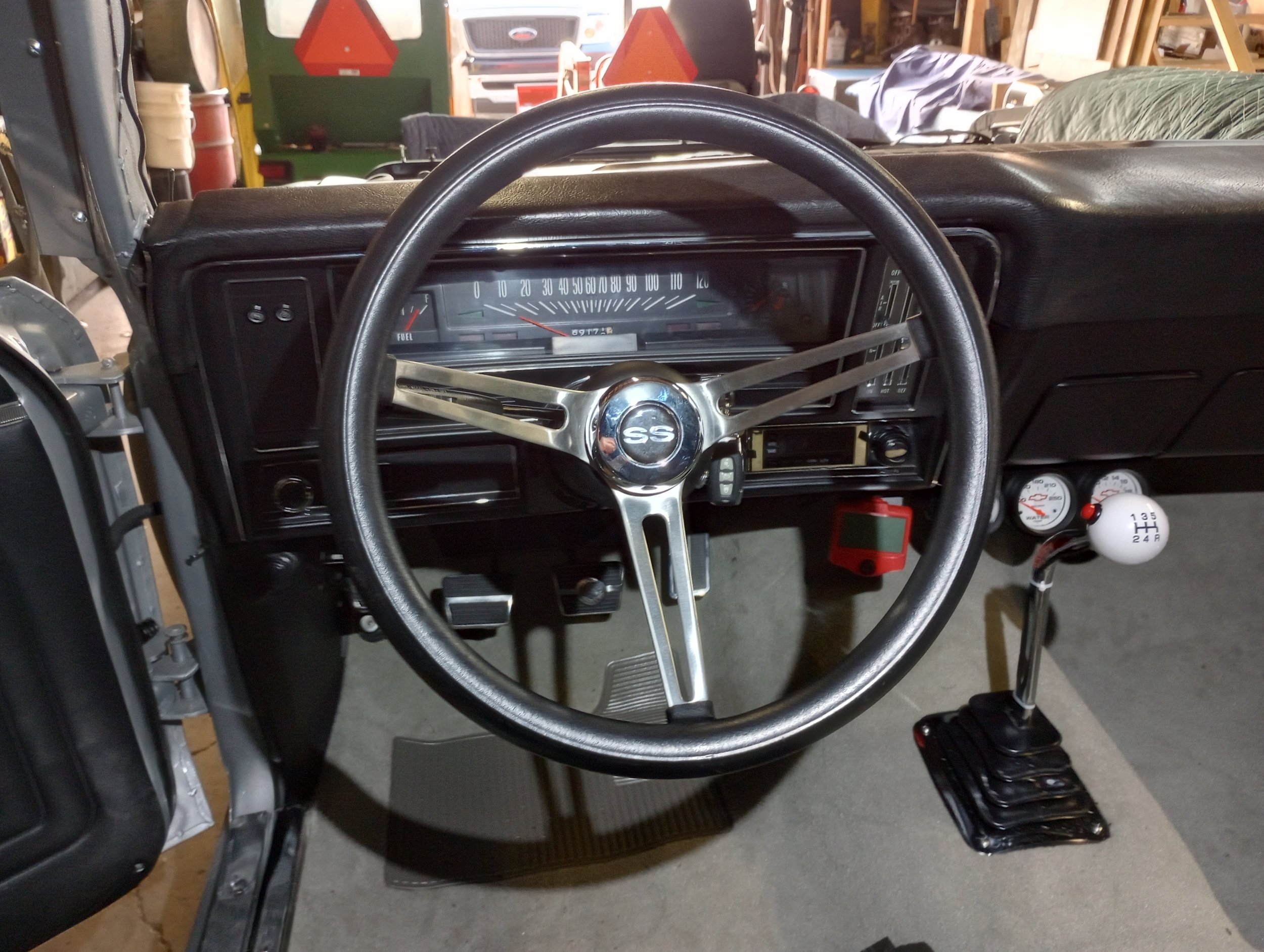

I got the steering column back in the car and buttoned up today, but not without a couple of challenges. Brian got it painted for me and dropped it and the front bumper brackets off on Saturday. I started putting it back together and discovered that you have to leave the turn signal switch out so you can install the ignition key tumbler. Then when I went to install the turn signal lever with the cruise control controls on it, I discovered it was broken where it screws fast to the cancel cam. The lever is a tube that has the 4 conductor cable running through it exiting through a slot cut in the tube, and is then flattened out and a hole for the screw drilled in it. They also ground the sides of the flattened part down so it would fit in the slot in the cancel cam, which turned it into two tabs, one with the slot in it, with practically no metal on each side of the slot, so it broke off. I pondered WTF to do with it, so I smoothed out the sharp edges and made a little C channel out of some .030" aluminum, which holds the remaining tab in place and supports it better. Seems to be solid enough to work for now. I fired off an email to Dakota Digital with pictures, describing what the problem is. I'll see what they have to day.
I got the column back in, with a towel wrapped around it to protect it from any more damage this time, but it took a bit of finagling to get it just right on the steering box shaft to get the retaining bolt lined up with the slot in the shaft. Hooked up the turn signal and ignition harnesses and got it bolted up the the dash. The thin foam gasket that seals the two piece plate that covers the hole in the firewall was torn, so I made a new one up and got it and the plate installed along with the plastic cover that mounts below it. I got the steering wheel installed, but it wasn't clocked right, so I pulled it off this afternoon and reinstalled it where I think it should be really close to correct.

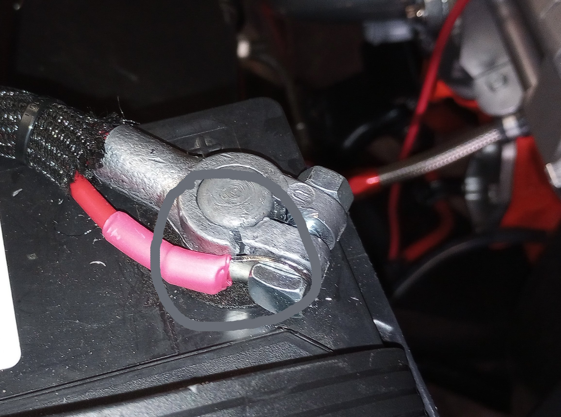

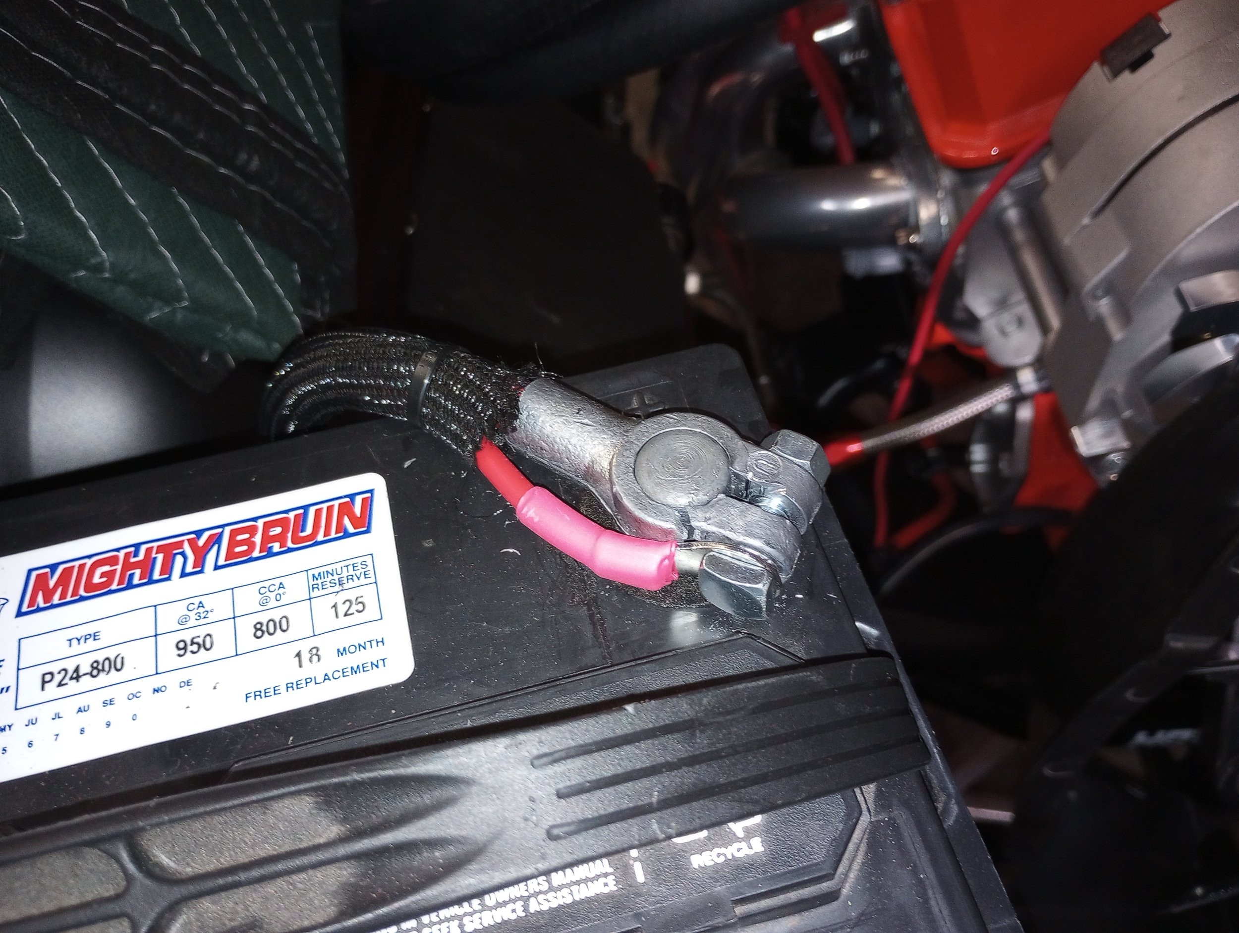

Next, made up an 8ga. wire to run from the alternator to the positive battery post. That entailed going to three auto stores and not being able to find and ring terminals for 8ga. with to a 5/16" hole. I ended up buying a few for 6ga. wire and trimming the part that crimps on the wire so it would crimp and hold the 8ga. wire properly. Got it run and connected, so It'll keep the battery charged.

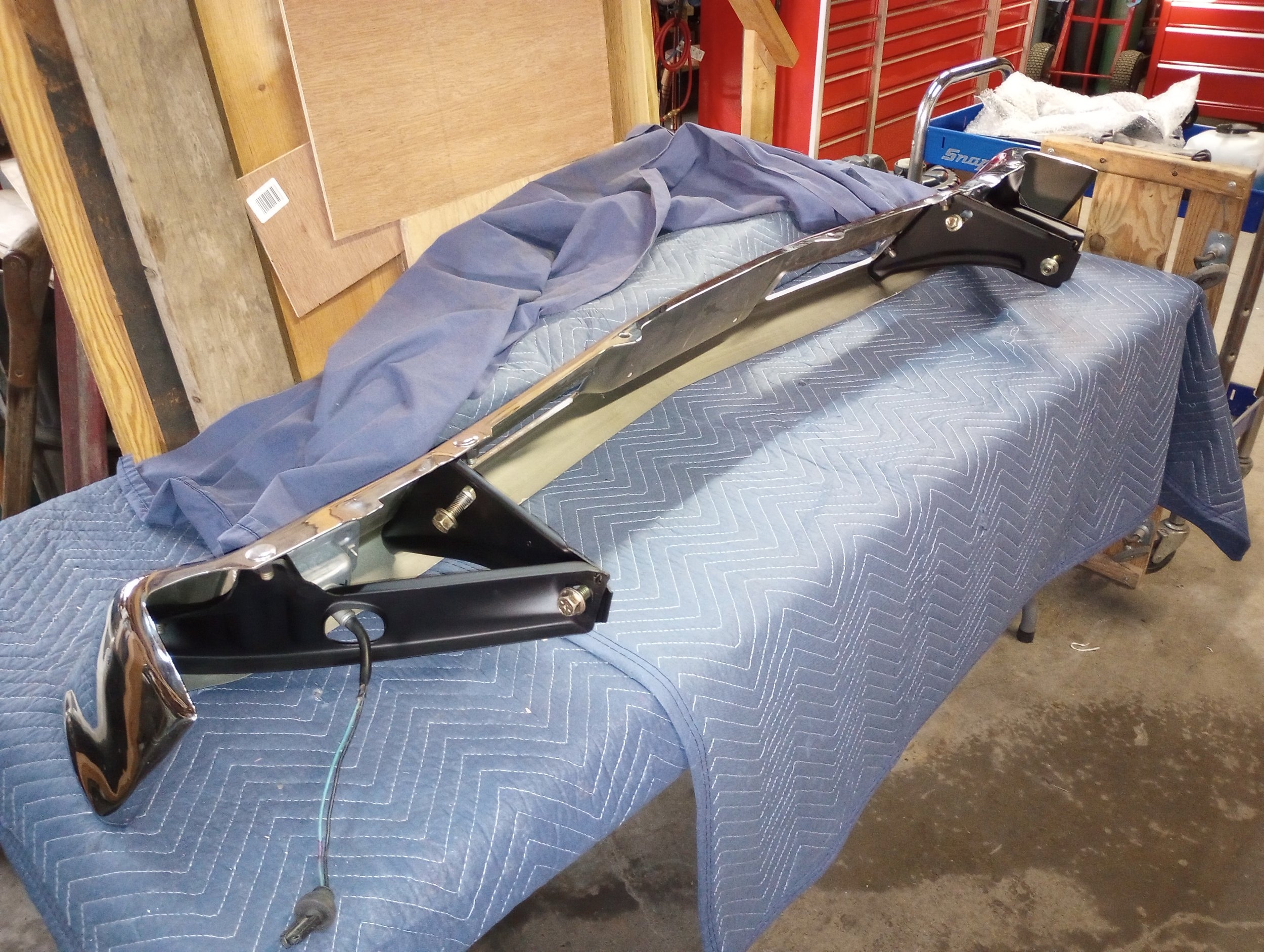

Last thing this afternoon, I bolted the painted brackets to the front bumper, so it's ready to install once I get the left front fender installed.

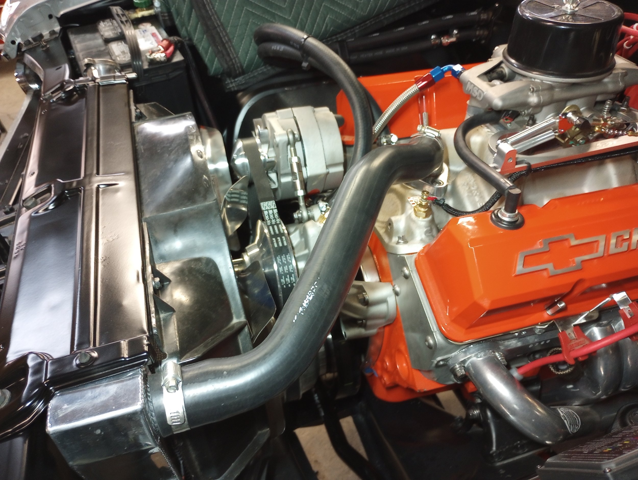

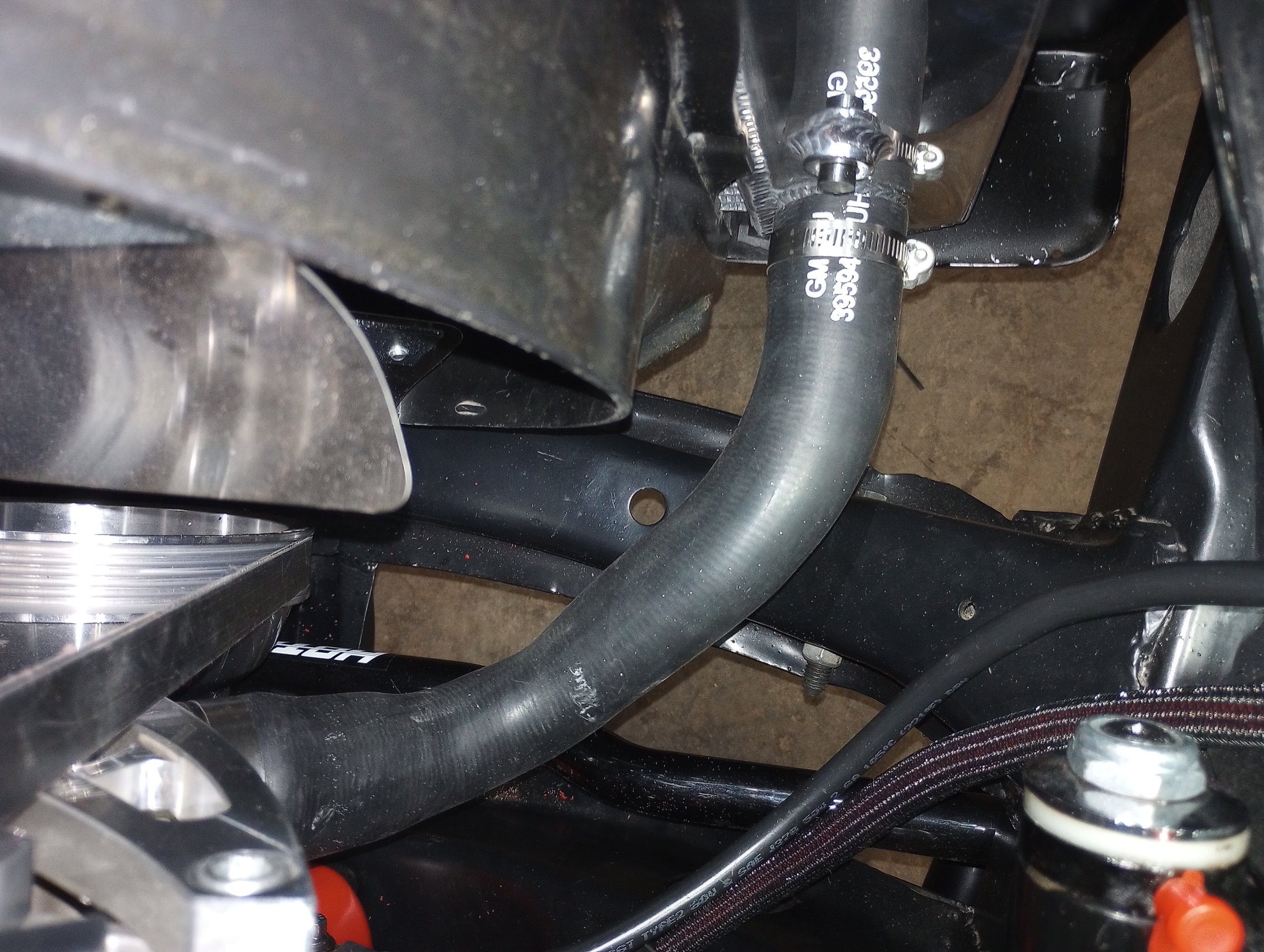

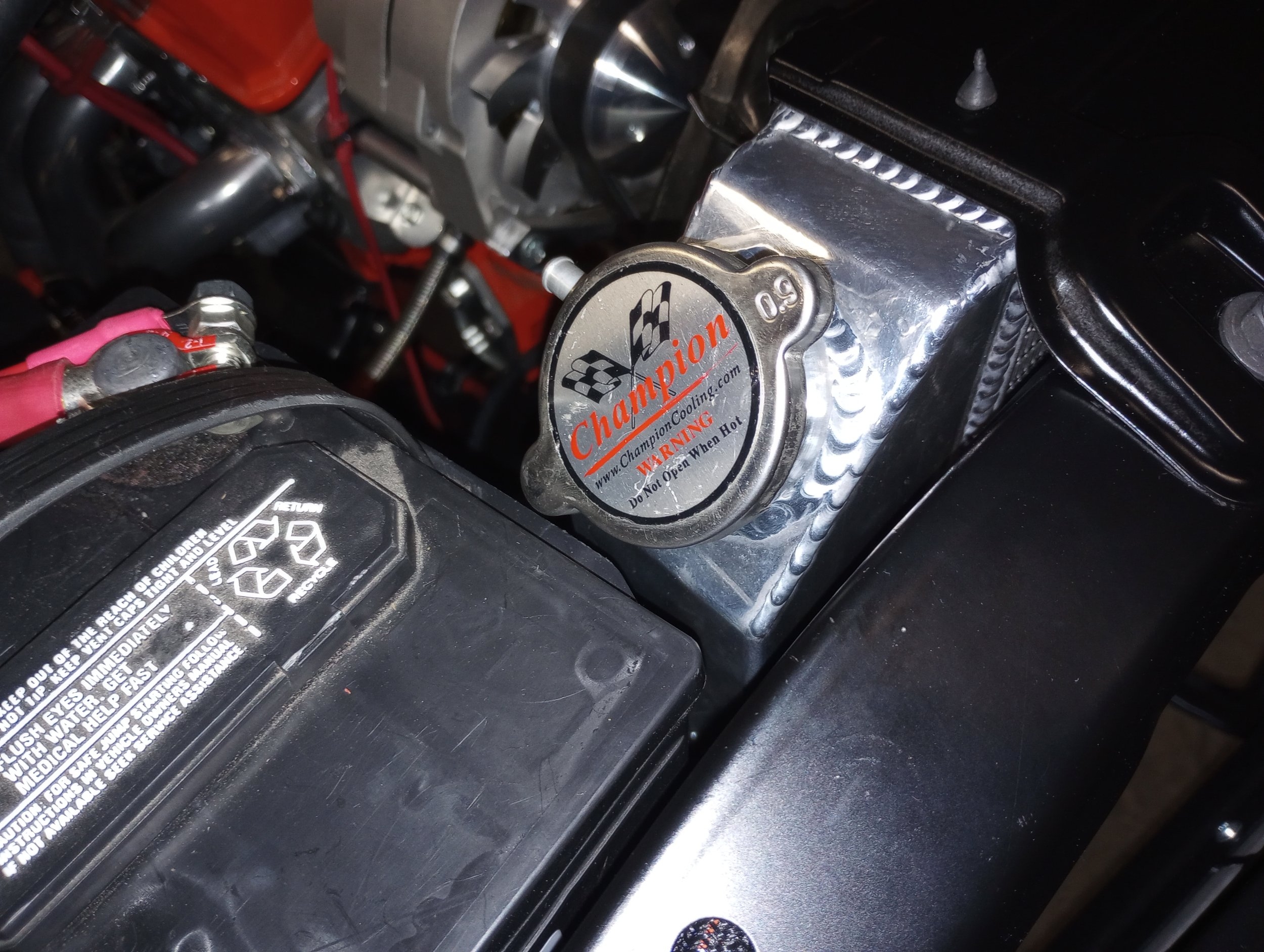

I'm getting close to starting it up. Today, I painted the front of the radiator core with Eastwood radiator paint, so you can't see the aluminum core from the front, got it set in place, the top plate bolted down on it, put the fan shroud in place, bolted up, got the new radiator hoses trimmed to length and installed. The cap is really close to the battery, and with it slid to the outside as far as it will go in the tray, you can just get the cap off. Tomorrow, I'm going to pull the battery and see if I can slot the mounting holes maybe 1/4" to 1/2" to move it over and give the cap a little more room. I can't go much more, or the negative terminal will hit the fender. I am also considering putting in an overflow reservoir, but not sure where I can install it. It would have been easy if the filler neck was on the driver's side, but it isn't so I'll see if I can come up with a mounting spot for it.
I was looking at the pictures I posted yesterday, and noticed something I missed when I installed the alternator wire onto the positive cable clamp. The cable clamp broke! So, today pulled the cable off the battery, cut the clamp off and crimped on a new one. It's a good quality solid copper clamp, so it's a better terminal than the lead one that broke.
I got an email back from tech support at Dakota Digital today, and he asked if I would send him the pictures of the broken turn signal handle. I sent them over to him and this evening he sent an email back that he had never seen one break like than and that he was sending me out a new one. That's great, but it means I'd have to take the steering column apart, again. :(
I might leave the broken one in as long as it works and change it next winter, as I'm sure there will be other items that will need to be addressed, as there always are with a project as extensive as this.

Got it fired up for the first time in almost 2 years. It started immediately, on the first revolution, I think. Love the EFI for cold starts.
Only had one water leak, I forgot to tighten the clamps on the heater shutoff valve.
Holds good oil pressure, doesn't make any strange noises, and water temp came up to 170°F, although the EFI controller shows the temp going up to 240°F before the thermostat opened. Not sure about why that sending unit is reading so high, though that sensor is at the rear of the passenger side head, and the gauge in the car has it's sensor next to the thermostat. The six blade flex fan I put on it moves a LOT of air, just standing in front of the grille, you can fell the air being pulled in.
I let it run for about 20 minutes at 1800-2000 rpm, so the cam should be happy, and there is virtually no blowby, so the rings appear to be seated. A look around underneath didn't show any oil leaks.
