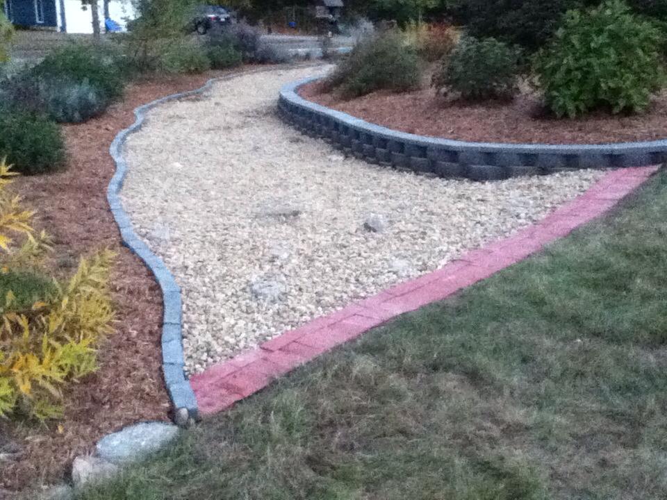

Man i wish I could remember the spec's of my retaining wall.
I wanna say it was 88,000 lbs of blocks. Cost $5500.
Gotta be at least a couple hundred linear feat. 5 layers tall, so 2.5 feet.
The site where I used to have pics of the project is gone. But the moral of the story is that retaining wall blocks are your most permanent solution.
The type I used has a lip on the back that hooks on the row below. So the lip either has to break off or the block has to lift up to move. I mention because some only rely on adhesive. Kinda/sorta like this one (shown upside down, as far as I can tell): http://tinyurl.com/l2xsz54

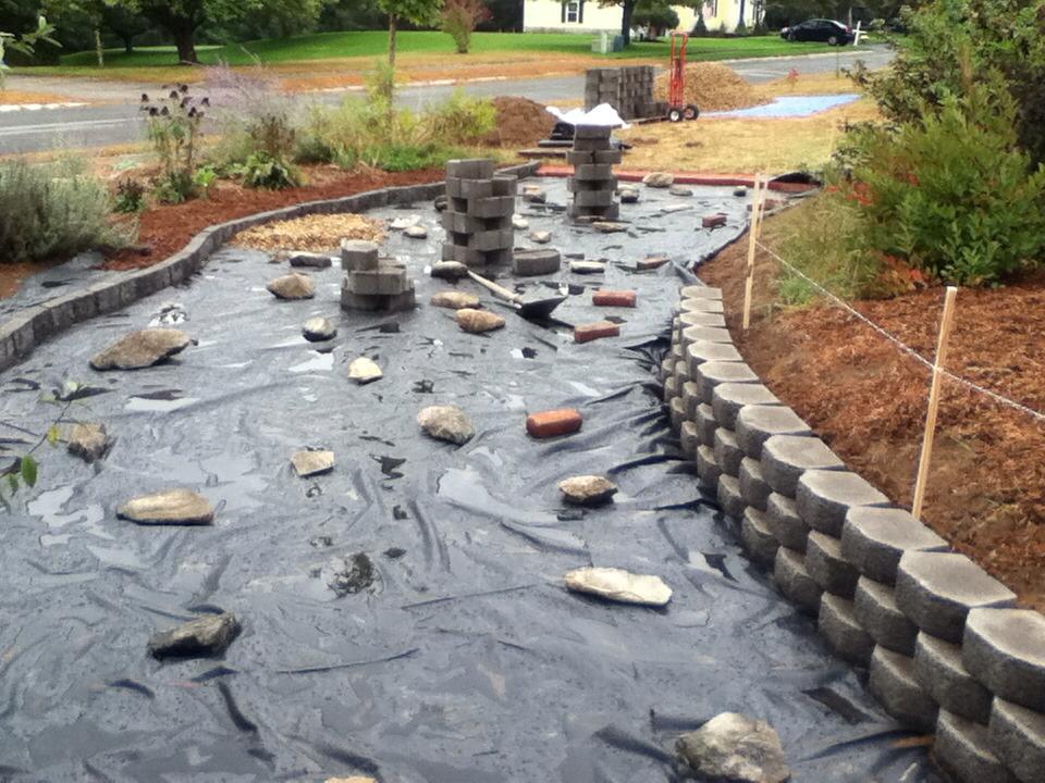

Once you get your base set, stacking the blocks goes very fast, and I think makes a better looking wall than timber. The lip on the back makes it easy. I had the pallets dropped off, then moved into the work area in stacks with a hand truck, so I wasn't running back and forth carrying stones.
So many of the timber walls I see are partially rotted, leaning, etc. Heck, even the one the wife built around the mailbox flowerbed has issues.
As an option, you can stack a layer of 8x16 pavers on the top row, held down with masonry adhesive. I trimmed the ends on an angle with an angle grinder and masonry cutoff wheels to follow the curve...if your runs are mostly straight or have gentler curves you might not even need to do that.
The stakes and lines were used with a line level to figure out my base depths. Fortunately, my soil is sandy gravel and well drained, so I just set on undisturbed soil. If I was on loam or clay, I would have done a proper gravel footing.
