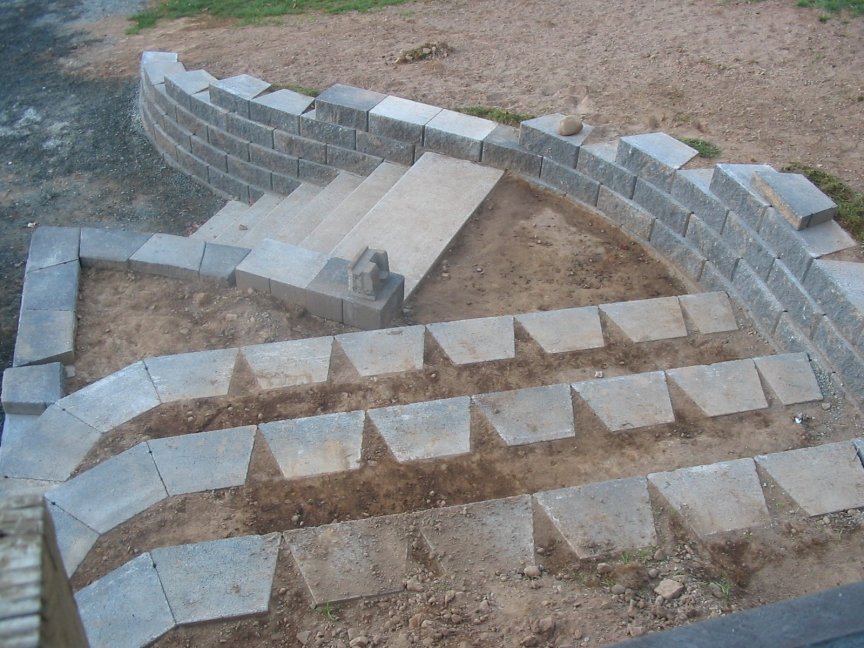

Fell on this thread, I spen the day installing steps (7, I think I'll add one more, the picture is at 5 or 6) in my retaining wall.
The wall is between 4.5 and 3 foot, I used 4 inch block (cheap and available at HD) for the wall and 8 inch step blocks (100lbs each) for the steps.
I used geogrid half way up the call on the 4.5 foot sections, weathered an intense winter without budging, I've got at least 6 inches of crushed stone under and behind everything with landscape fabric behind the crushed stone.
I went through somewhere around 1000 blocks plus.
This was the project where I brought home three pallets of block in my tri-axle, with one pallet being solid block and I ripped the trailer hitch off of my truck trying to back up into the driveway.
I now do a pallet at a time in the bed of my F250.

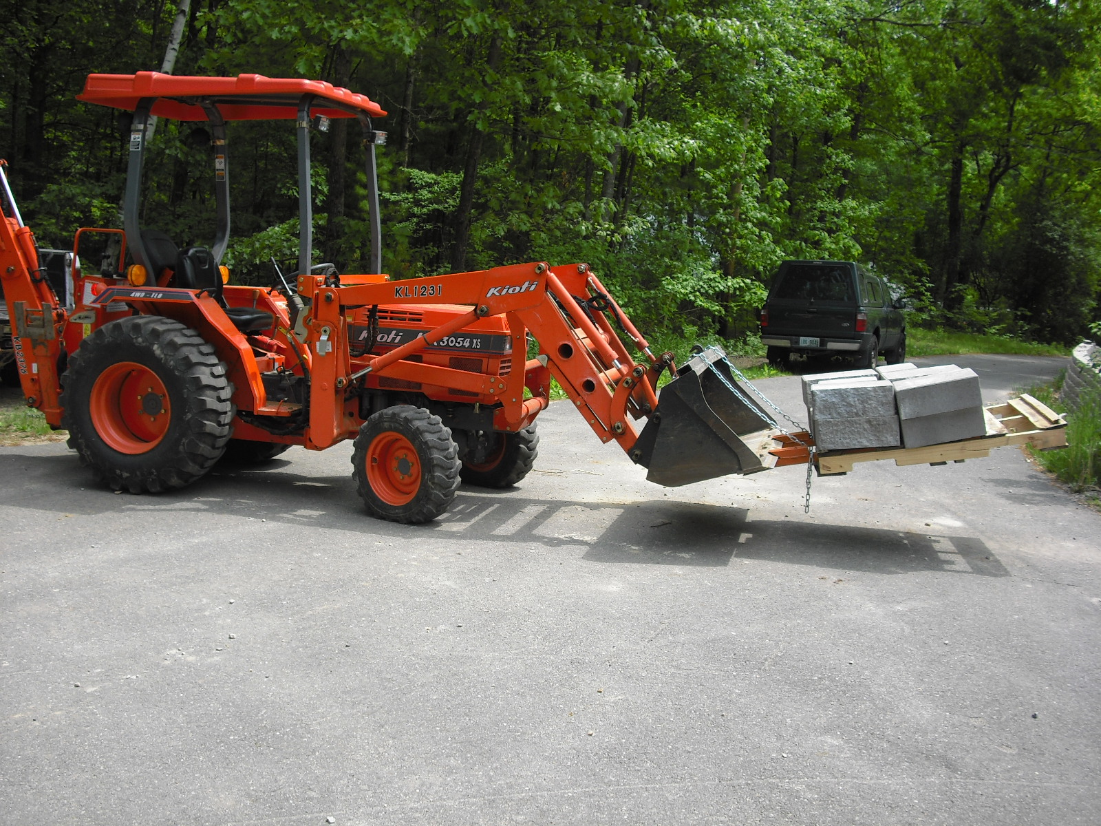

Here's a picture of the steps in progress and my homemade forks with around 1100 lbs on them.
Will be great when this project is done.

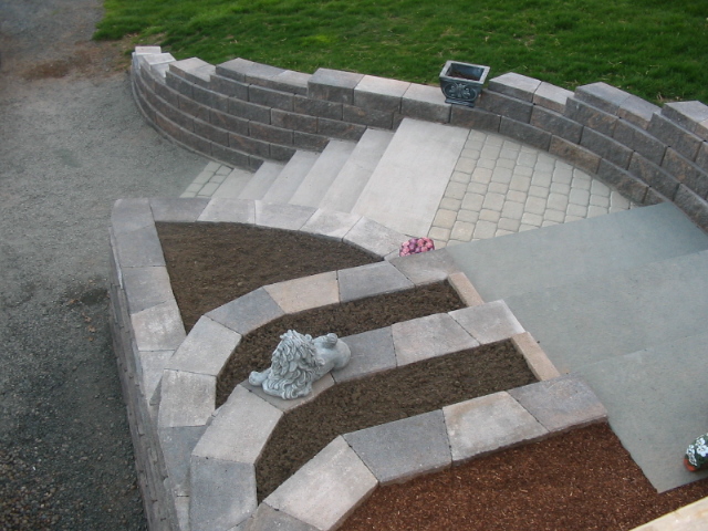

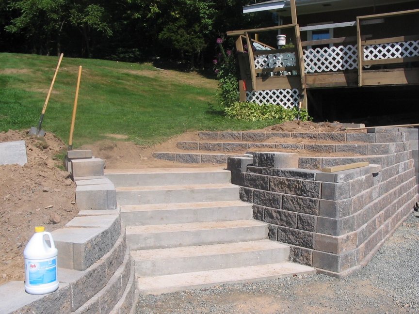

I have to say I cheated on my steps, poured the concrete. I could not get the step blocks as level as I wanted. Found out later I should have poured a level concrete floor for the steps and then stacked the blocks on that. I had blue stone cut to fit for the top 3 steps. A topic like this is good just a little late for me. The "WALL" topic. Between BX Tex and JoelD I am looking more the rookie by each post.:eek:

Gizmo, you've got it nailed, mine looks amaturish compared.
I thought about pouring, bit I think in the long run, with enough crushed stone it was just easier using the block.
You did an amazing job at laying your work out.
Really looks nice, there is no comparison to what was there originally.
Congratulations on a job your future generations will continue to get enjoyment from.
Joel

JoelD, make sure you post pictures of the finished project. I've got two pallets of step blocks sitting here collecting dust and I would have much rather had the steps you and BX have. I also wanted to have blue stone where I have the cobblestone but the guy wanted $600.00 for the custom cut triangular piece and that was over budget.

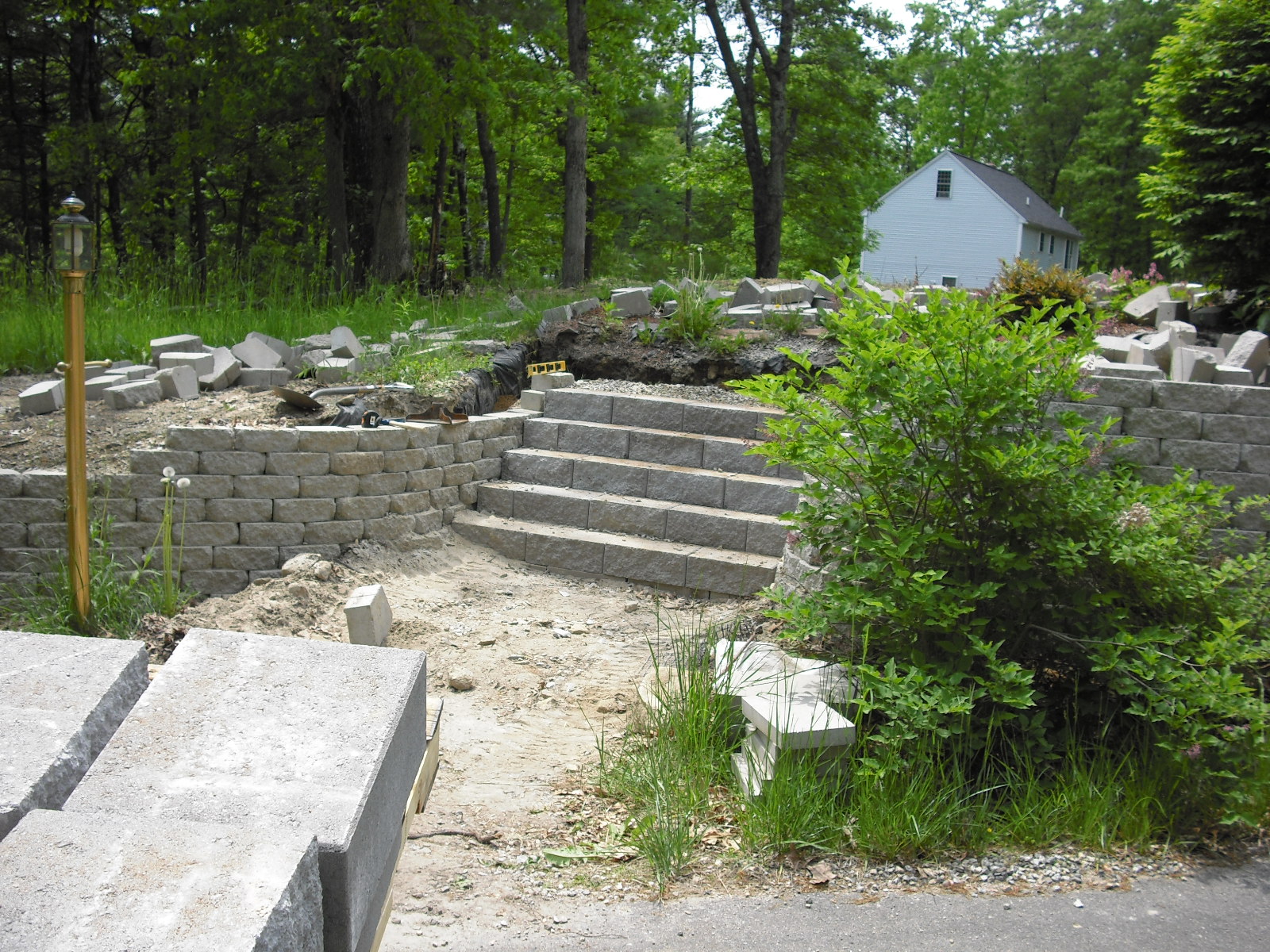

JoelD and Gizmo2,
It took me almost as long to build my steps as it did for the straight run on the walls. Might have been better if I'd used a block specifically for steps, but doubt that it would have easy.
You guys' did a fantastic job !

The regular blocks weighed 84 lbs each and the top ones a few pounds more. I hired a couple high school kids (got recommendations from the local chief of police as I have little connection with the nearest town.) I paid them each $10/hr and worked with them. I used the tractor with FEL to haul blocks from my util trailer to the current active location. The pallet loads of block exceeded my tractors lift capability so the forks came off and I used the bucket to tote blocks till the pallet was light enough to handle with the FEL/pallet forks.
