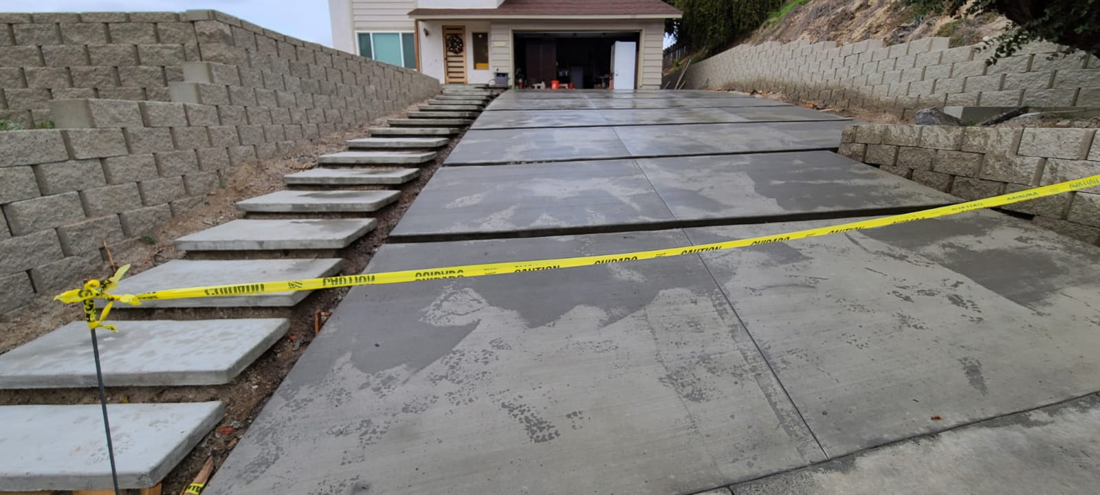

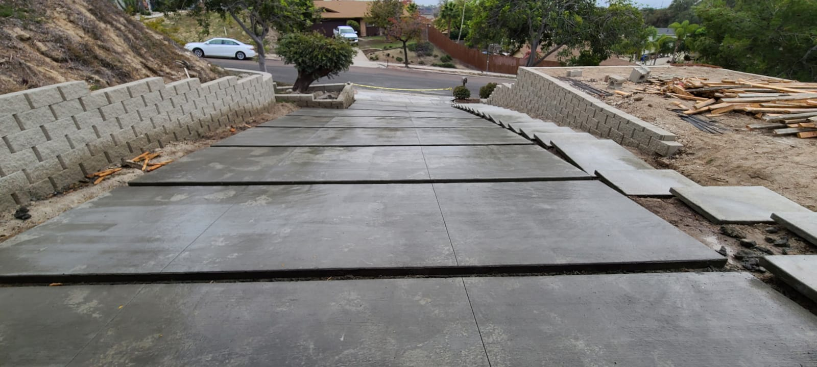

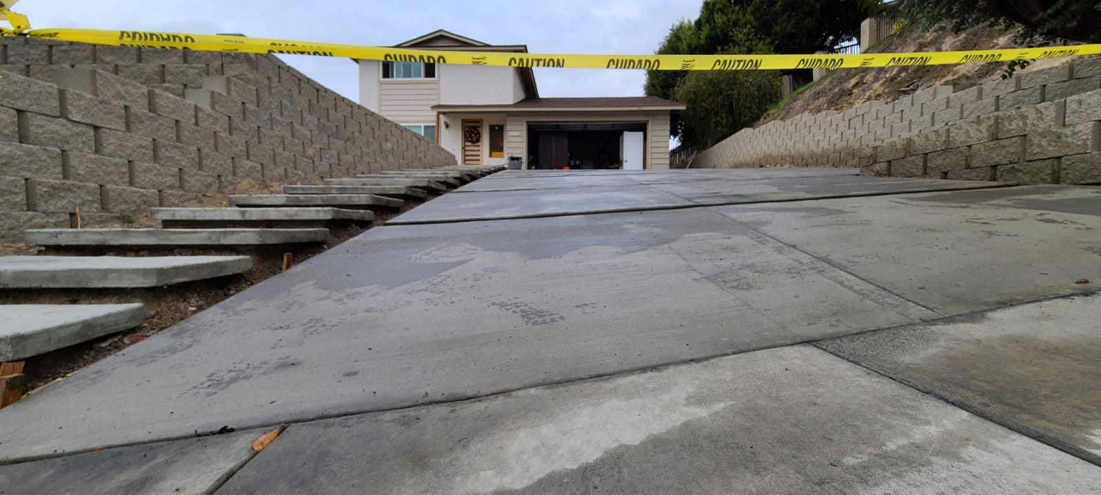

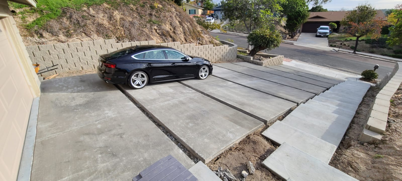

No more updates for now. Driveway is curing and a storm just passed through. Next steps are filling the spaces between sections with sand and stone then landscaping, and turf. Should be looking good by the spring.

After the forms were removed. Car on the driveway after a week of curing. Curing process was watering 6-7x per day.
