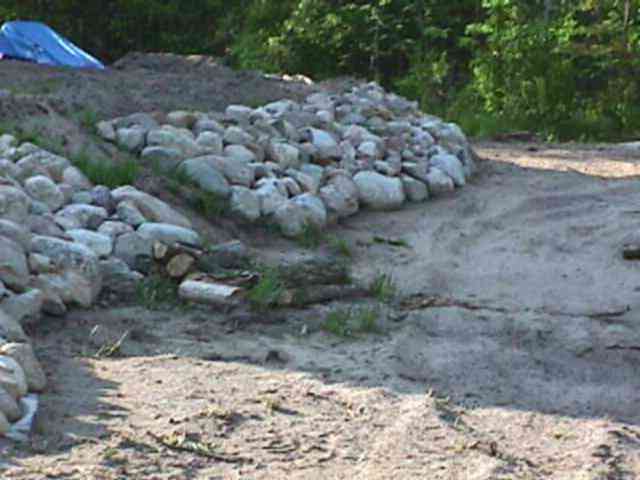

Hello, I am from Michigan also. St. Charles area. Here is a picture of my retaining wall. It is about 6' at its tallest. I have used about 13 ton so far at a cost of about $1000. I am using an L3010 tractor with absolutely no troubles. You may have to just lift fewer boulders at a time. I am filling the bucket with no hesitations whatsoever.
Regards,
Dennis

One other word of caution. I had an cement drive slab that tapered to 1 corner. Tried to build this wall there and it completely washed out all the boulders in the corner. So I ended up pouring a cement "trough" (I guess for lack of a better word) and that seems to have solved my erosion problem on the corner. The rest of the wall has held up very well for a year now.
Just something for you to consider.
Dennis

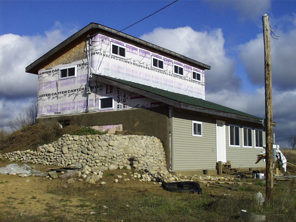

There are 2 keys. 1. Good footing below the frost line. 2. Wall must be THICKER at the TOP.
To accomplish #2, Build the wall a couple of feet high at a time (you can't cement much higher than that in a day anyway), place a wooden form behind and pour in a Stealth Fiber reinforced cement.
Hope this helps.
