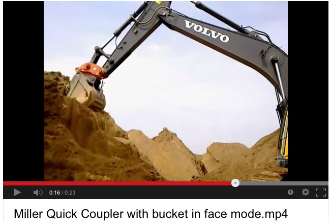

'face mode'

If you reverse the cylinder, it will still curl when the cylinder is retracted. Doesn't matter which way the cylinder faces.
From the video above:

exactly what i was thinking about the tilt rotator, but one could get dizzy and end up like this guy
