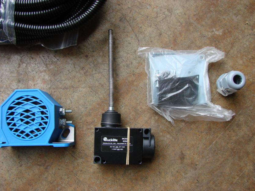

Some of you already know that I use my tractor only for snow clearing. I've made every attempt to make it safe for both me and the general public.
To add to the safety factor I installed a reverse camera with a 7" LCD monitor. I've added LED lights to the top of the cab along with a top of the cab strobe light bar. Strobe lights on the rear of the blower and White strobes on the plow on the FEL. It seems there are people who still don't pay attention with all that stuff on the thing.
Last winter during a Hugh snow storm I was out plowing at 6 AM in the morning. I could hardly see the plow in front of me and as I was backing up on the parking lot I almost ran over a lady walking up the road :eek:. Do these people realize that we might not see them in a blinding snow storm?:mad:
Anyway I decided then that I would install a reverse beeper on the tractor to try and make it even more safer than I have it now.

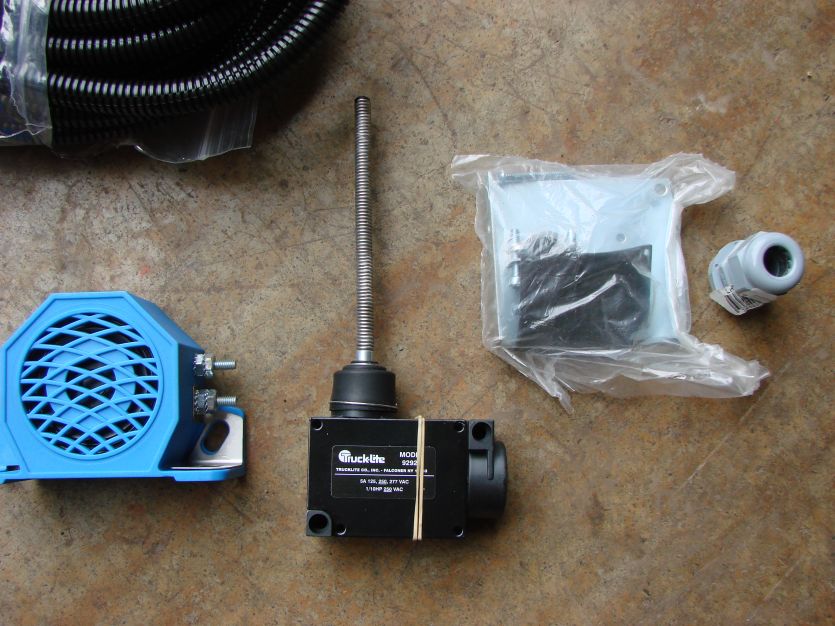

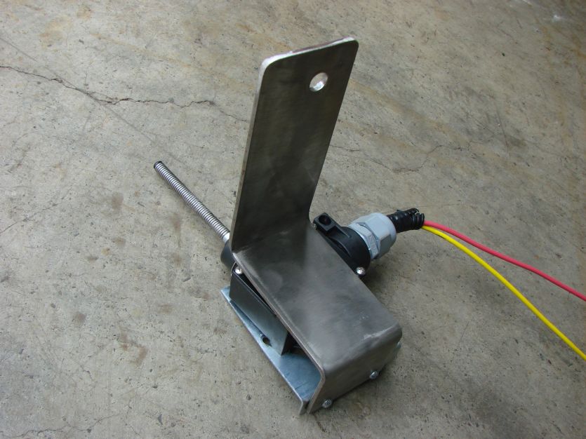

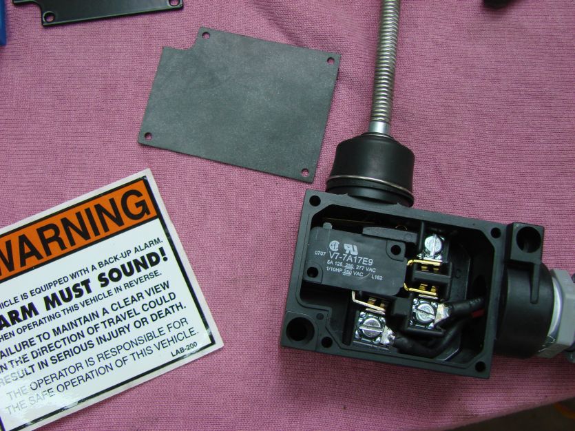

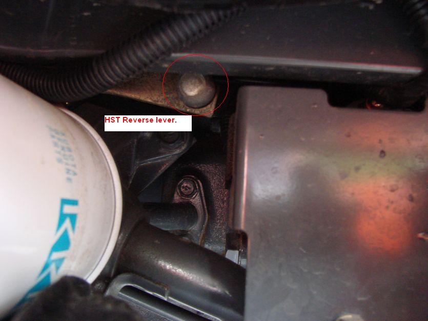

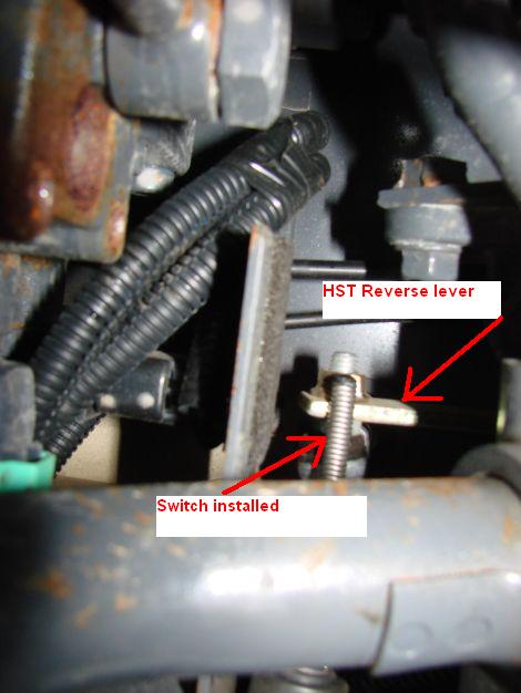

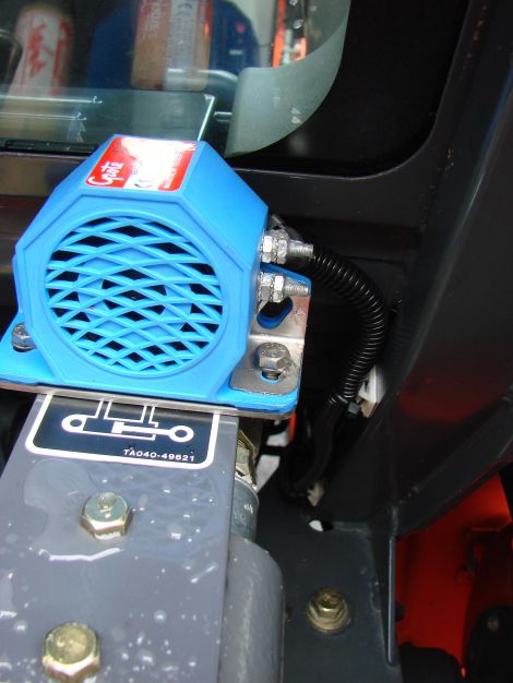

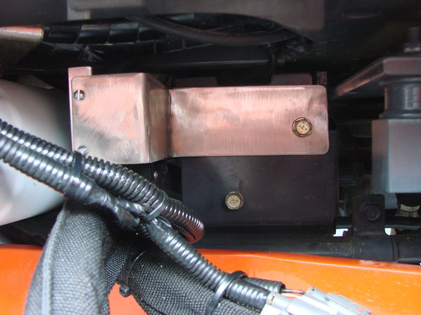

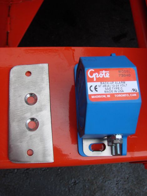

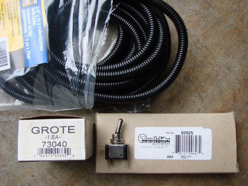

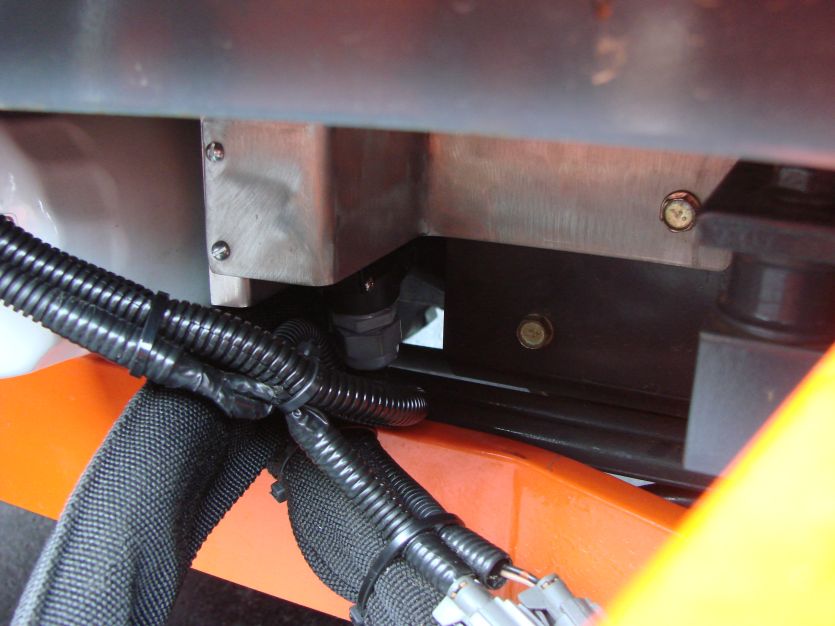

My Kubota is a L4240C and as you can see by all the photo's I snapped today It wasn't an overly complicated job. The bigest problem I had was fining the right switch for the task.I used a switch made by Truck-light. The part number is 92925. This is one very nicely designed switch. It's water proof. The spring lever will activate the switch in any direction and it comes with a small mounting plate that's adjustable. I did make another plate out of some stainless steel flat bar to adapt it to the tractor as seen in the photo's. I also made a stainless steel plate to attach the beeper to and as you can see I placed it on top of the AUX bracket.

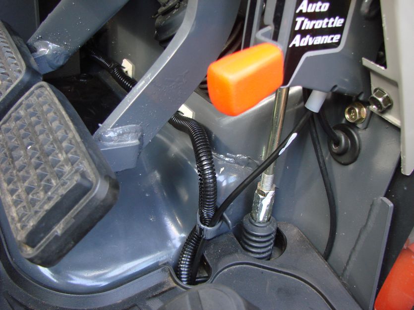

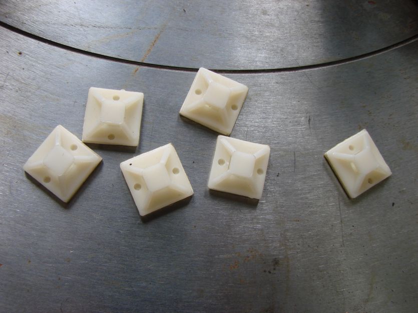

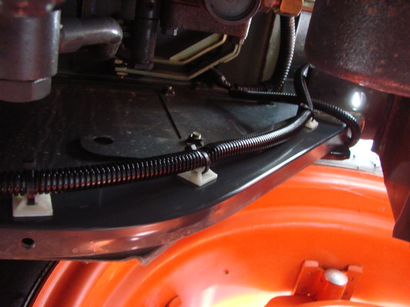

All the connections were soldered, heat shrinked and covered with black wire loom. I use those peal and stick tabs to stick on the tractor so I can secure the harness (love those things) and then ran the main power wire in the cab via the 3rd function wiring and put a 5 amp fuse in the line and went to the fuse panel with it.

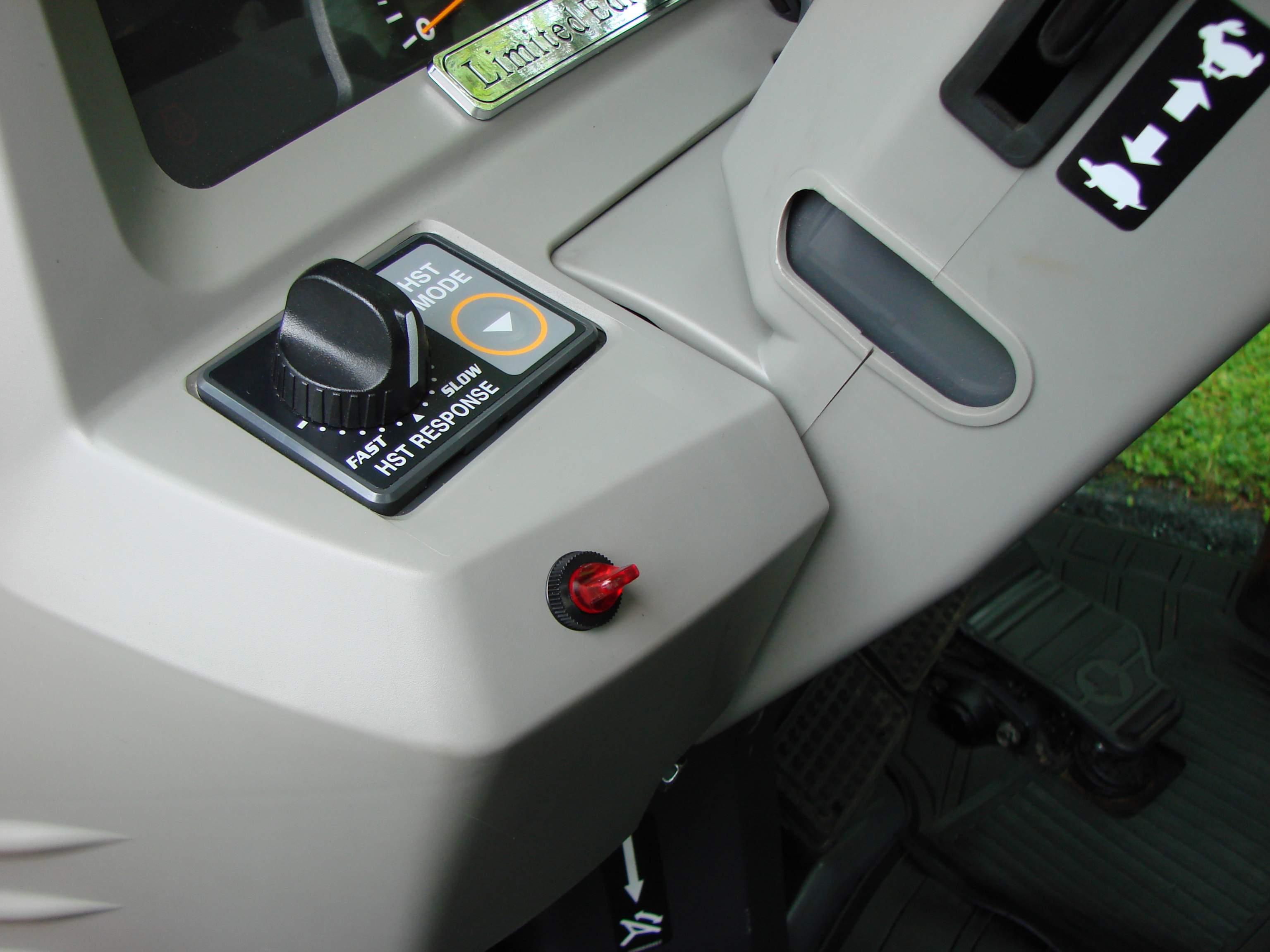

I'm sure it will help or at least I hope it will. I rethought the beeper set up and thought to myself that will I want to listen to it when I'm using the blower in the back so today I installed a by-pass switch in the system. Now the switch has to be lit red before the beeper will function.

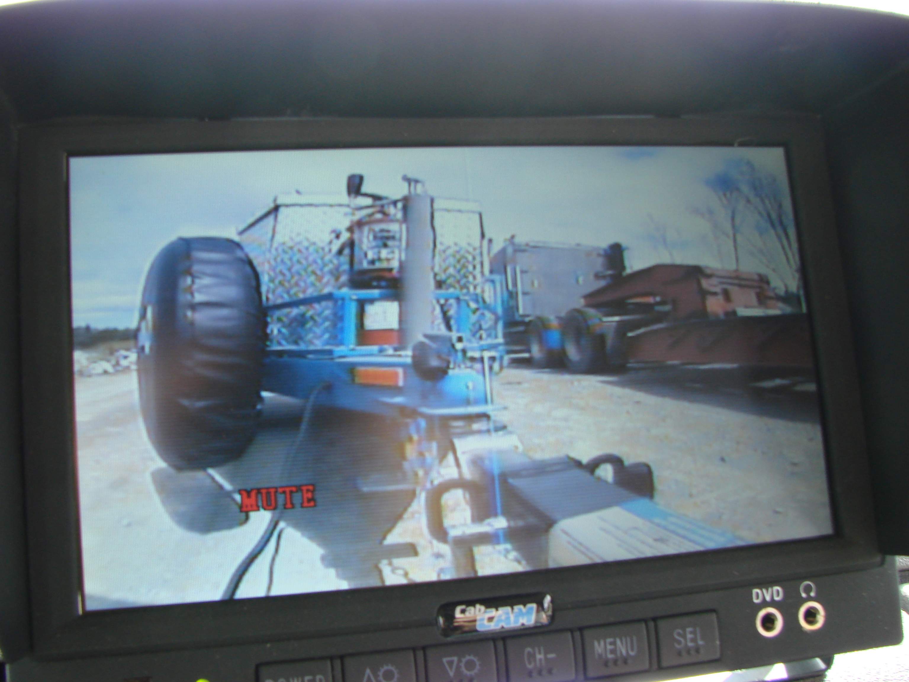

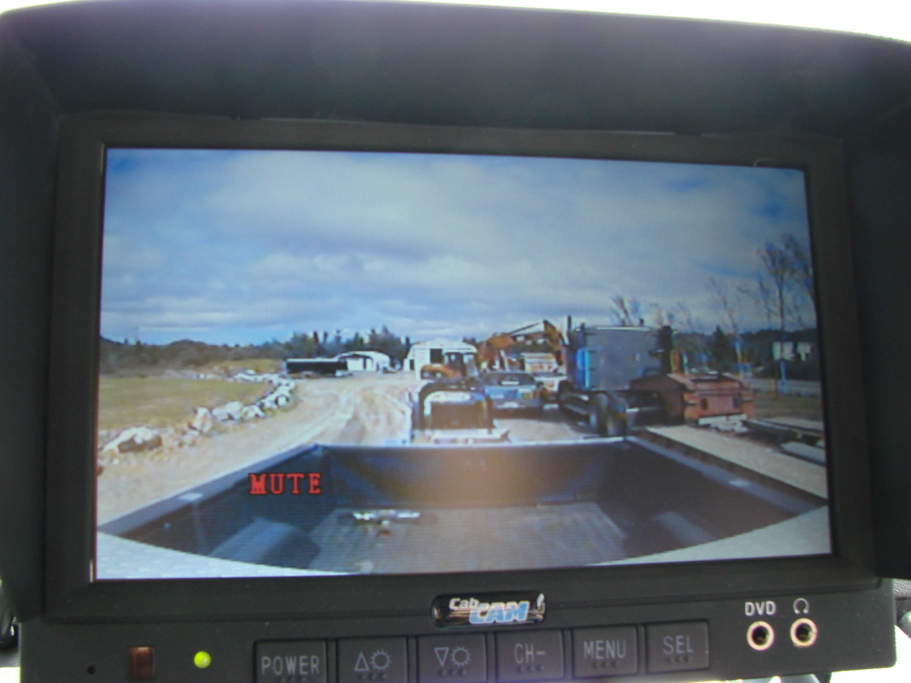

The camera system is great. It's so good in fact that my son bought me a complete system for my old truck. With the truck I use two camera's on it. One is up on the back rack while the other is on the bumper. This system has a microphone in each camera and both are inferred. I attached two pics of the camera's from the other day. It's much clearer in person. Some how it don't leek perfect via digital photo.

What brand of "Beeper" did you install ?

I used the Grote beeper. I find they last forever. That's about what I paid for the "Rain Tracker". The problem with installing them is there's no instructions for hooking them up to a tractor so it takes a bit of thought to get them working. I guess the worst that can happen is that you let the smoke out of the box if it's done wrong :eek:

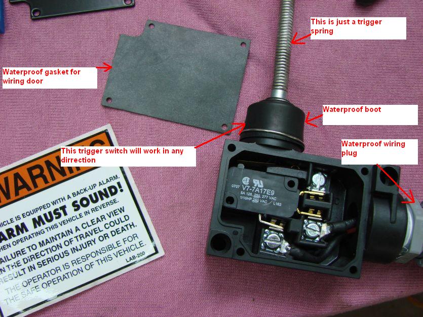

Paul, as usual your workmanship is terrific!!! I do have a question though. With the enormous amount of snow that you get is the switch protected from heavy accumulations of snow or ice that might jam the switch in either the open or closed position? Keep up the good work and thanks for the pics of your products.
/ Reverse Beeper Installation
#11
Thank you sir! I doubt very much that the snow would ever get up to the bottom of the floor. If it did I think it would be safe to say that the switch staying on would be the least of my worries because I would very badly stuck :D
The leaver you see sticking out of the switch is actually a long spring that passes through the protected boot. If anyone is installing a switch like this the spring can be trimmed to make the perfect fit. You can also rotate that spring 360 degrees and it will activate the switch every time making it ideal for this type of application. I attached a picture of the switch with a detailed description of it. If by some chance the beeper did come on when I didn't want it to I installed a by-pass switch to over ride it and turn it off.
A lot of heavy equipment use this type of switch and it's been one of the most reliable switches to use for this type of application. Appreciate your comments. Thanks again. Paul
