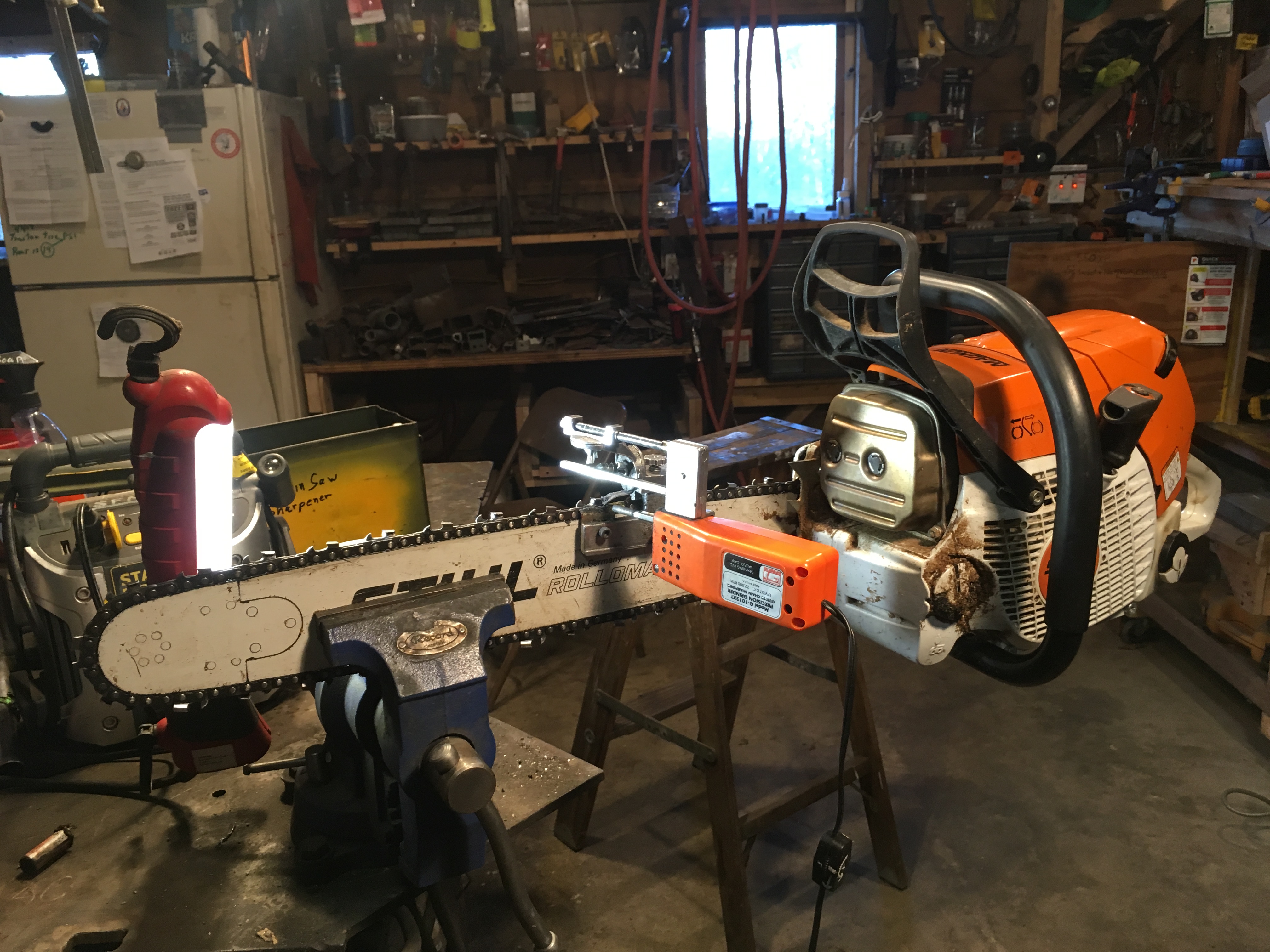

I put together a short video that I thought was short, but after uploading it I should've shorten it a little more. I been using my sons Stihl 441 Mag with 20' with bar the last few weeks and after a final bang on a rock it needed sharpening bad.
So this afternoon I went to get it back to full chisel, started with a new flat file, went around the worst side with 7 swipes/tooth ended up ruining the file, I wanted to do both sides but I dont know what that chain is but if it was any harder it would be carbide. Then I put my Granberg sharpener on it and even that had a tuff time compared the the Oregon chains I get, so after I went around the chain then look it over with flashlight, nope needs one more time, then check it again, nope this chain is so hard I had to go around it three times, thats the video I made of this one last time, just a little more touch up. Think I was about a hour trying to straighten that chain out, the good news is the saw didn't have a 24" blade on it.
Should've had my son videoing so could zoom in better but after church all he does is nap all afternoon. So if you got a few minutes to waste take a look and maybe get idea of how a Granberg sharpener works. I didn't up load the whole video if I did be hour long, I also left out taking the rakers down with it, maybe next time. If my son trys his saw out this week he better hang on.

I used a friend's power sharpener once and it hardened the teeth so much that I couldn't use a file on them anymore. Is that what your son uses for sharpening?
   / Review of chainsaw sharpener I just bought #39
No he uses a file, I tried it and his file was dual, he said it wasn't that old, they dont last long on a Stihl chain, and that chain was the first time the Granberg sharpener was on it. I've been using my Granberg sharpener now for 2 years on my saw with 325 Oregon chains, they sharpen easier, maybe Stihl makes a stronger file for their chains. As hard as they sharpen dont know if I'd wanna put one on my saw that I havent bought yet.
