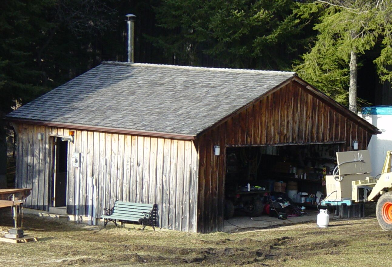

So my ratty (lifetime) cedar shingles in my detached two or so car garage/shop have started to leak.
Have a contractor coming tomorrow that replaced the cedar shingles on my house with steel, comes in long sheets, peak to eave, but ressembles shakes.

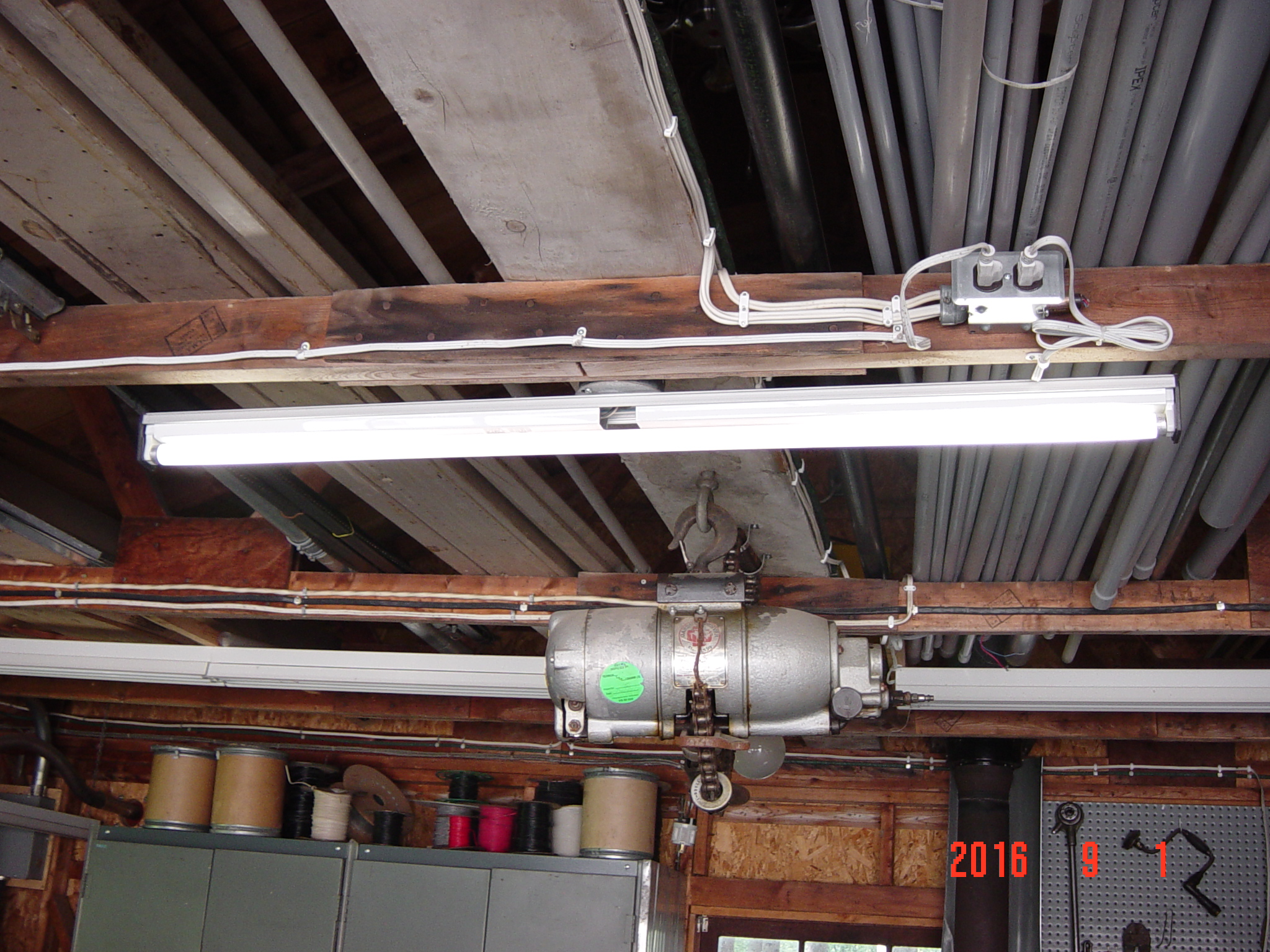

I have open trusses. My ceiling is very cluttered with lighting. I have stuff stored in the trusses. My garage door has zero clearance to the underside of the truses, in fact I had to notch out a truss and install a roller, for as the garage door heat up in the sun, it bows slightly and would catch the bottom of the trusses. My garage door had been raised and replaced to accomodate a ROPS.
So, I am considering putting SM under the new steel roof. Maybe 2". Any thoughts?
It's not my first choice for insulation, but since the roof needs done, is it the most logical approach? I really don't like my heat going into the upper space, although I do have a ceiling fan up there. I don't want to spray foam the underside of the roof for fire reasons and it is very unsightly and messy looking. Is there any advantage that would make me feel better about this external approach?
Maybe the only picture I have of the (cluttered) ceiling, BTW That's a 12 volt light that connects to my alarm battery for emergency illumination.
Old picture. The shingles have seen better days. Sad, I really likd the look!
Thanks

it certainly wont hurt your wintertime temps. be sure to leave an open air gap, usually done with 1x between the insulation and the roofing. this will help with condensation on the metal in your climate. are you planning on or do you have heat in there? something with a radiant barrier would be good. reflective side in.

Thanks. I was thinking if the brown tin needs circulation to keep cooler? Atop insulation, I can't imagine the high summer temps. Strapping would raise the height even more though.
Not a building that is generally heated. Just a wood stove and consruction heater sometimes as a load on my genny.
The contractor did put my house roof steel right on the roof.
