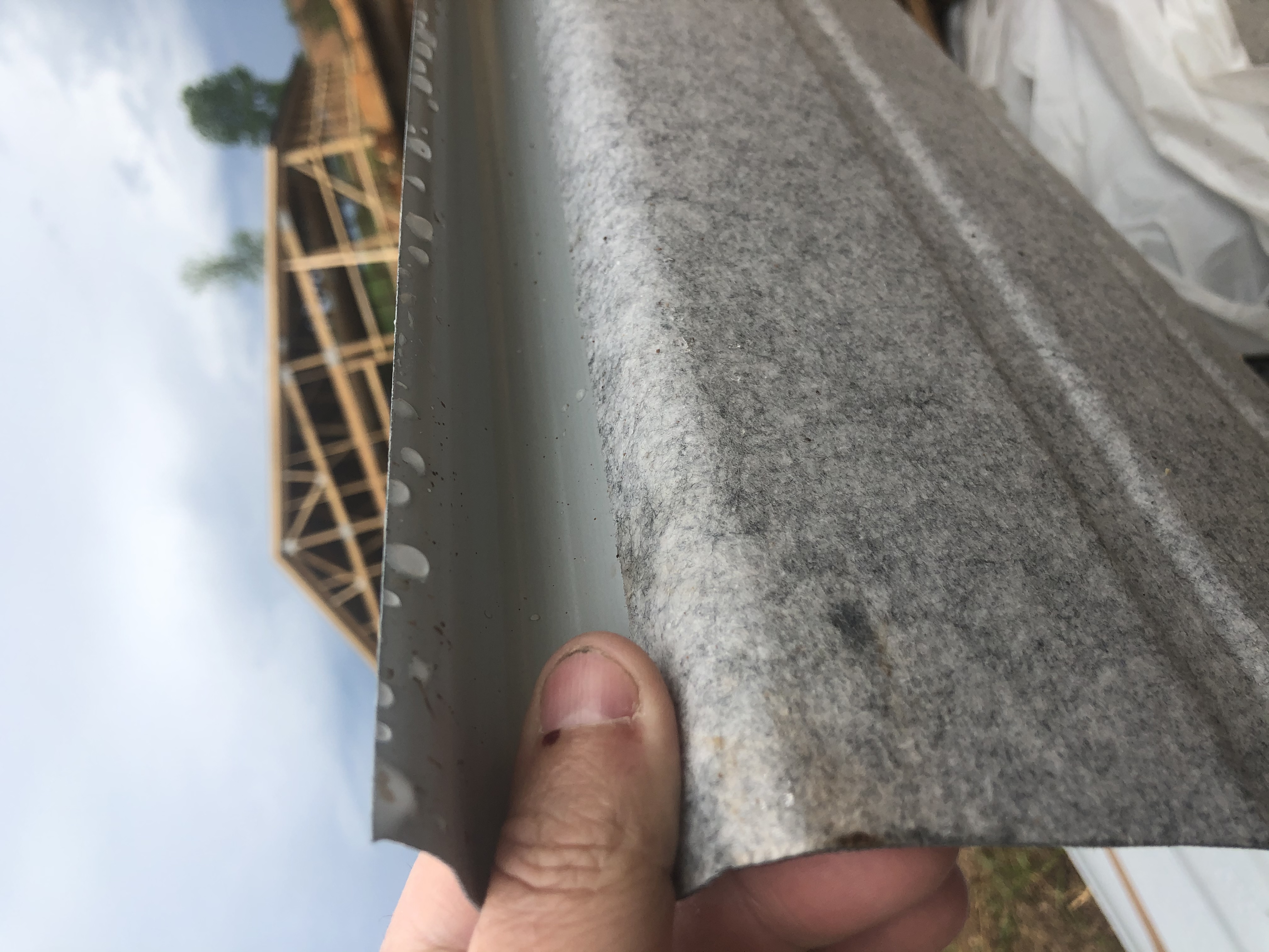

Take a look at drip stop. Itç—´ a thin material glued onto the underside of the metal...i have it on my Morton building. Itç—´ supposed to hold any moisture that accumulates on the metal and allows it to self dry out as the temperature changes (supposed to not drip).

Take a look at drip stop. It痴 a thin material glued onto the underside of the metal...i have it on my Morton building. It痴 supposed to hold any moisture that accumulates on the metal and allows it to self dry out as the temperature changes (supposed to not drip).
I have that in my Morton barn and they also put 2 new roofs on my other barns no more dripping...................Its called DRY-PANEL....
