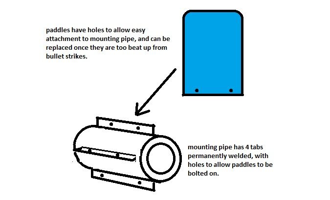

Ok, rifle target version 2 has a little plastic tab that allows the paddle to spin, but then slows it and stops it in the right place. Kind of like how a hockey card in your bike spokes (for that awesome engine sound when you were a kid) would be placed. :)

Sure, or maybe just a thick cabletie around the bolt with the end sticking out in front of the paddle, then snip off the excess. Really easy to do and also easy to replace if it wears out. Shouldn't be too hard to field test a couple of options. :)

Not sure how much effort you want to put into fabricating these, but I was just thinking about the effect of bullet strikes over time beating the crap out of them and how it would be nice to be able to replace the paddles without having to muck around with the whole thing. If you welded some angle to the mounting pipe, you could make tabs that hold the paddles and then you could easily replace the paddles as they are damaged by bullet strikes.

This is a good point. Perhaps with the example I was showing, you might want to shoot at the paddle on the bottom instead of the paddle on the top. The result would still be the same spinning of the target, and the motion of the target plus the paddle sticking out of the front above it would help to deflect bullets downward and stop fragments from ricocheting upward.
