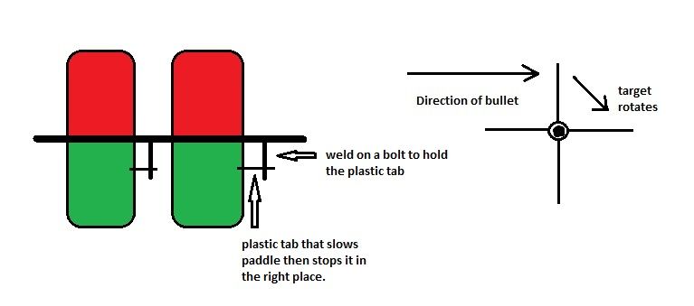

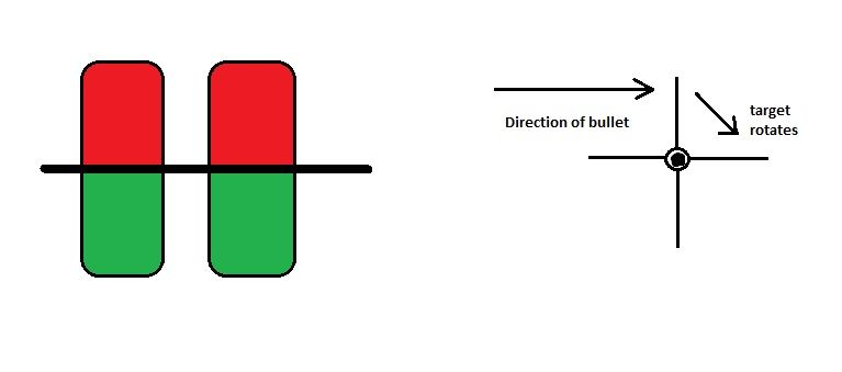

What about a paddle with 4 sides rotating on a pole? When you hit one, another one rotates up. Paint each paddle a different colour so you can see when it has rotated.
That's one of the most creative ideas I've come across.
Wonderful picture as example as well.
How would you get the paddles to stop at the right spot?

They won't, they will spin and stop at random places with random colors showing, but what difference would that make? You would still be able to see the change of colors and the motion..

I would prefer shooting at the face of each paddle, avoiding weird angles.

Ok, rifle target version 2 has a little plastic tab that allows the paddle to spin, but then slows it and stops it in the right place. Kind of like how a hockey card in your bike spokes (for that awesome engine sound when you were a kid) would be placed. :)
   / Rifle targets-need ideas #90
You could also make sure the axle was on a good bearing, and then weight one of the vanes so that is is heavier and will always stop with that vane pointing down.
