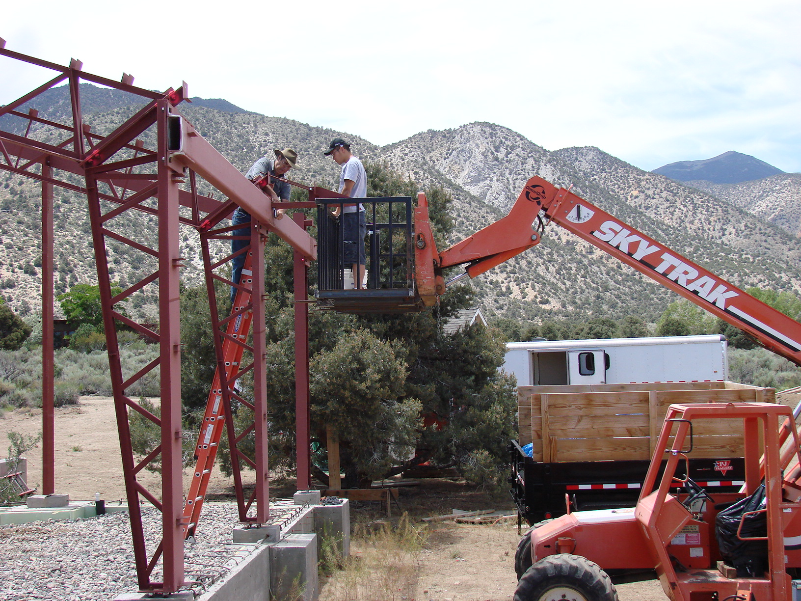

I'm building a 48X60 clear span steel frame house with a 12X60 foot expander. It will have a 700 sq ft porch, a 36 x 28 shop/garage and a two bedroom 2 bath home.
We poured square footings that went about 2 feet below the frost line of 18". Each post has one of these footings and the land is sloped, so, in the front, the footings are abut 5 feet high and in the back, right at ground level.
Then a stem wall section was poured between each footing. The forms for the footings had steel sticking out to tie into the stem walls.
Finally, the slab will be poured with radiant heating throughout that is tied to a grid of bar on about 9" centers.
Here are a couple of pix.
These pix are a bit old now. We have the roof on but no walls yet.

I'm not a casual as some about just digging a trench for the footing pour. We excavated the area to the level of the bottom of the footings. Then we compacted and watered till we could not get further compaction with a vibrator and a jumping jack. Next the form boxes were set and the rebar installed. After these were poured and stripped we formed the stem walls and poured them. Then we backfilled and compacted around the outside and filled the inside with 1 1/2 inch rock and compacted as we went.
Our elevation is 4900 feet and we are on decomposing granite.
The slab will not be floating but will be tied directly to the footings.
