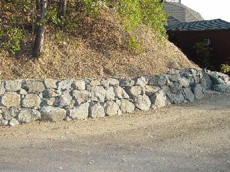

My new self designed "Mini Me" Rock Jaw Grapple is for myself and the wife to build rock walls.
At her old home before we sold it she had be build a set of primitive steps up through a laterally running stone wall. I previously had dumped a lot of soil on the uphill side for her go size garden. The neighbor was freaking out that we selling to "new" people and we were concerned that they would run a fence making access to our garden difficult and we wanted to do right for the new owners so they would not have to climb over the wall to get at the garden.
PS, The landscaping sold the property, so tractors are an "investment"
At the time The L39 was brand new and I had a real hard time using the hoe with the Mechanical thumb to place rocks exactly where she wanted them.
So when we go to build walls on our new property these tongs ought to help. More Photos are located:
