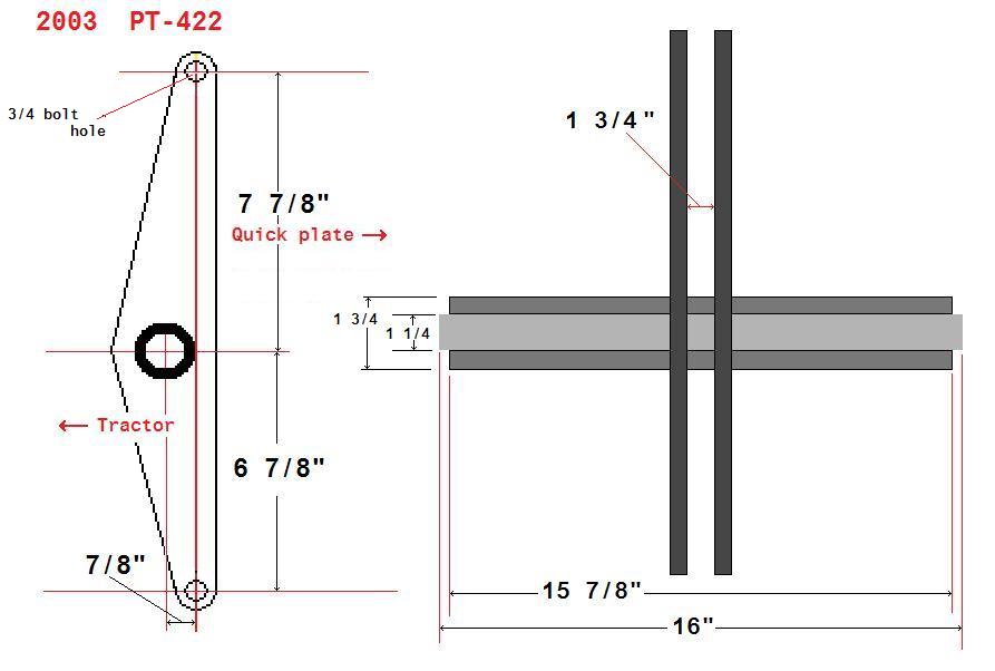

Could some of you all check the dimensions on this? I measured it the best is could with what I had. Thanks

Corrected dimension circled in red ......

My 2000 model 422 dimensions measure about the same as yours. top 8" bottom 7" , 1 3/4 "distance between . Outside to outside 16 3/8" , inside to inside 15 5/8. Those are the only measurements I took , I just used a ruler and eyeballed the distances so they might be off a little.

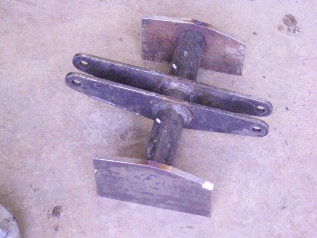

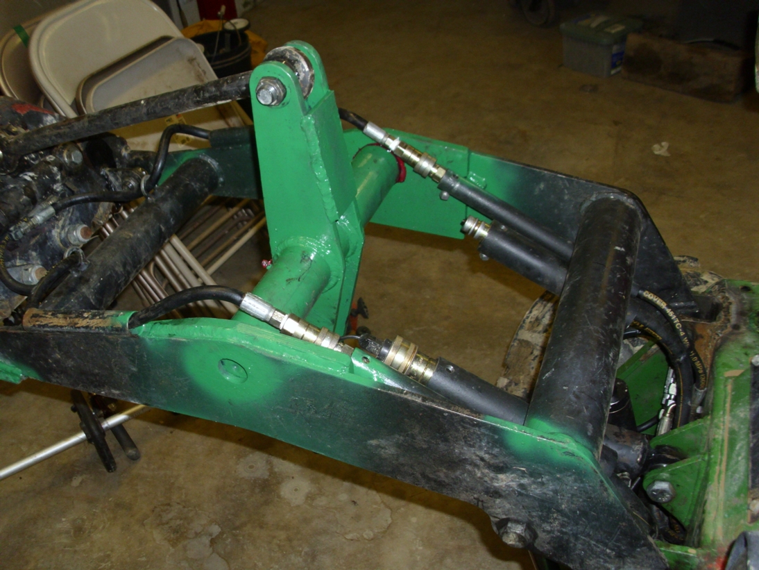

I just built and installed my new roll over linkage. A larger shaft and pipe was used. The old arms were used but had to be drilled for the larger pipe. Hope this one holds. Here are some pics.

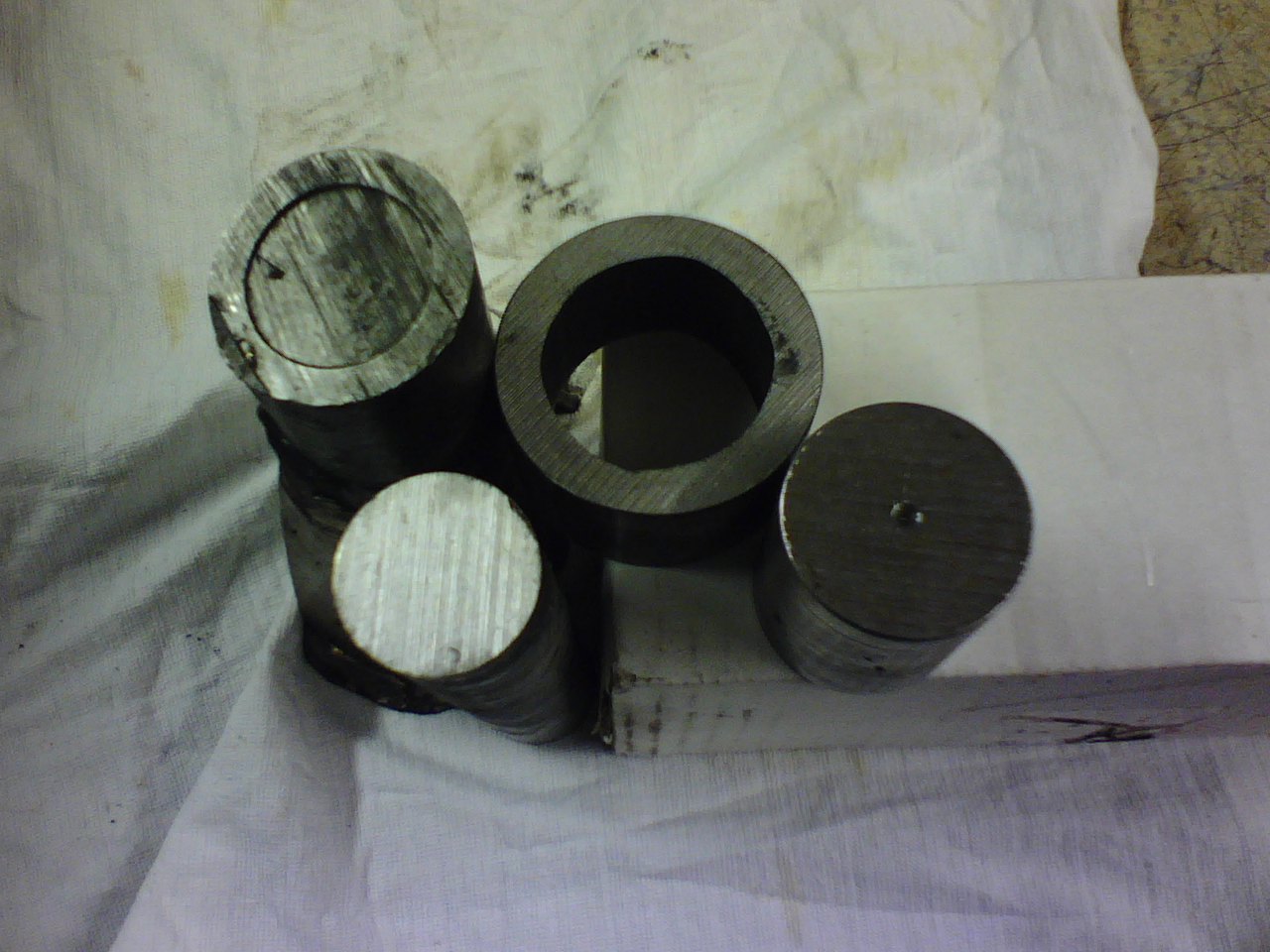

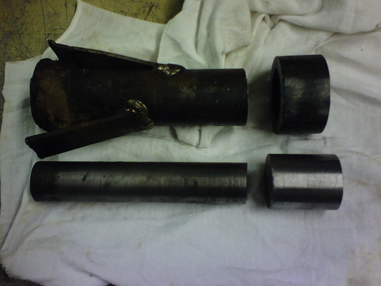

Here are some pics that shows size of the old verses new material. Larger material used for roll over linkage.

Anybody know the year that PT started offering the larger roll over pin and tube?
   / Roll Over Linkage - Some help plz #30
October-November 2005 was when I replaced mine on a PT425.
Previous attempts didn't hold up; much larger pin and rollover have been fine ever since with even heavier use.
