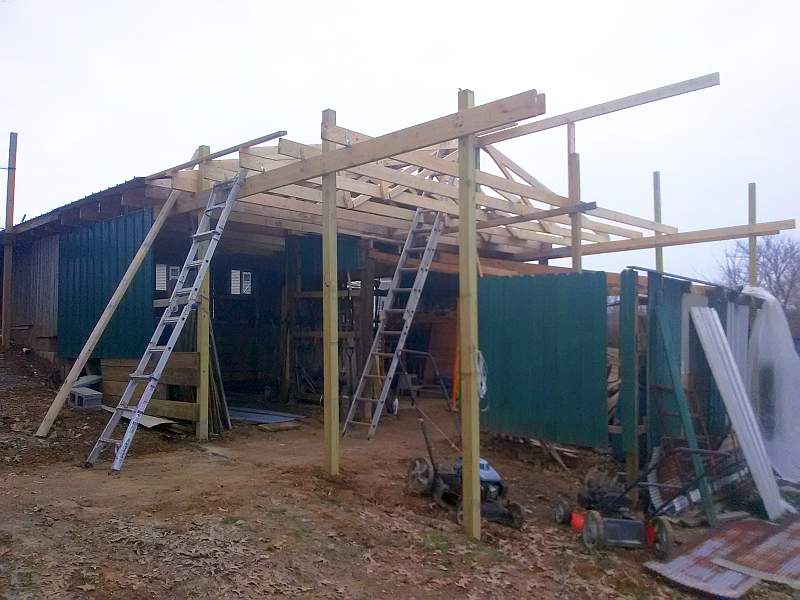

Don't laugh, I told you it was ugly.

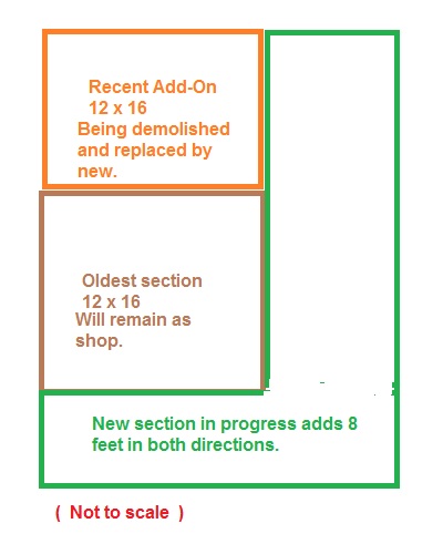

Refer to the rough sketch above for orientation.
You can see the oldest portion inside left and the previous add on to the right of that with the lower sloped rafters. You can also see the ground grade I'm dealing with. That old end wall is surrounded by mud, mud and more mud, so I can even think about tearing out the old wall and setting the new end posts yet. Ridge board is held up by a temporary post that will be removed later. It allows me to set the new roof system so I can get some of it covered and get some shelter for tools and machines.
Where the two ladders are standing will be a path through from this side to the other. Both sides will have doors/gates about 7' wide and 8' high. New rafters are about 9' above grade. The old sloped rafters are about exactly the same height as the ROPS and I literally rub them with one corner of it trying to drive in.
Where the two push mowers are setting will have to be backfilled to the level where the ladders are setting, but that part will have to wait until Summer when things dry out.

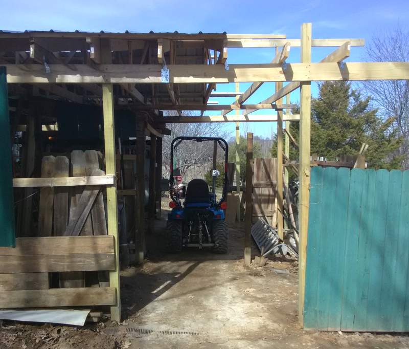

Hey look Ma! I can inside with the ROPS up!
Couldn't do that before. Had to fold it down to get far enough in to close the doors. Demo'd the old sloped rafters and a few other things, then put up some Polycarbonate (clear) roof panes for skylights and four more metal panels. I'm just sticking the old side panels up anywhere for now, mostly to get them out of my way. Not sure if I'll go new metal panels or something else.
'Course, with no roof, does it qualify as inside? More roof goes up next week sometime.
