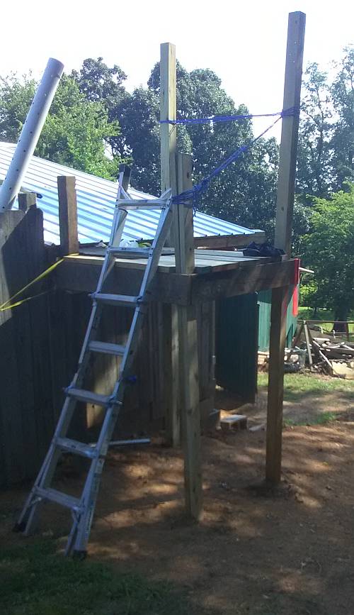

Worked this out for roof access. Between ladder and flat surface isn't a problem for me like ladder to slanted surface is. I can get on the platform easily, then just walk up on the roof. And yes, the roof and trusses DO hold me!! I wasn't sure of my work, so I was a bit leery.
Shed is partially dug into the ground at this corner which is why the ground slopes away. Platform is at the highest ground point and will be removed when roof is done, so didn't need to be super sturdy.

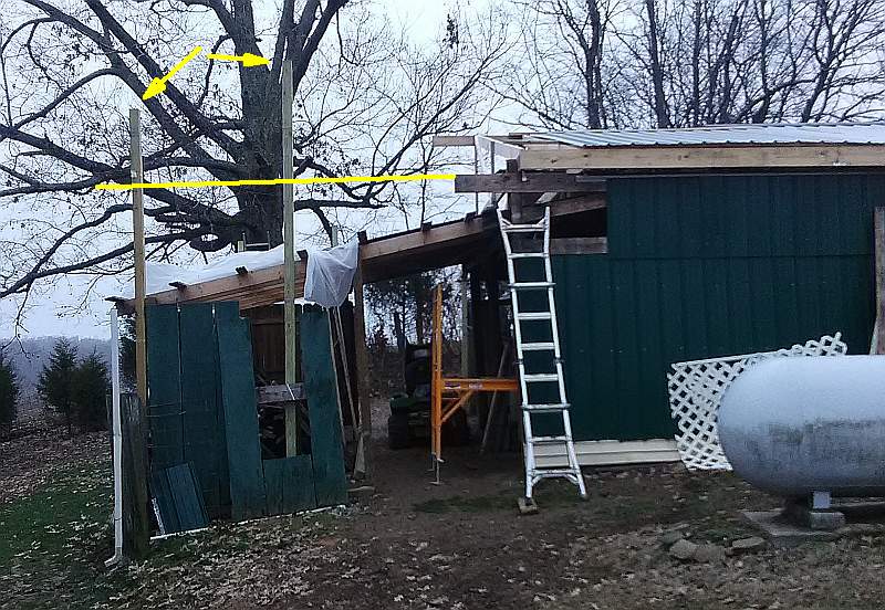

This is how screwed up this property is. The 2 4x4s are both 16' and set 2' in the ground. The difference shown between the tops is the ground slope. Once I get the roof line set with the 2x8s, I'll cut the posts where I need them. I'll set a couple of 2x8s at the bottom and backfill to level the dirt floor. I wanted one 2x4x14, but Lowes doesn't carry them in my closest store.

As noted in the post above, this whole area is sloped and will need to be backfilled once I get it enclosed. I know that bass ackwards, but it's the way it has to be. Dug out the laser level today and set a reference line all the way around, marking each post. From there, I can measure up or down as needed instead of trying to guess from the uneven ground.
Once I got that mark made, I went back and double checked a few things I had done to a 4' bubble level. Figured out that all of that was within about a half an inch against the laser line. If you knew how screwed up I do things, you'd realize that half inch is quite remarkable.
