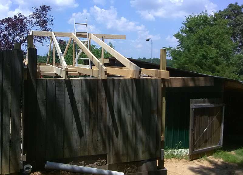

Got a few more boards up today. Starting to take shape so I can see what I have to work with. I don't do well with images or sketches on paper, I have to see it in the raw. I'll start working on the webs tomorrow. Will probably be either a Howe or modified Fink of some sort. I need those center verticals but I can add some W's also.
It's a little deceiving due to the wall in the foreground. That's a little over 4 feet, so the bottom of the bottom chords is about 9 feet above what will be the floor. The new will be built in stages as I have funds and sweat available, but it make take a few months. The plan is to build it over the old in part so I have something to stand on while working. Eventually, the old will be torn down from inside the new.

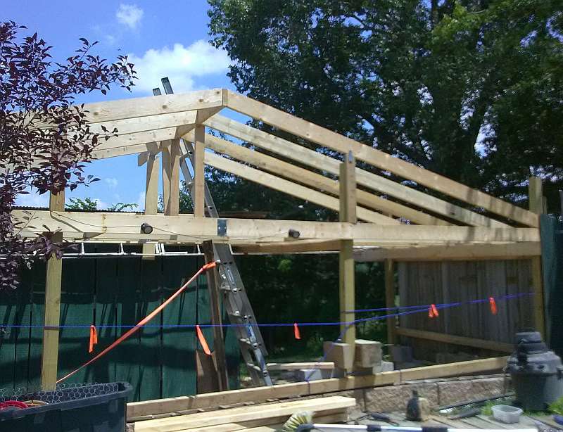

Haven't got a picture of the trusses right now. Went with sort of an inverted Fink, I guess. Looks like a W with a center vertical, spaced at roughly thirds top and bottom. Part of the metal roof is on, but it needs lots more screws once I get the gumption to try to get on top of it.
Been working on moving some of the old barnwood boards off the old shed to cover the new wall. Added a cheap 24 x 24 slider window.
