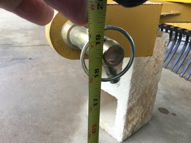

but how many cat 1 rakes are sitting ( level ) with the lift arm pins located at less than 8 inches off the ground?? OPs 1st pic- certainly looks like just a few inches.
Just measured my cat 1 Rake -and to be close to level, the lift pins are about 18 inches off the ground.
Obviously rake design varies, and there will be differences also there does need to be enough lift arm travel to accommodate actual in use raking conditions.
but It just seems as if Luke is right about the top link being screwed tight (shortest possible length) and the rake was (and possibly still is) front low when the tines touch the ground.
   / Rookie 3pt question #39

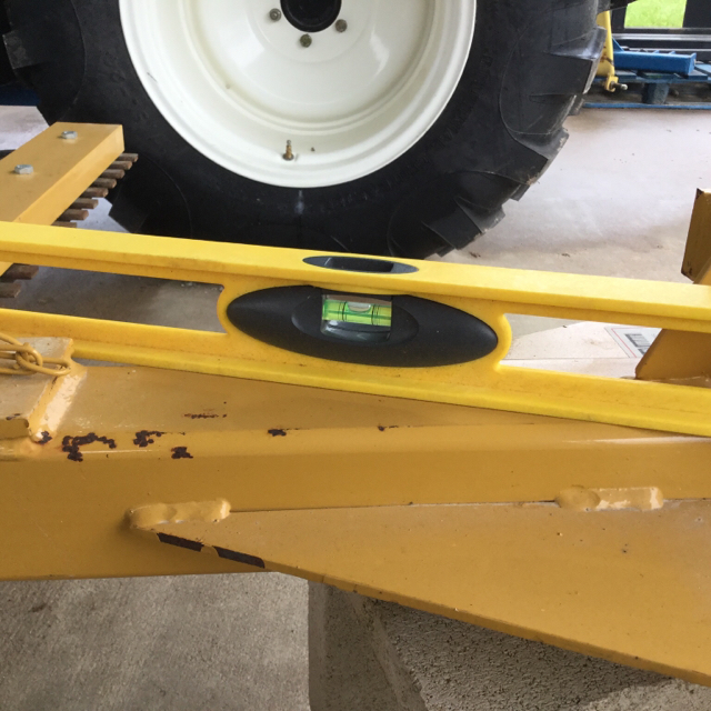

I just measured my 84" Cat1 rake, sitting on concrete. With it sitting level, front to back, the lift pins are 18 1/2" above floor.
I suspect this is fairly typical among Cat 1 rakes although, I did see an Armstrong Ag rake yesterday, with much longer rake tines, that would probably be about 24" when level.
