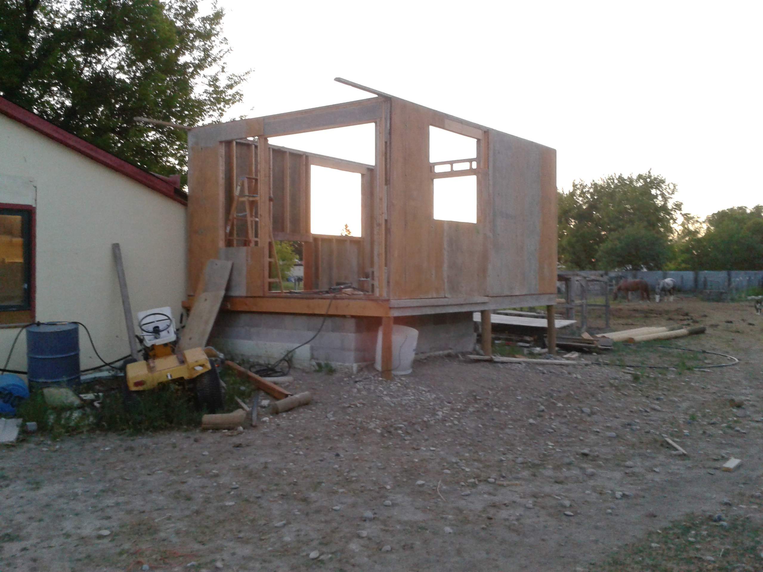

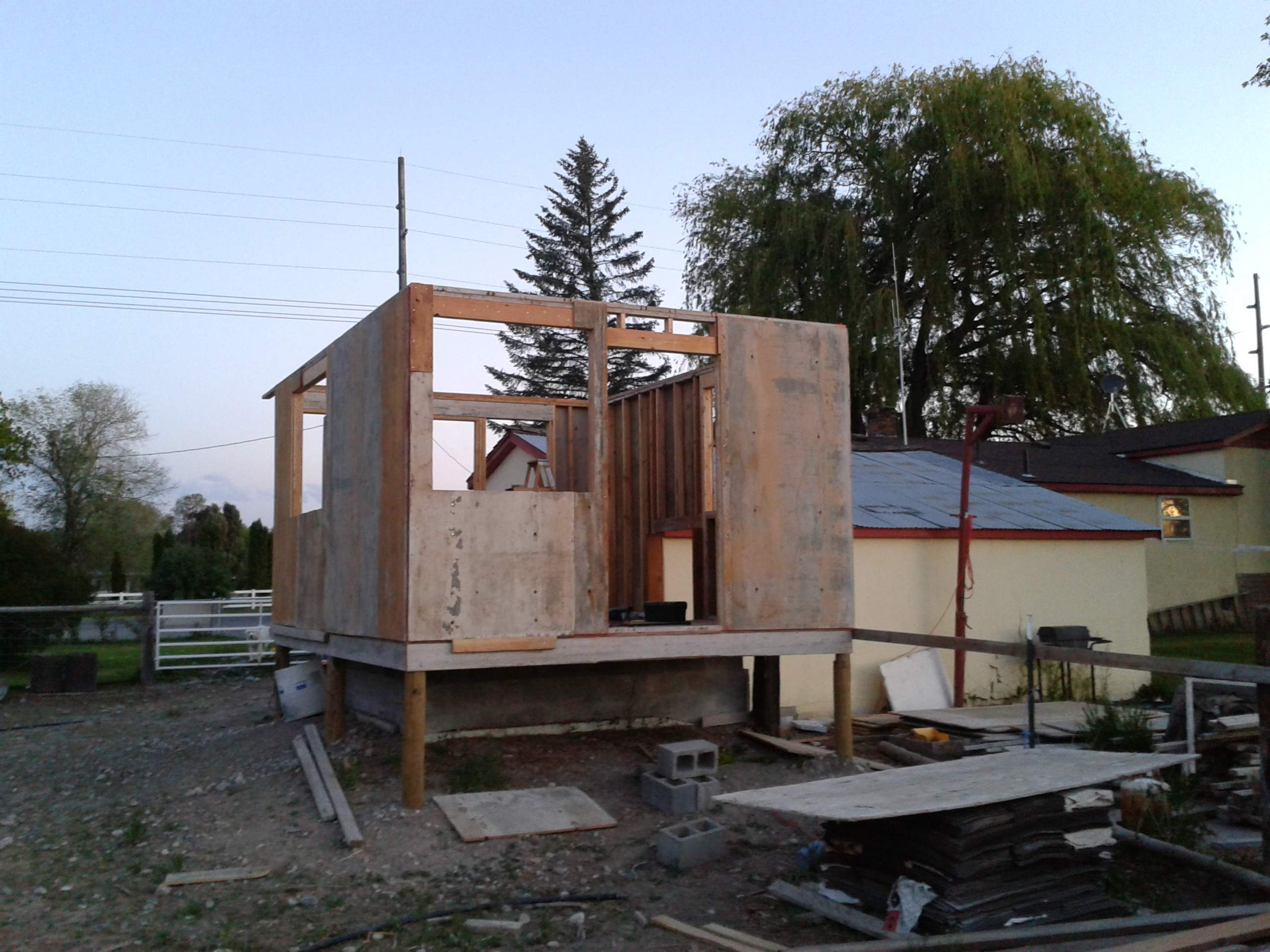

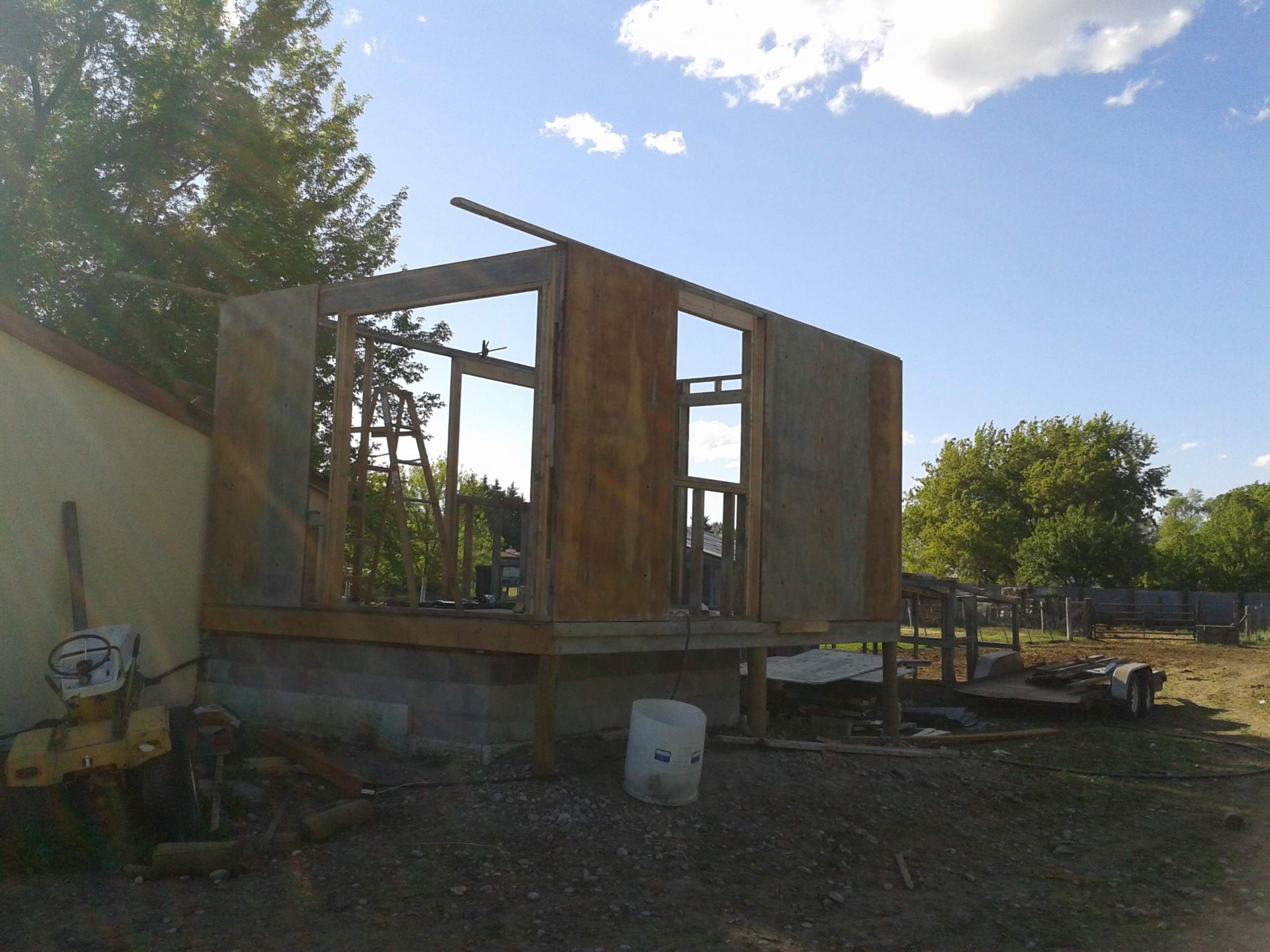

I got the fourth wall up on Saturday. I've included a second picture from the back side to get a better view of this fourth wall. You can also see that I've put up more of the sheeting on the exterior.
I was hoping to get a little further on this before I found a good stopping place, but my wife has requested that I get some other projects done. It will likely be a week or so before I can work on this again.
I spent some more money. I paid $70 for some more used lumber, a bunch of 2X6 and 2X8 material. I expect that I'll be able to use it on the roof... ceiling joists, ridge beam, rafters. Some of the stuff is full thickness rough cut.

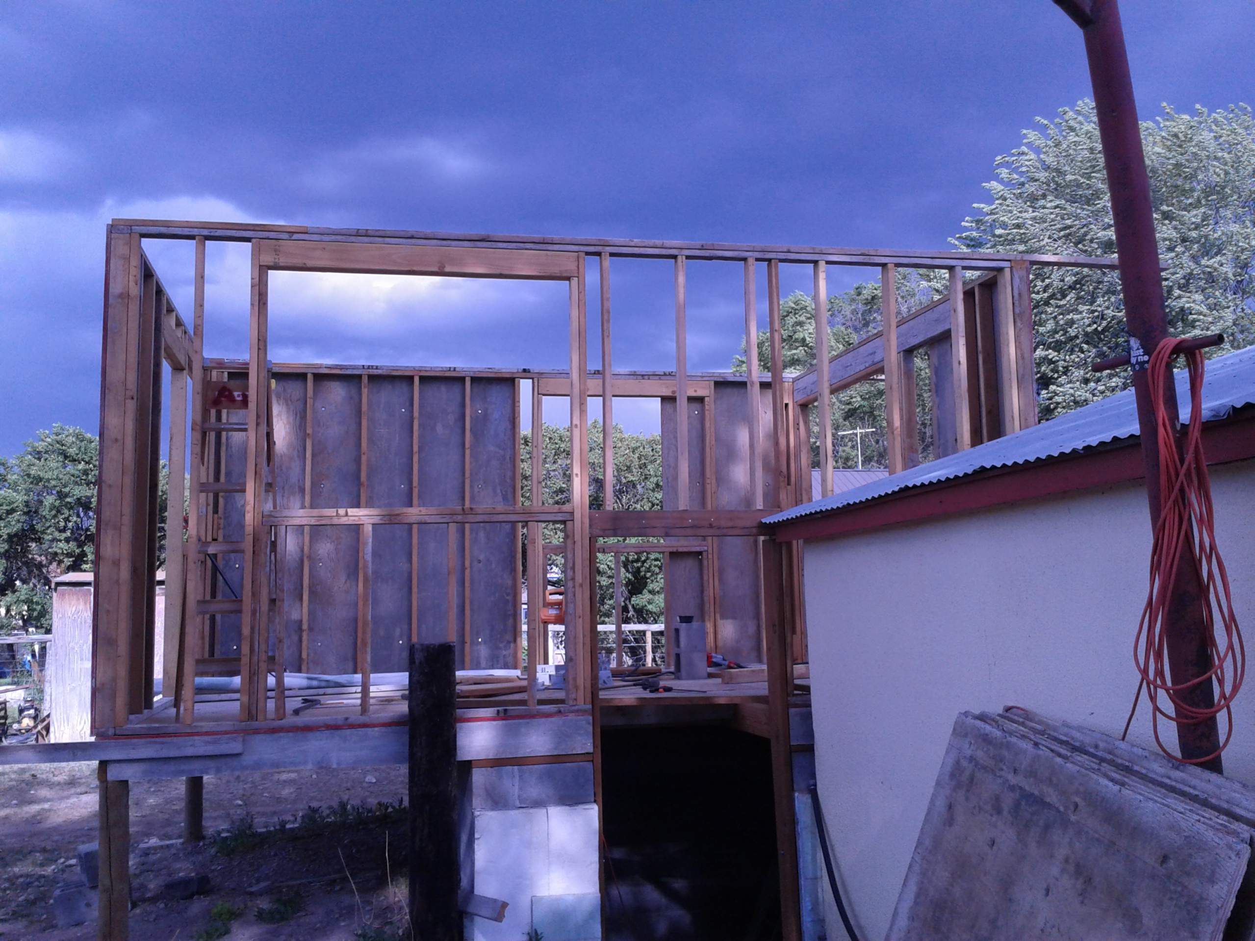

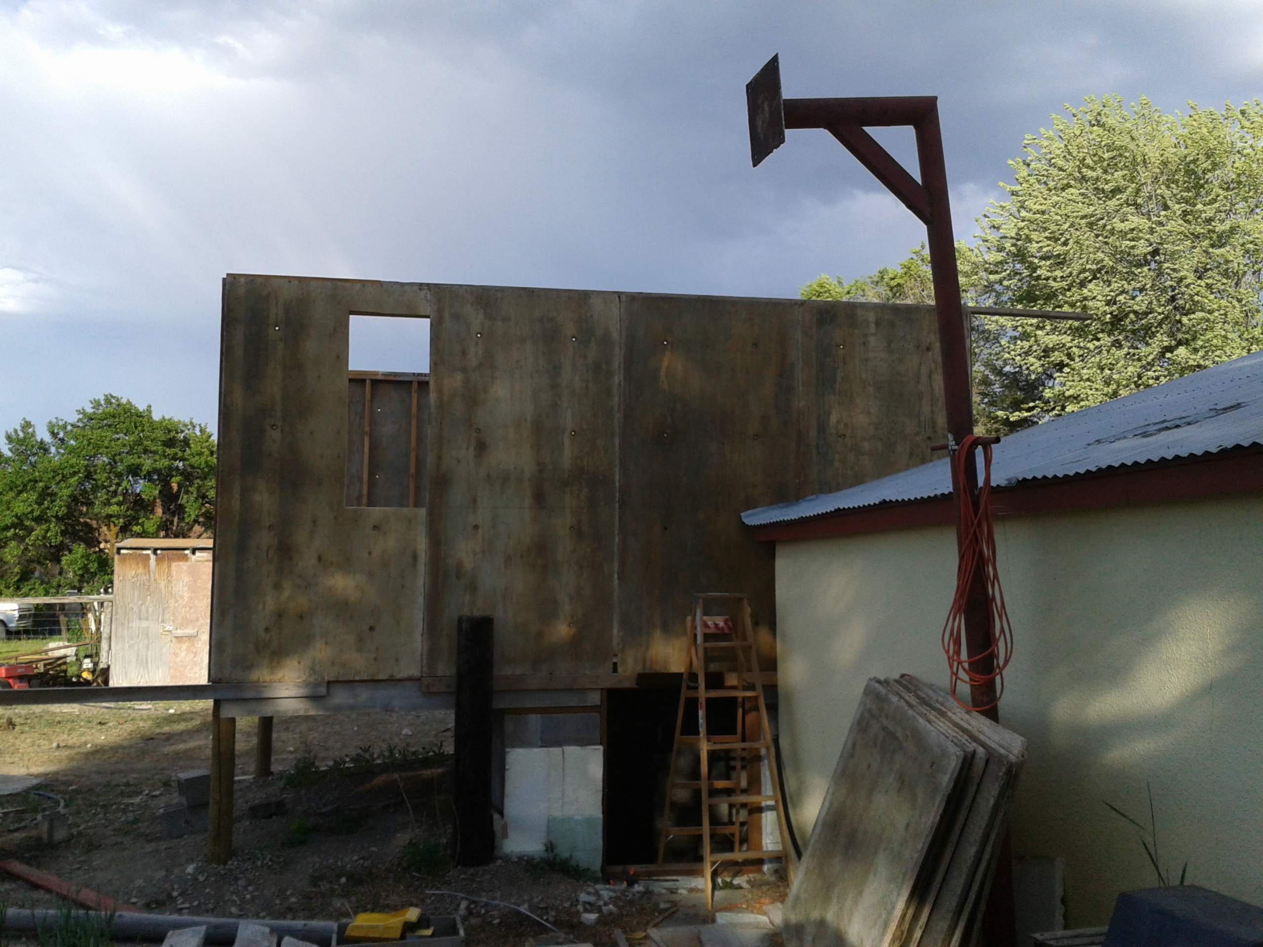

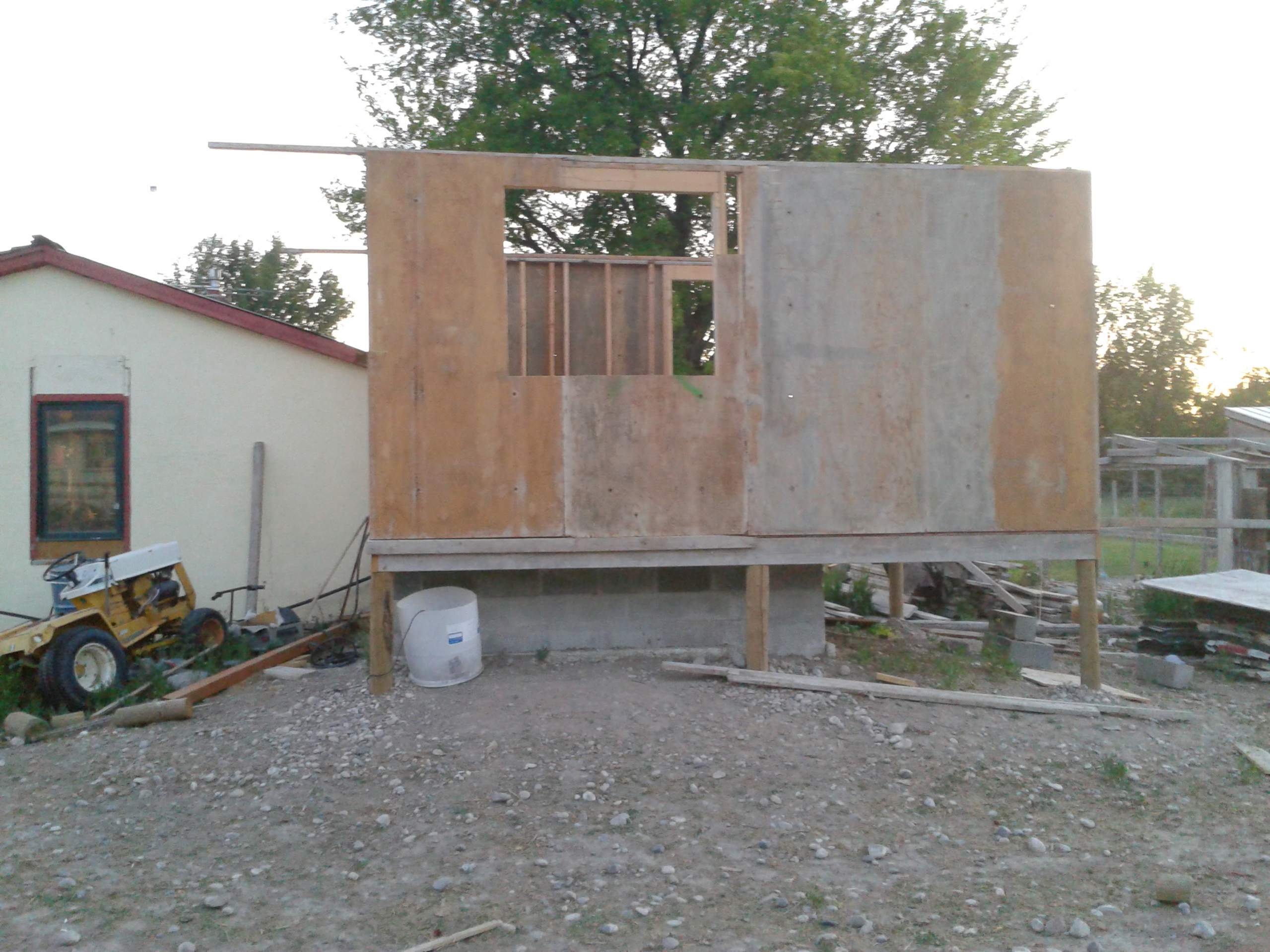

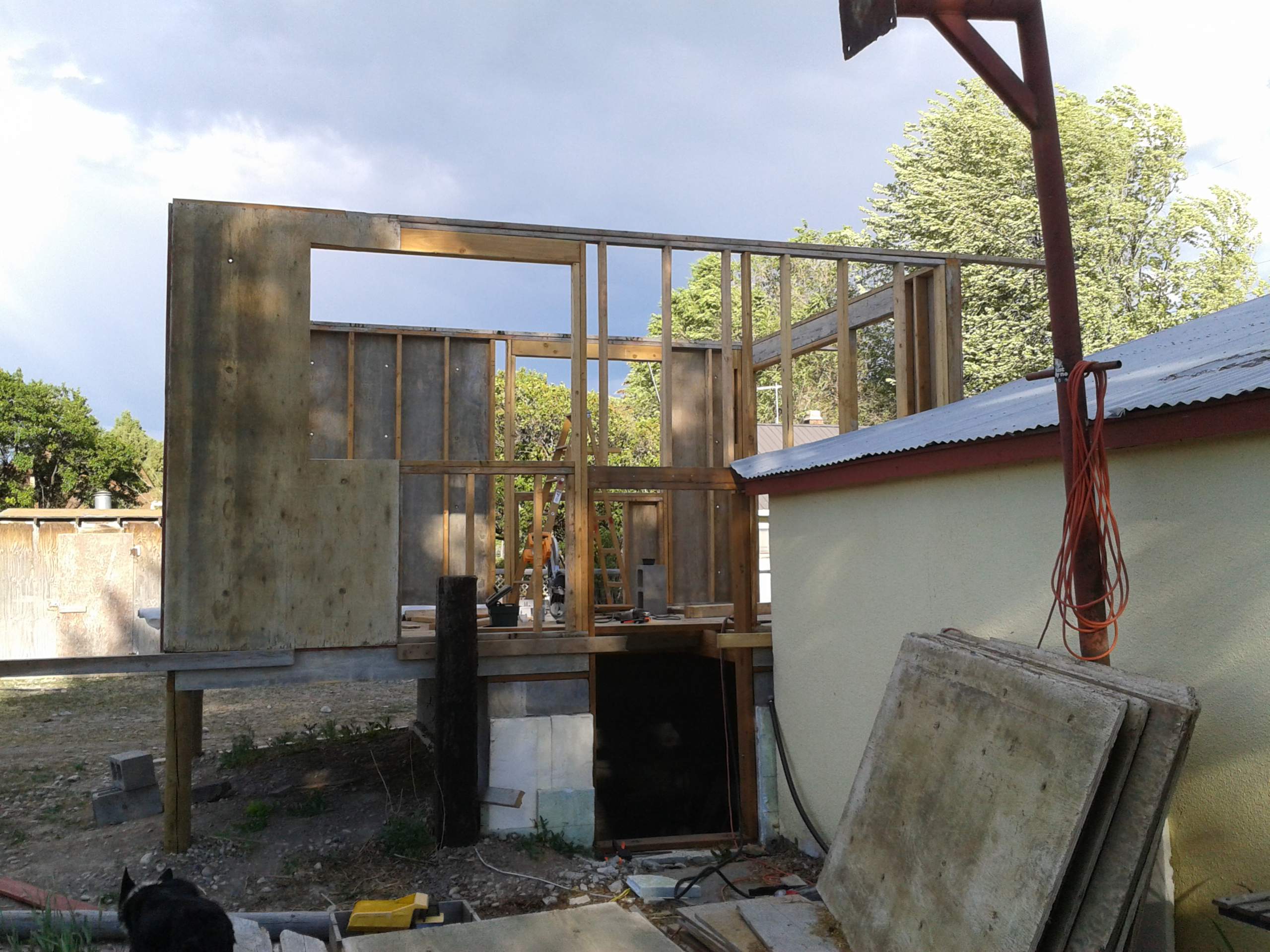

I made some real progress this evening. I got the header made for the downstairs door... this time with 2X6's. No sooner had I made it than I went to lift my 6-year-old daughter into the workshop like I've done dozen times before. I smacked her poor head square on the new header. She was tough about it, though. She was a big help handing me the nailer and other tools while I was holding the sheets of plywood in place ready to nail.
I also got most of the outer sheeting done. I still have a few bits and pieces to put in around the windows and doors. I'm just tacking them up for now with nails. I'll go back and screw everything in place later. Does anyone know what code is for screwing plywood on the outside of a building? What size screws? How far apart?
See the progress pictures below. I don't know why that first picture turned out so blue. It still shows the progress, though.
I've not seen a schedule for screws, but for nails it's usually 8d common 6" apart at edges, 12" apart everywhere else. Some places actually don't allow screws because they'll sometimes break when the structure tries to rack, where a nail won't. If you're not having it inspected, I'd not worry too much. If you are, then whatever your inspector likes best?
