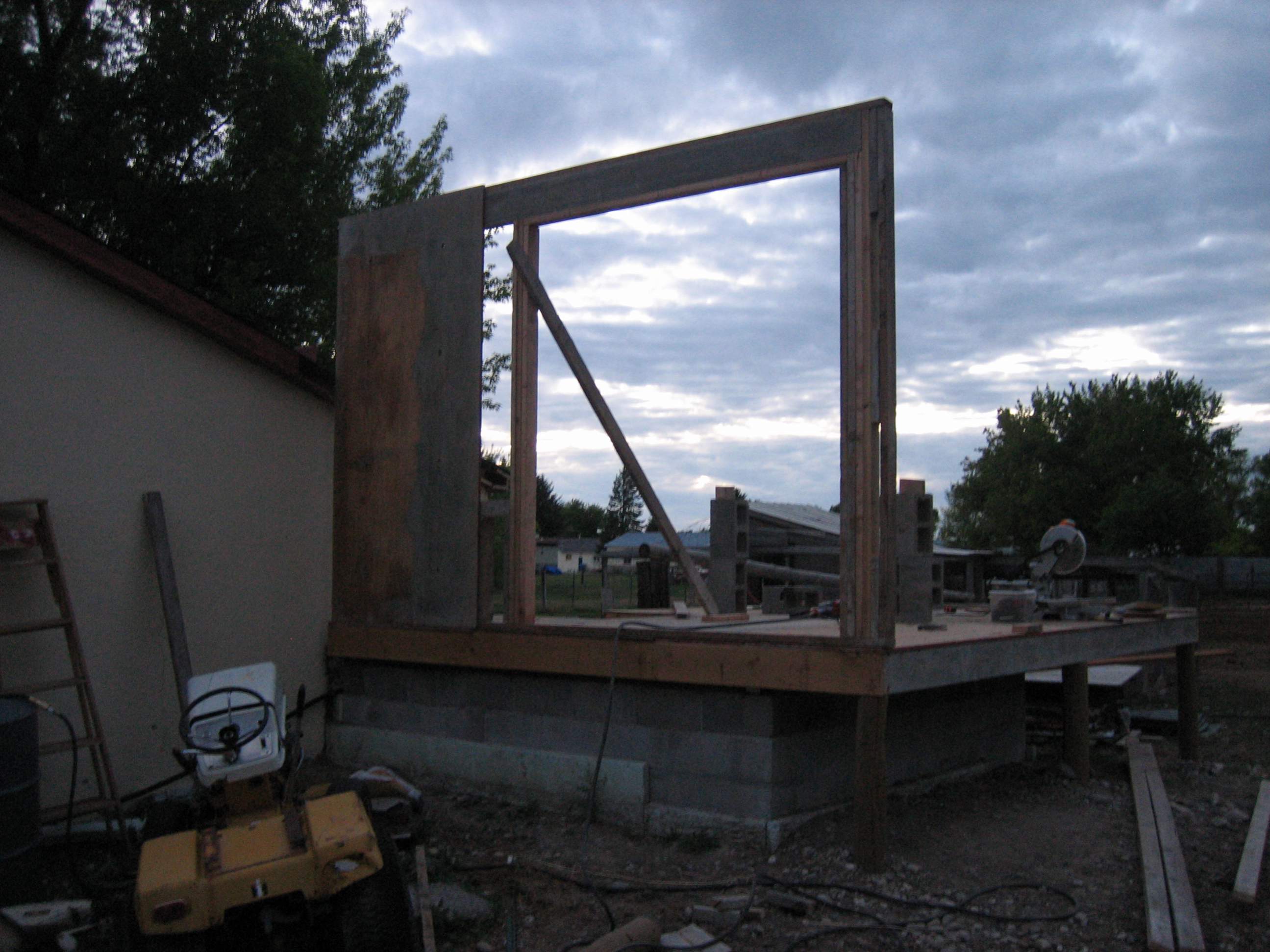

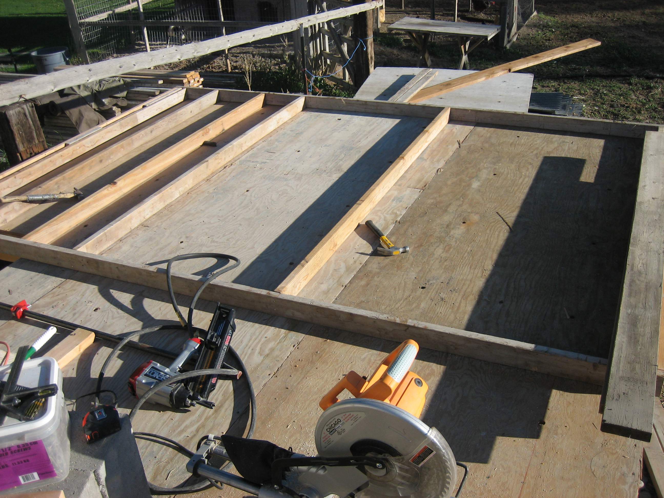

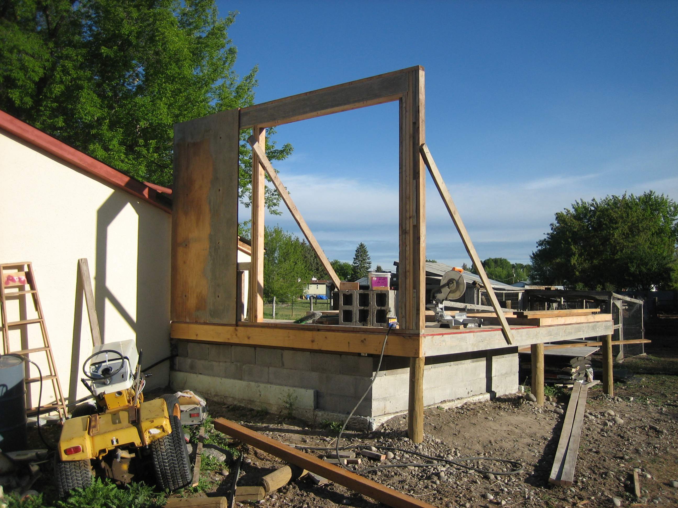

I got the first wall up!! I decided to go ahead and try to lift it myself. It's only a 12' wall, but it took everything I had to get it up and in place. Juggling the wall, the brace, and the nail gun all at the same time to secure it in place was a challenge, too.
The first picture shows the wall assembled on the deck. The second shows how I set the wall up on cinder blocks to get it started. The third picture shows the wall upright. After that last picture I added a second brace and plumbed the wall a little better. By then it was too dark to take pictures.
With that 2X8 header this could be the heaviest wall I have. I'll make the other short wall next and probably stand it up solo, too. I've lined up some help for Saturday that will make standing up the longer walls a little easier.

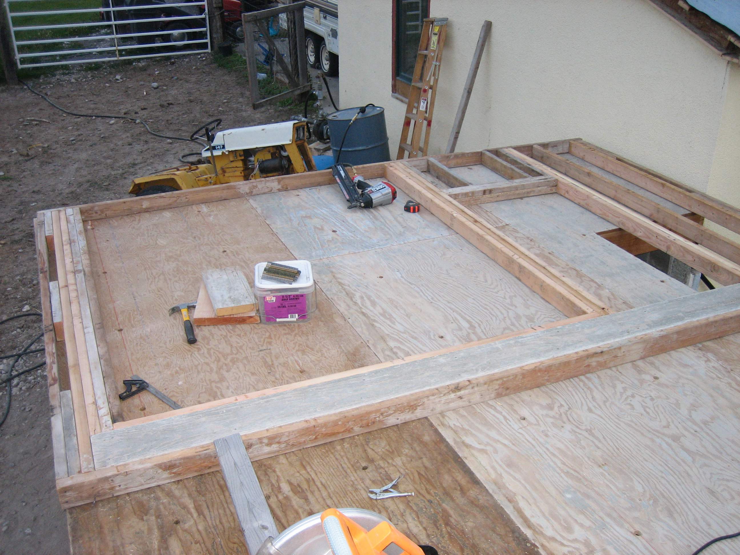

My dog woke me up at about 4:30 this morning. I couldn't get back to sleep, so a soon as I had some daylight I went back out to work on the shop. I got all of the full height studs nailed in place on the second short wall. That's the first picture.
I figured out a trick that most of you probably already knew. In order to keep the wall square while I was building it I put a few small nails into the subfloor at the corners of the wall. That's the second picture. I nailed in the end studs and then tweaked the wall until the diagonal measurements were equal accross all four corners and then put the nails in to keep it there while I built the rest of it. I'll have to pick up some 2X6's for the door and window headers in that wall, and then finish it up tonight.
The third picture is the first wall again after I had added the second brace and with a little more light.
