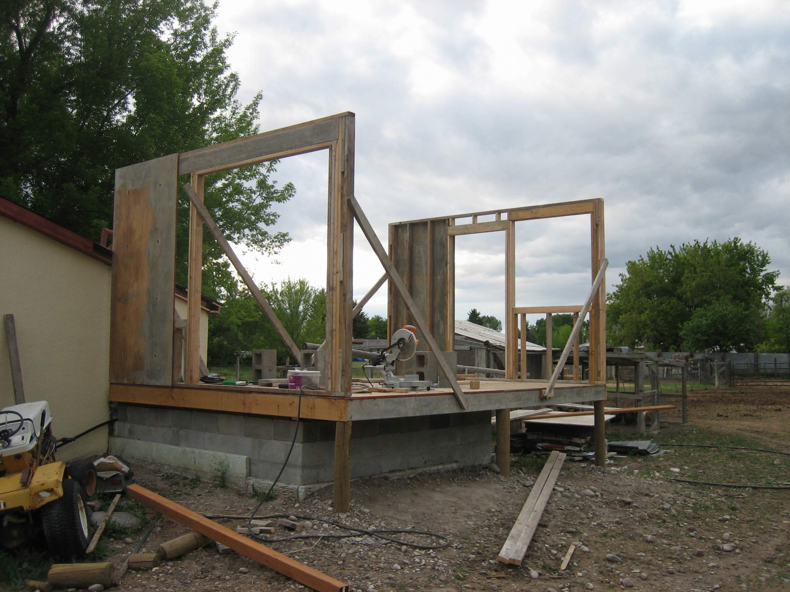

Wall #2 is up.

Wall #2 is up.
Suggestion: Install the door header up tight under the plate, and just frame a 2x4 over the door. That way if you screw up it's easy to modify the height. Not so big a deal on a door, but if it were a 14' wide sliding patio door, you'd be kicking yourself. If you have the header there it's really tough to fix a wrong height. It also gives more solid support to the rafters, which is what you really care about anyway.

That's a good suggestion now that I already have the door framed.
Wall #3 is up. I put it up without the plywood on it so that it would have a little flexibility to fit between the existing walls. I also left out the window header. That wall was a breeze to stand up compared to the other two.
If I get time in the morning, I'll take better pics. For now I've earned a good night's sleep.
