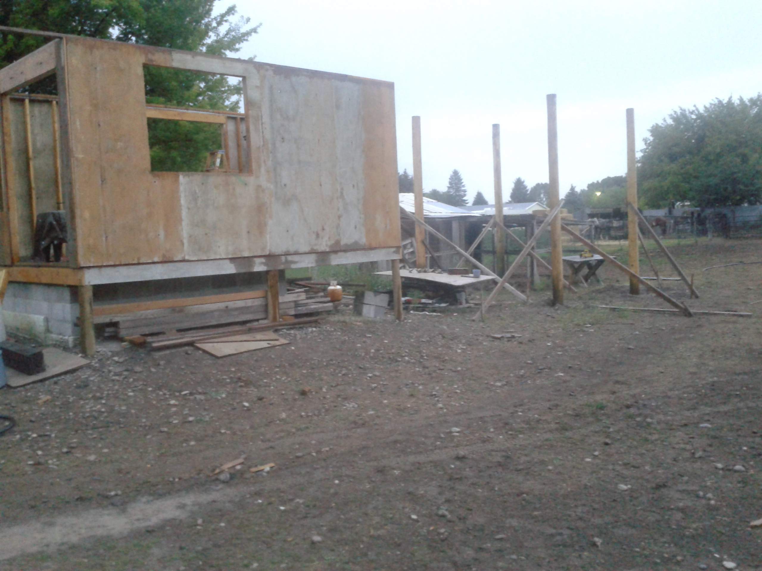

My poles for the overhang are now set. I appologize in advance for the poor quality picture. The lighting was poor by the time I took the picture. I had a few challenges when digging the holes. We've been pretty dry, and the dirt was hard. Then, at one point I stuck the auger so hard that it took an 8' tube and a hydraulic jack to get it out of the ground. I was fighting the weather all day. It rained off and on. A few of my bags of concrete had started to set up because they got wet from the rain. I finally put on a jacket and did the last few poles in the rain. I'm pleased with the progress for today. I was afraid that I'd only get a couple of the poles set today... especially after some of the drawbacks.
One note on technique. In order to get the tops of the posts where I wanted them, I used a laser level to put a line down the top of the walls of the workshop. Then I plumbed the post and moved it around until the red laser dot was where I wanted it on the post. Lucky for me I realized before I set the first post that this technique only works if I set the poles furthest away first. Otherwise the poles closer to the wall obstruct the dot and there's no reference to line up the pole furthest away.
