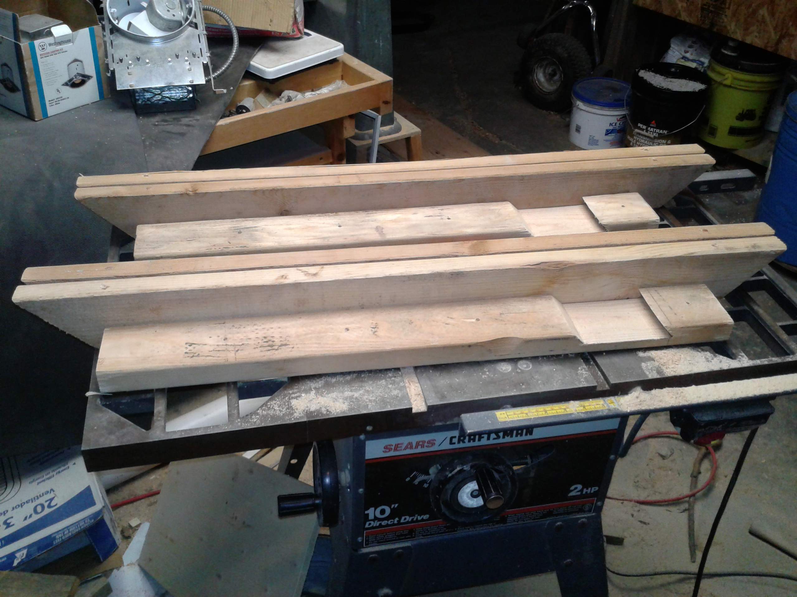

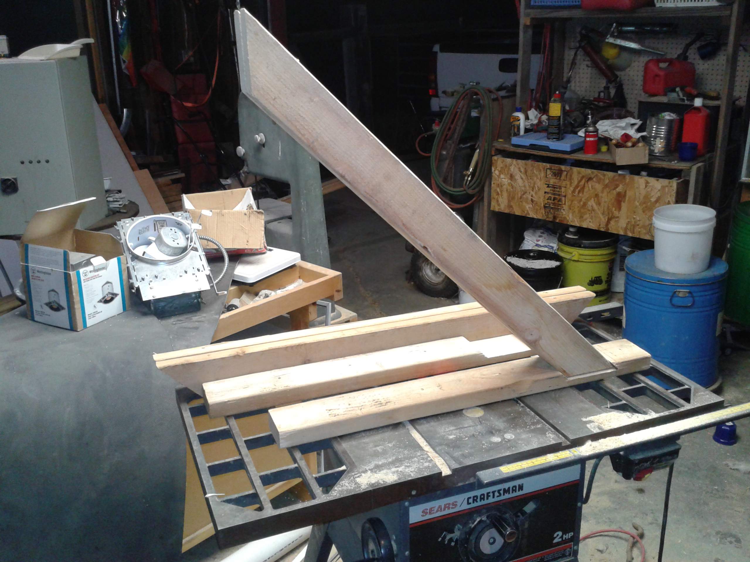

I already had the 2X10's that I'm using for the rafters before I even started construction. That's one of the reasons that I'm going with so wide of an overhang... The 2X10's are 10' long.
On another note, I've made some picture worthy progress. I cut out the braces that I'm going to put on the north wall off the shop to hold up the beams for the overhang roof. The first picture is the pieces cut out, and the second picture shows how the assembly will go together.

I figured you already had the material for the rafters. Don't skimp on the gussets (both sides), use plenty of quality construction adhesive and screw the dickens out of it.
My brother built a barn in the early 70's. I was barely a teen and helped him set the rafters (he was my legal guardian - so it was more like slave labor, but that's a whole other thread). He skimped on the number of rafters, lumber size, the gussets were maybe 6"x6", used white glue and roofing nails. Lucky they didn't collapse on us when we installed them - too flimsy!
Ten years later it collapsed during a snow fall. The rafters failed. Since I didn't get along with my brother at that point in our lives, I might have laughed at his misfortune.
Looks like you are making progress!
