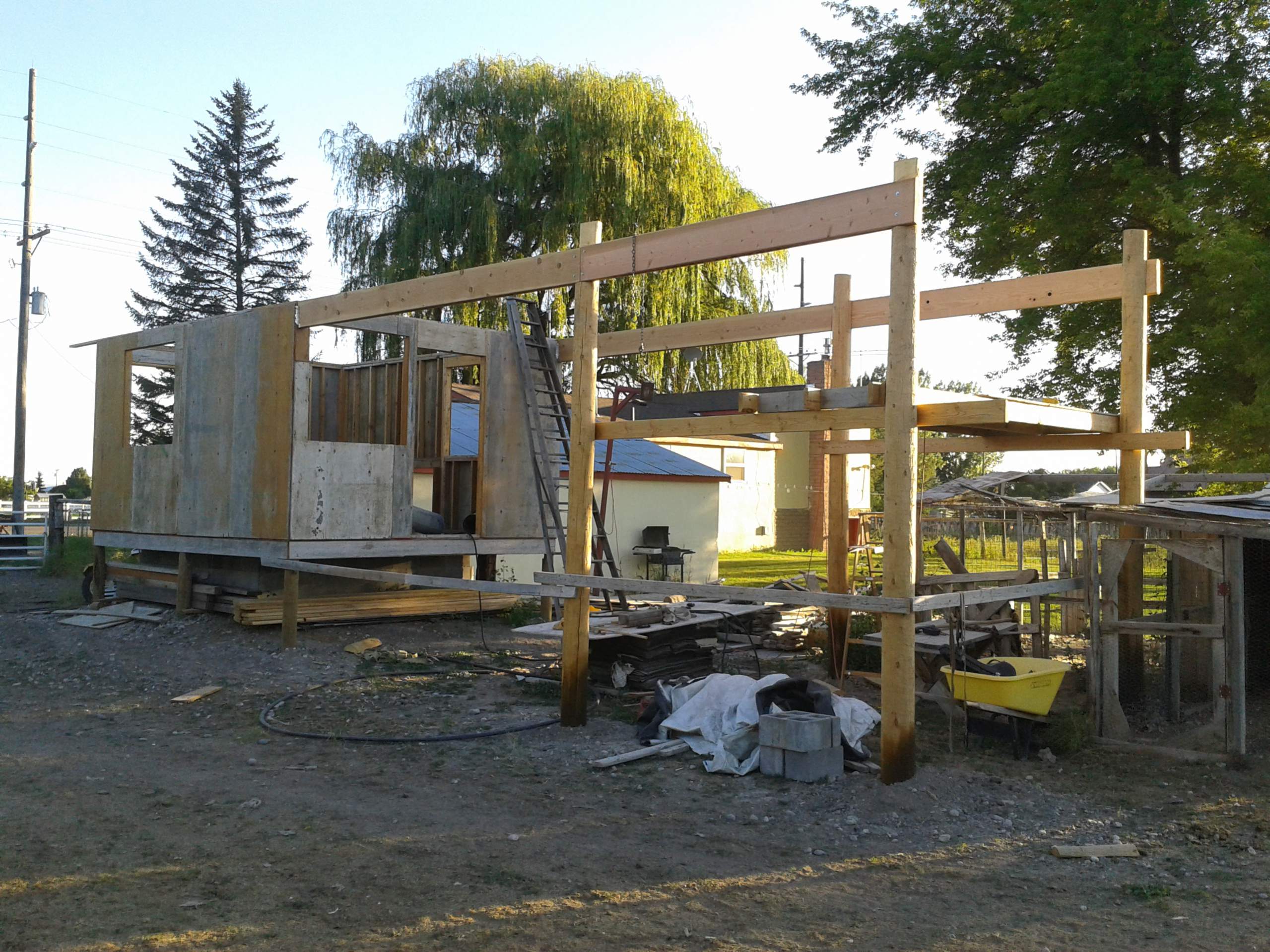

I got the notches cut in the top of the poles to accept the 2X12 beams. I took a page out of Motor Seven's book and cut the notches with a chainsaw. You can see the temporary platform I built to stand on while I marked the location with a laser level and made the cuts. It was a little hairy being up that high leaning over the edge running the chainsaw. I'm glad to have that part done.
I need to pick up some brackets today to hang the shop side of the beams. Are regular metal brackets going to be enough to hold the beams up? Is there some simple overkill that I can add to the design?
   / Root Cellar Remodel, Split Level Storage, Shop, Shed Pole Building on a Foundation #168
A simple way to support that beam where it meets the shop would be to mount a 2x4 on the exterior of the shop wall for the beam to rest on. Most likely it would be even cheaper than heavy metal brackets.
MarkV

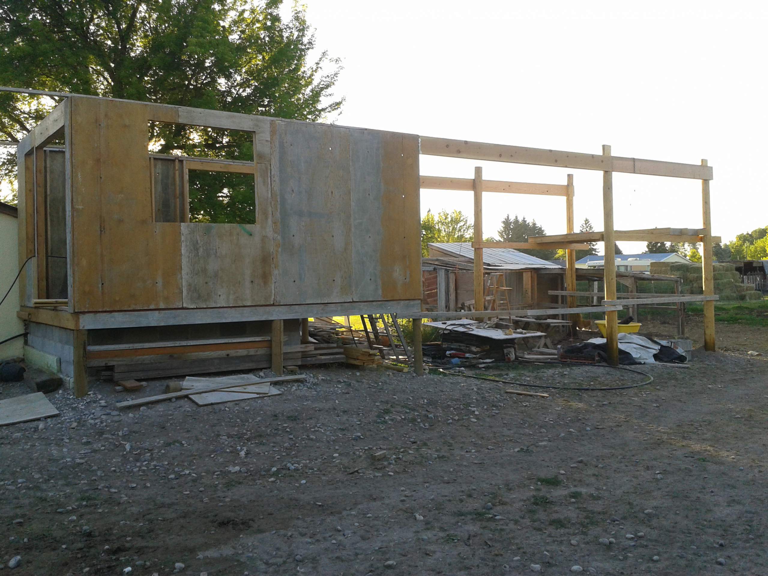

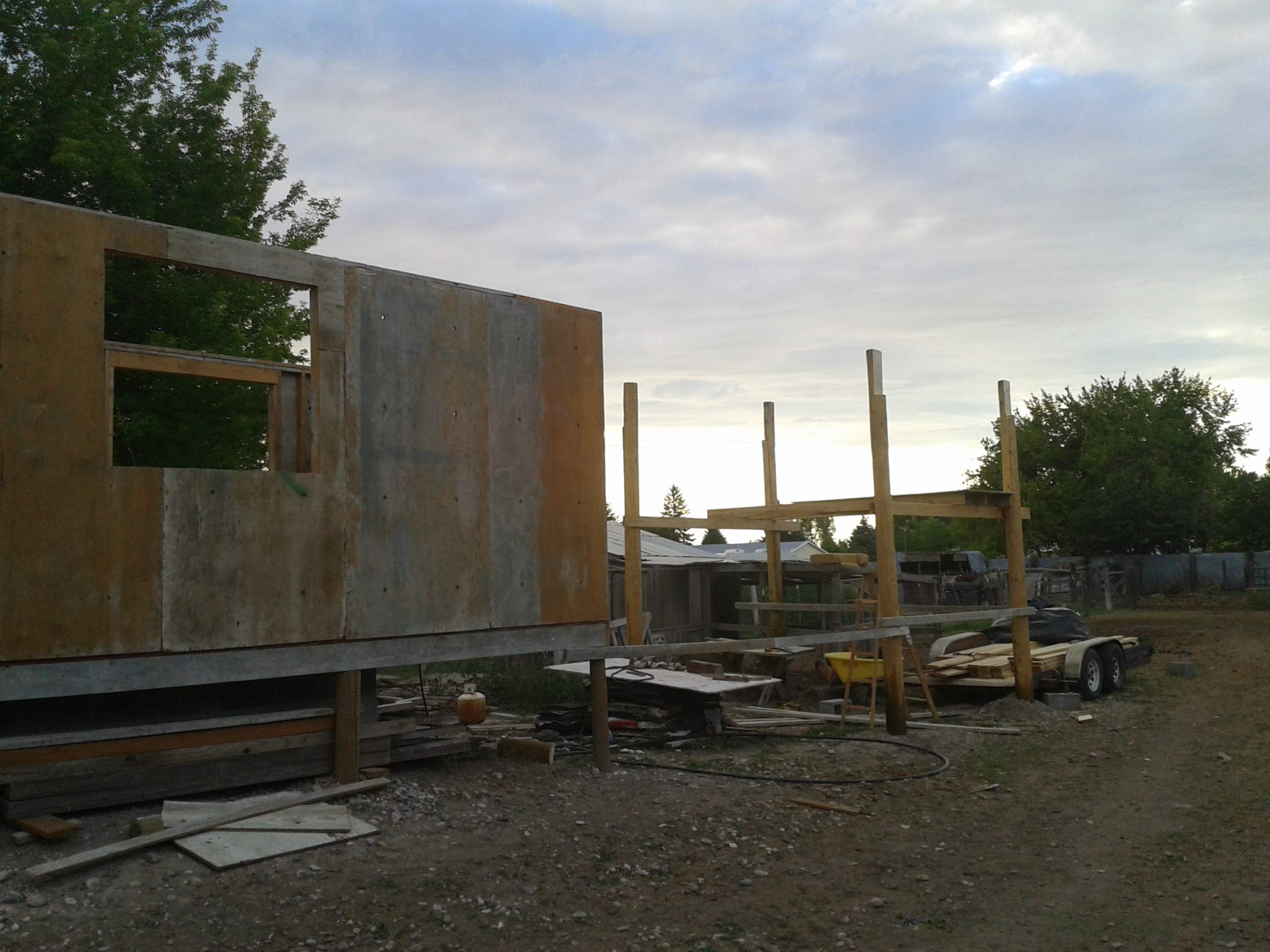

The beams are in place and I'm ready for joists and rafters.
It may take me a while to cut out all the rafters.
   / Root Cellar Remodel, Split Level Storage, Shop, Shed Pole Building on a Foundation #170
From the photo it looks like the longest span of your new beam is held by a single joist hanger. When you add ceiling joists, ceiling finish, rafters, sheathing and roofing material it is more than I would want to trust a light weight hanger to hold.
MarkV
