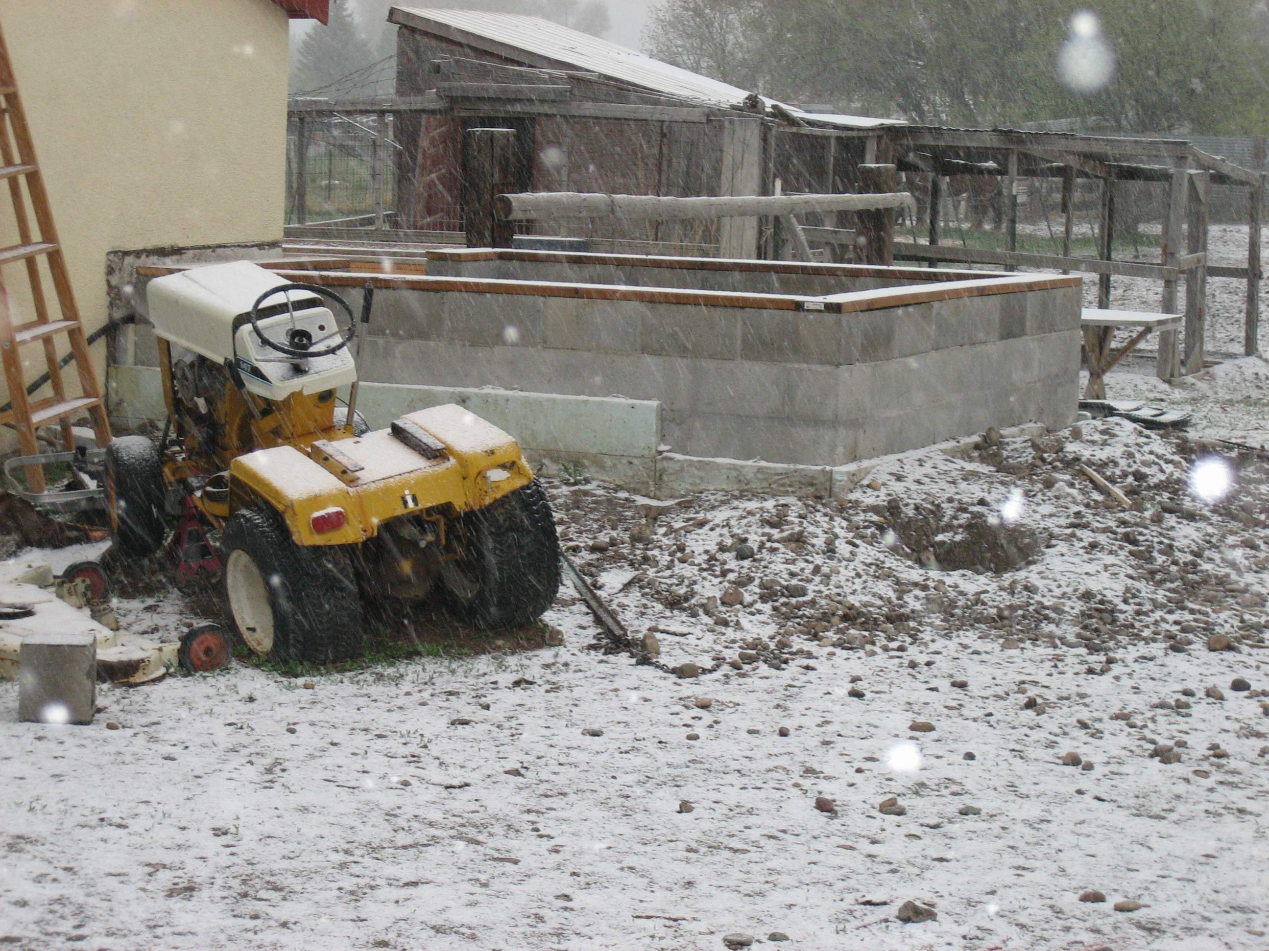

We got snow. I took this picture this morning when the snow had just started. It's been snowing steadily every since.
I guess it's a good thing I'm not in a hurry to get this thing finished.

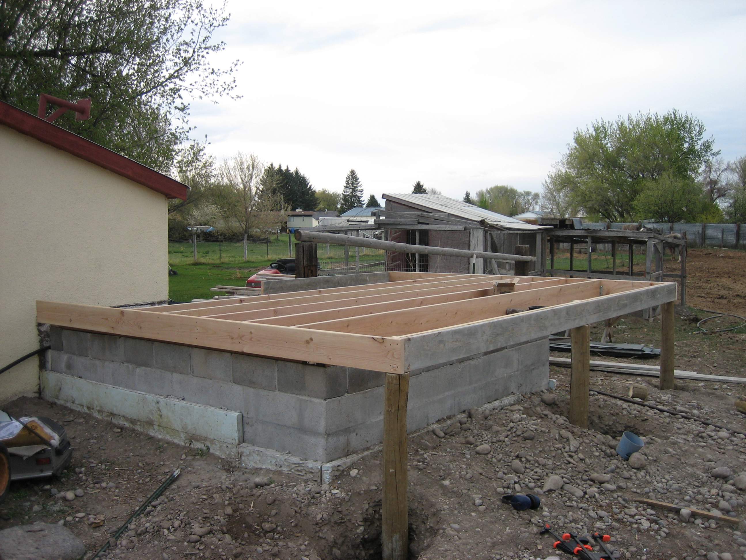

Today I planted the corner posts. That process involved framing most of the floor. I put in any of the full floor joists that sat on the old cellar walls. Then I attached the rim joists. This framework provided the support to attach the post to so I could put concrete in the holes. I used 6 bags accross 4 holes. This left each hole not quite half full.
I'll go back probably on Monday and fill in the rest of the holes with the dirt that came out of them. After that I'll finish framing the floor. The transition between foundation and framing is a little blurred since I had to start some of the framing in order to finish the pole part of the foundation. Regardless, I think I am now done with foundation work and I am officially into the framing phase.
