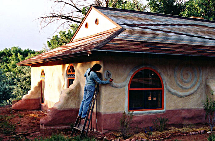

I found some pics - some good, some bad and some ugly :)
edit: sorry for the double pic post
This one is my favorite...
That pattern actually looks kind of cool. All I could come up with before I saw that were different stripes.
I'm inspired, now.
Mrs. Iplayfarmer may have an opinion. I'll have to get a few options to present and ask her opinion. Even if she doesn't have an opinion, I'll get points for asking.
