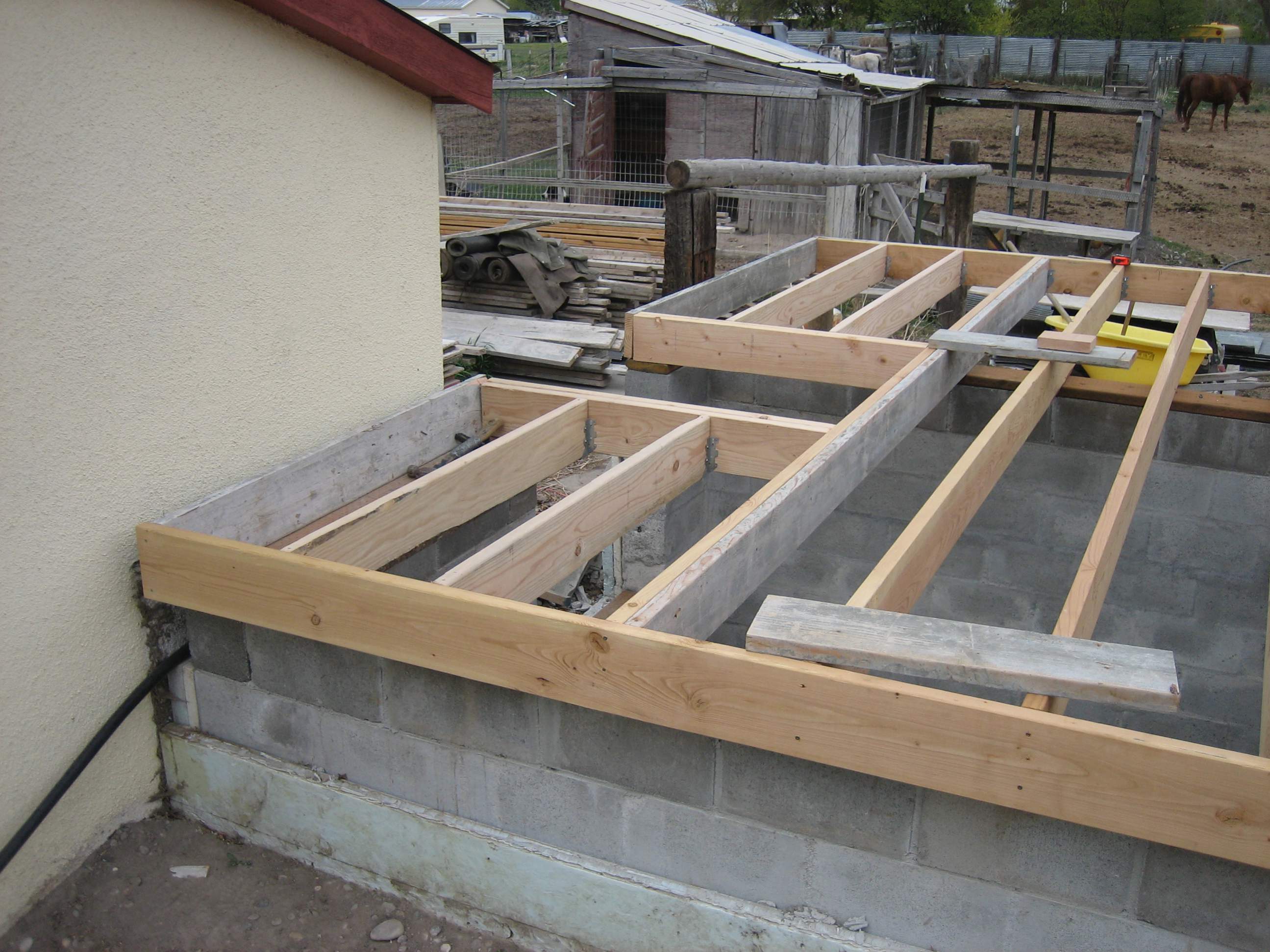

I finished the floor framing today. I thought about putting the subfloor on, but after I get my framing nailer back I'm going to put in some blocking. That will likely be easier with the subfloor off. I'm also considering putting in the floor insulation before I put the subfloor on.
I would wait to insulate until you get your building weather tight. If rain gets to your insulation, if it doesn't pull it down, it will hold water and most likely mold the wood. Wet insulation is worthless insulation IMHO.
Framing job looks great.
Okay. How big of a deal is the moisture barrier on the insulation? The reason I ask is because the reason I was thinking of installing the insulation first is so that I could put the moisture barrier side of the insulation up.
The downstairs will not be heated, but I hope that it stays above freezing due to the natural temperature regulating tendencies of being in the ground. The upstairs will be heated periodically. Is it going to be a big deal if I put the insulation in "upsidedown" from the basement side later?
