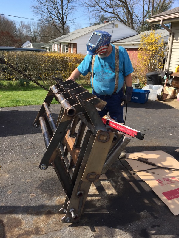

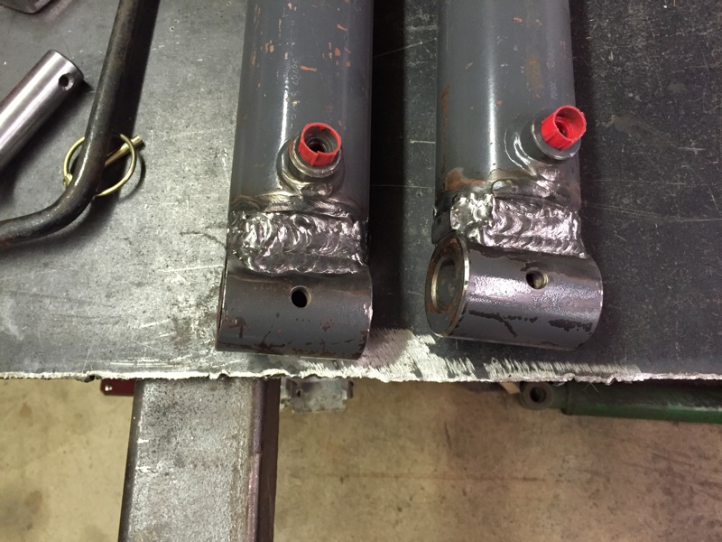

Got the re-welding of the base bushing on the base of the first cylinder done yesterday and got the second one tacked up with the root passes done, finished that this morning after I got back from having U. B. do a couple of stick welds at his place on the lower bar with the rake teeth:
Like the look of these welds on the cylinders a little better than my first attempt:

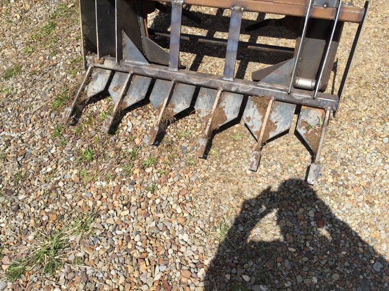

While I had it off I decided to give the rake portion a little test, even though it's still kinda wet here. Seems to work pretty good ...
First dirt ... :D:

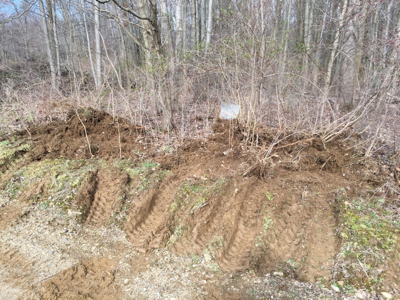

Did a little work along the driveway where the jungle was trying to encroach:
Multiflora rose ... we have quite a bit of it:

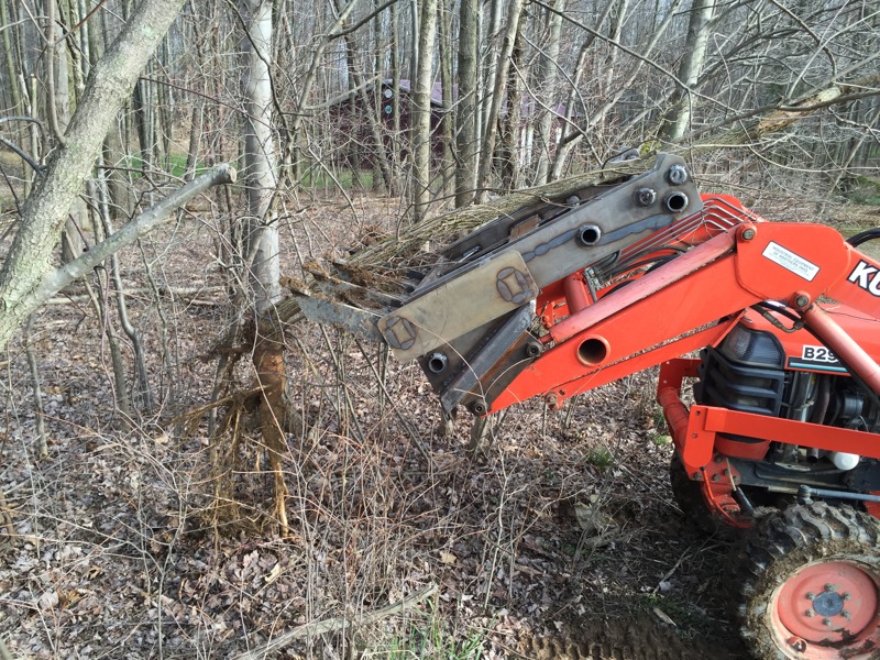

Even works for decent sized saplings ... :D:
