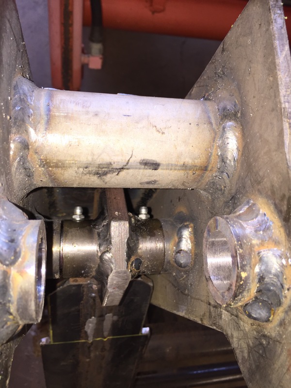

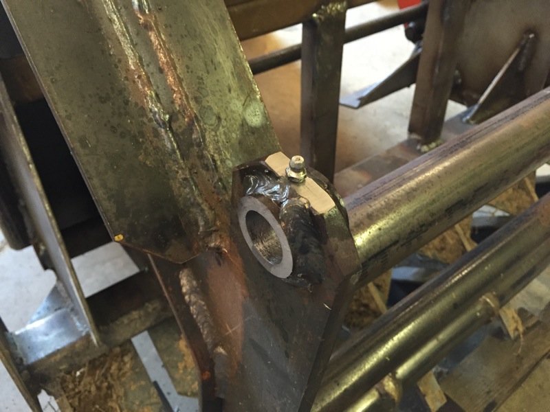

Six holes drilled and tapped, grease fittings installed:

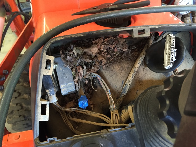

#130
Pulled the instrument cluster to see if I could locate a power source and a location to the mount the relay. Looks like someone considered using it as a nesting spot at some point:
