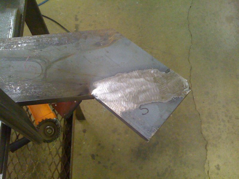

These four 1/4" x 6" plates will form the towers/masts into which the upper jaw will mount. They were tacked together in pairs for machining/drilling:
In hindsight it would have been better had I tacked all four of them together - which would have left no chance of any variation in hole placement, even if a bit unwieldy ...
As it turned out, one of the series of holes was slightly off between the two sets ... no biggie: grind a little out and fill it with weld ... :D

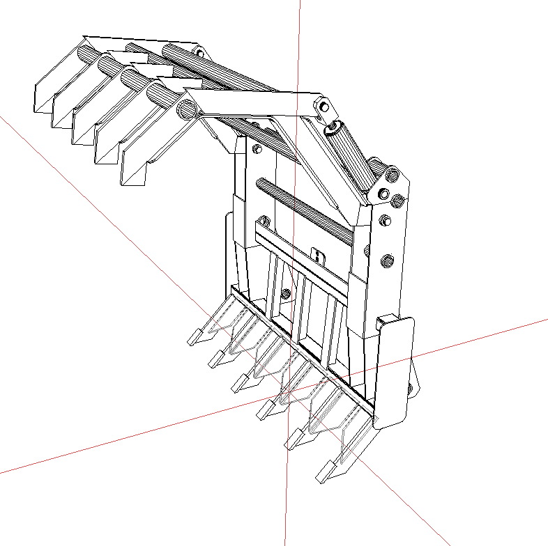

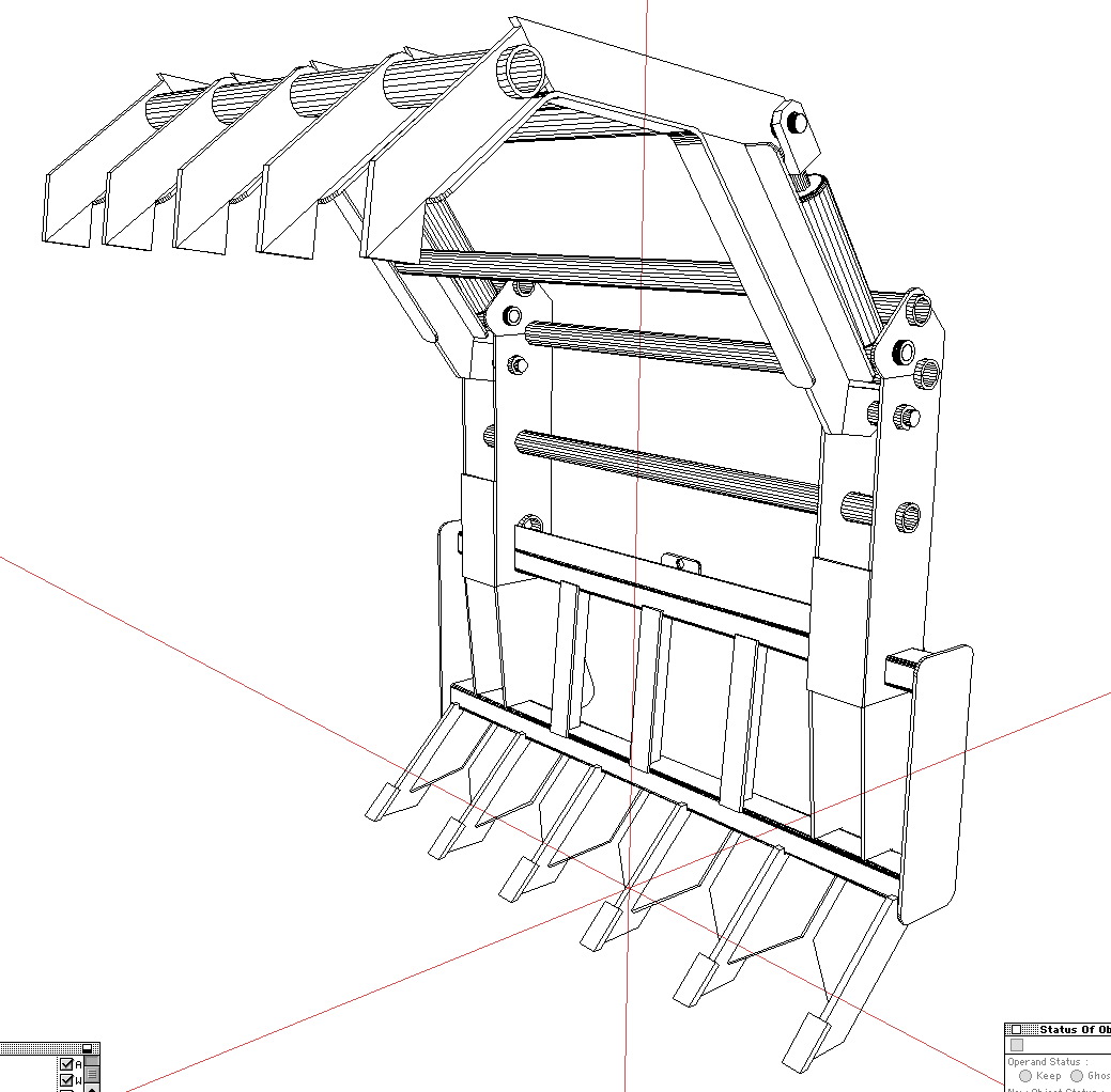

I have the same W.R Long grapple, only wider. The one suggestion I have would have is to add an additional angle to the lower jaw. It appears from your drawing that it is straight.
It would increase your brush carrying capacity, put the "spades" on the lower jaw in a better rooting position and give you a better hold on whatever you are carrying. I handle lots of logs and for ease of picking them up it's a great design. Just drive up to the log, give it a little push to make sure it's resting on all the spades and close the grapple. It pulls the log into the lower angle every time.
Here's a photo of what the lower angle looks like. Good luck and nice thread.

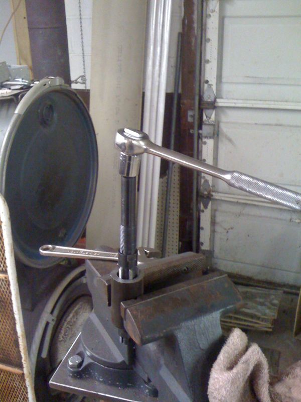

#27
Was having an issue with the bandsaw tracking correctly when I cut the chisels for the lower rake ... so I used the Delta Sharpening Center to square them up and put an edge on them.
One on the right is straight out of the saw, the one left has been squared and sharpened ... you could shave with it :D:
Yes ... I used your pictures along with NHBotanut's) when I was laying it out and modeling it :D
The one suggestion I have would have is to add an additional angle to the lower jaw. It appears from your drawing that it is straight. It would increase your brush carrying capacity, put the "spades" on the lower jaw in a better rooting position and give you a better hold on whatever you are carrying.
Interesting that you should mention that ... as that was in the original design from a couple years ago ... the one I lost in the hard drive crash.
I took it out this time around as I was starting to get a little concerned about overall weight and was looking to economize.

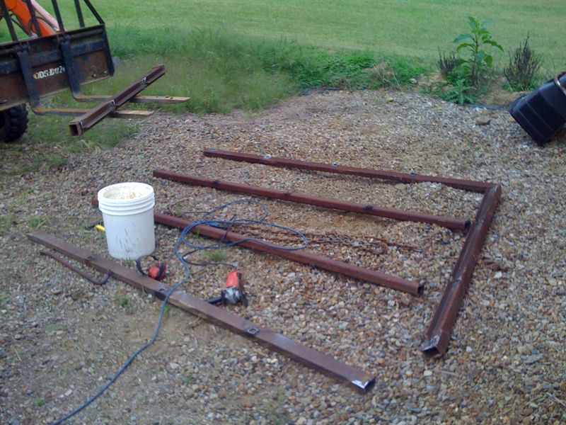

/ Root Rake/Grapple For Kubota B2910
#30
I am blindly gathering parts to make a grapple. I'm still stalled on what the geometry is for the cylinders to close.
Yeah ... that was a bit of a mind flock for me ...
I'll try to post a better explanation of how to do it (locating attachment and pivot points) ... might be a few days though. Having access to a CAD program is helpful in figuring it out ... but it isn't a show stopper if you don't.
In terms of ease of fabrication though, you want to these locations to be easy to find/locate ... example: '... drill the hole for the pin 2" in, and 1" down from the top right corner of the plate ..."

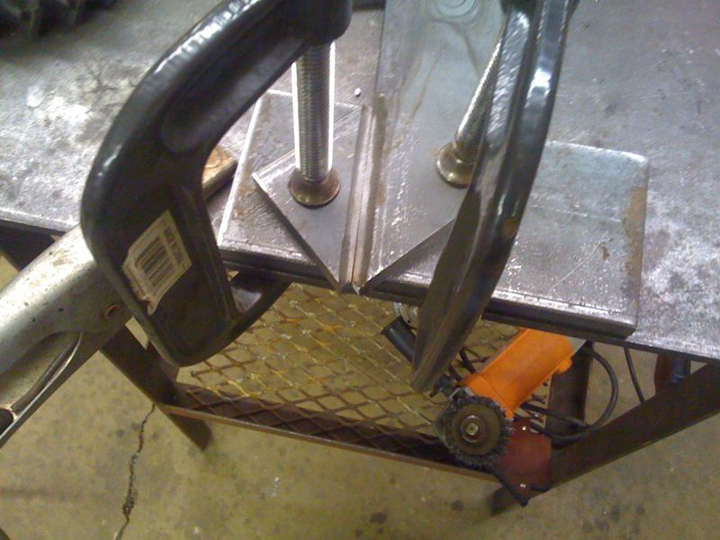

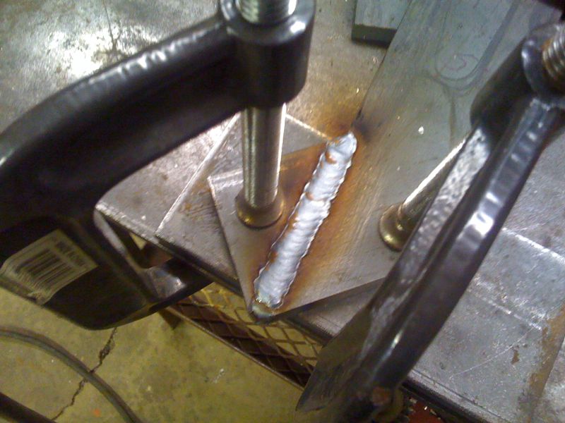

Welding up the arms for the upper jaw.
These were clamped four ways to Sunday to prevent/minimize warping, then welded on the one side and allowed to cool ... then the welds were ground flush and the arms were flipped and re-clamped with the now welded side down, and the unwelded side done ... ensuring it was allowed to fully cool before being unclamped.
The areas to be welded were all beveled and welded in three passes to ensure good penetration.
