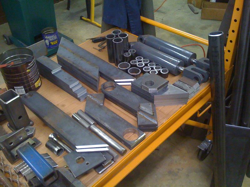

... Got all final welds to the (4) pipes on the upper grapple jaw done earlier ... also bent the 1/4" x 2" flats that are on the inside of the grapple arms and got them tacked into place. I'm pretty pleased with how the bent flats turned out ... it was only my second time using the bender and I was able to make two pieces that were nearly identical. Plus the bender's capacity is only 1/4" x 1 15/16"" ...
After hefting this thing around and it getting heavier and heavier as I added parts I got a little concerned about the weight, so after finishing up for the day I came down to the house and ran some numbers on the total lengths of the materials I used ...
I think I may have a problem ... :D
Just based on my estimates (which doesn't include the wire used to make the welds) it appears that the upper jaw (including the hydraulic cylinders) will weigh around 185 lbs.
I can reduce that somewhat (11 lbs) by removing one (out of 4) of the pipes (an 1 1/2" Schedule 80) ... but will pick some of that weight back up in 1/4" x 2" flat stock that will needed to be added to "capture and contain" the load.

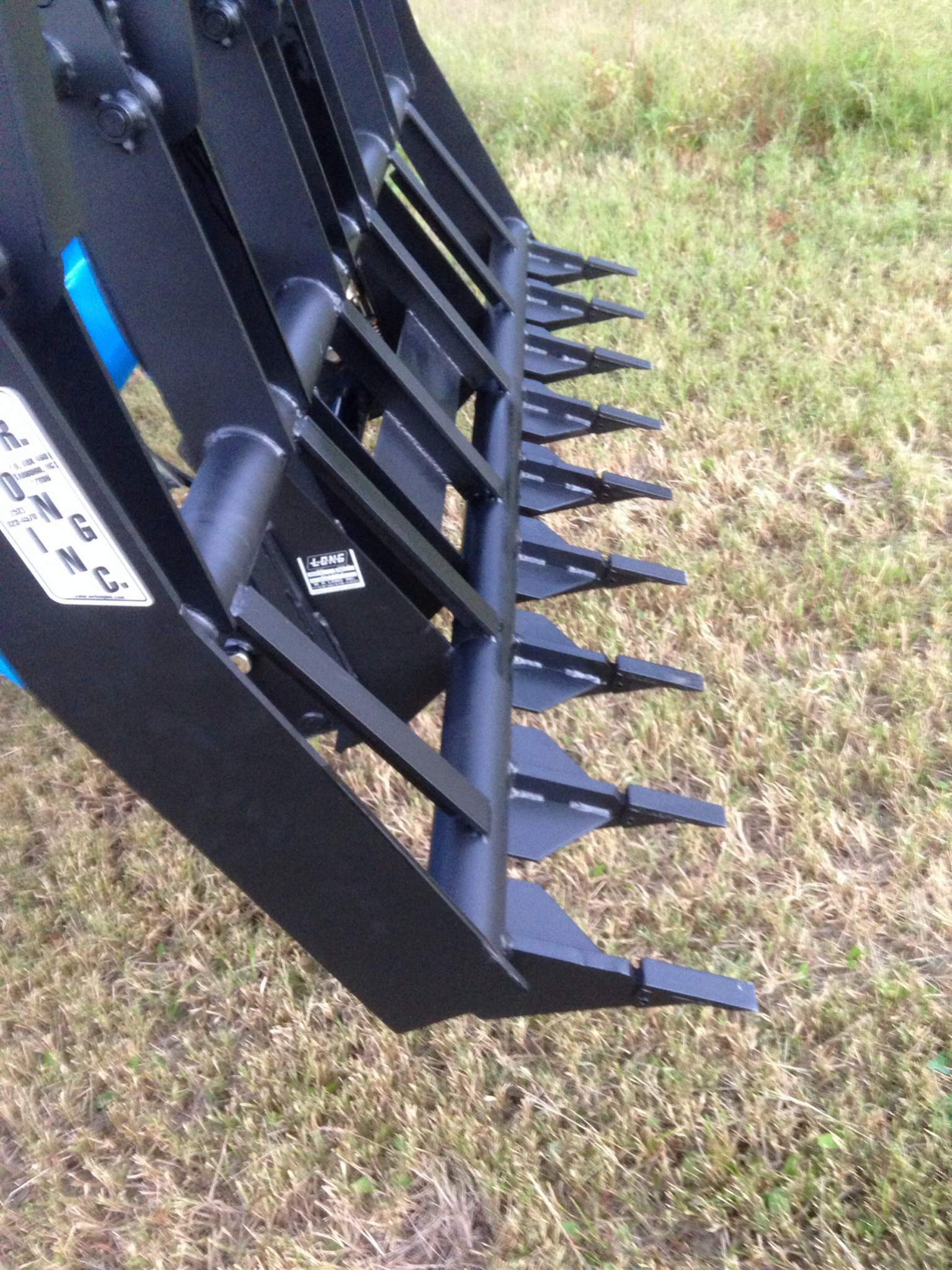

The 48" W. R. Long root rake/grapple I patterned this after has a listed weight of 325 lbs. Some of the discrepancy may be due to using heavier pipe than what Long uses (Schedule 80 vs. Schedule 40)

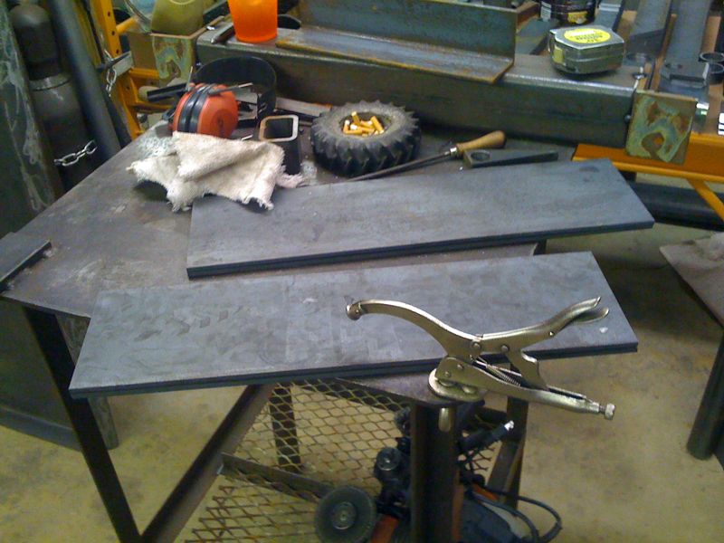

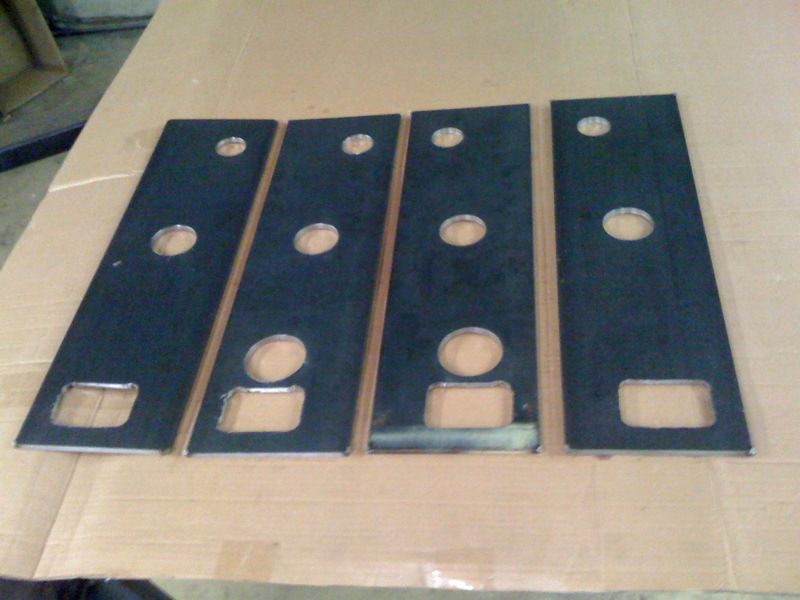

The image below is four pieces of 1/4" plate that were cut with the O/A torch from the 4' x 8' sheet of plate. They will serve as the bottom of the masts/towers for the upper jaw of the grapple and as mounting points for the SSQA attachment plate.
Being cut with the torch, the edges were pretty rough and the size varied a good bit ... so I tack welded them together and then ground them, so that they would be fairly close:
They will provide an additional 20 degrees of roll back (my loader only has 26 degrees of rollback) for a total of 46 degrees.
They still need to have a hole drilled through them for two short (6" ?) pieces of 1 1/2" Schedule 80 pipe. The pipes will tie two plates together (two pairs) and provide some structural reinforcement for the mounting brackets/points for the SSQA plate.

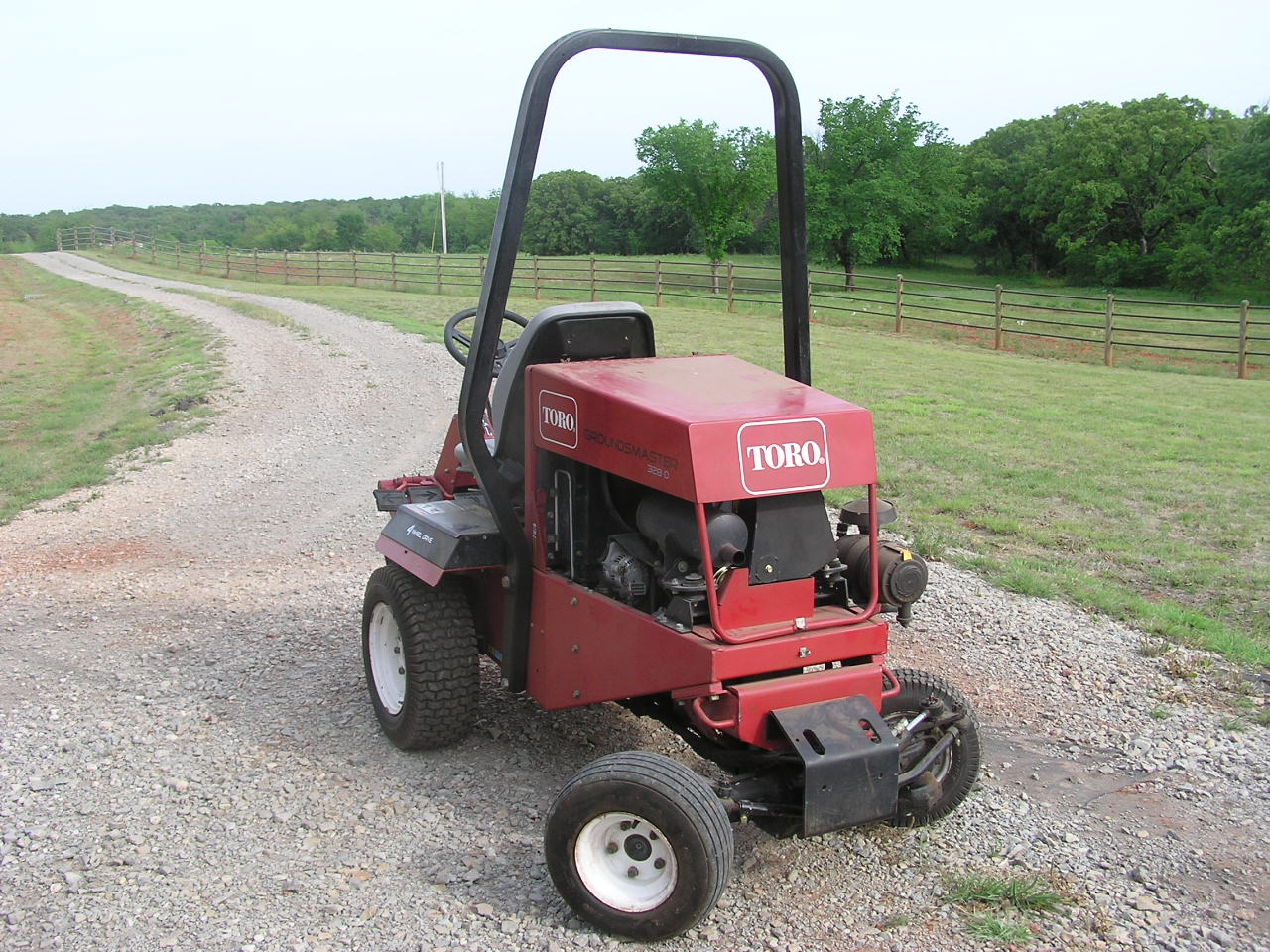

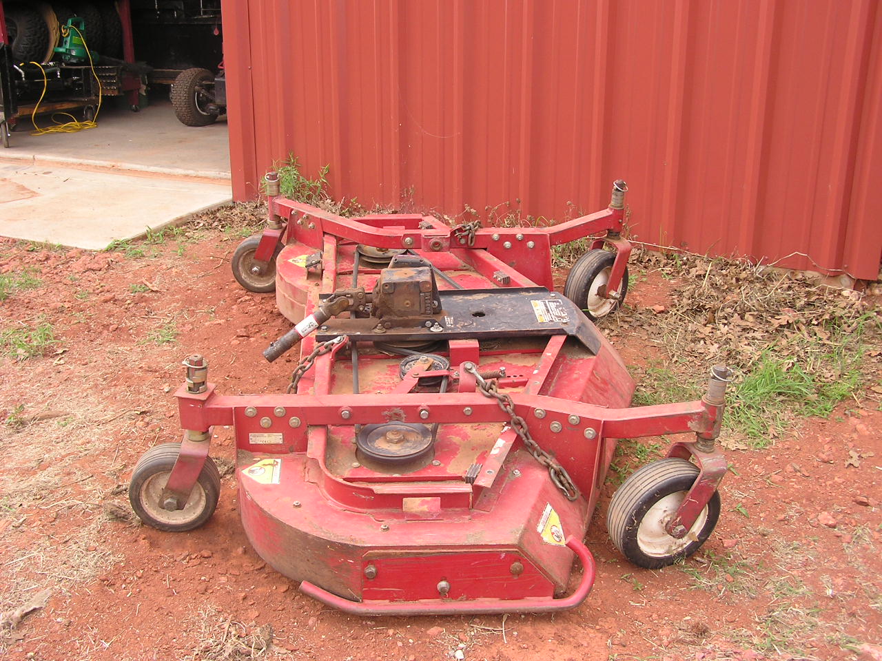

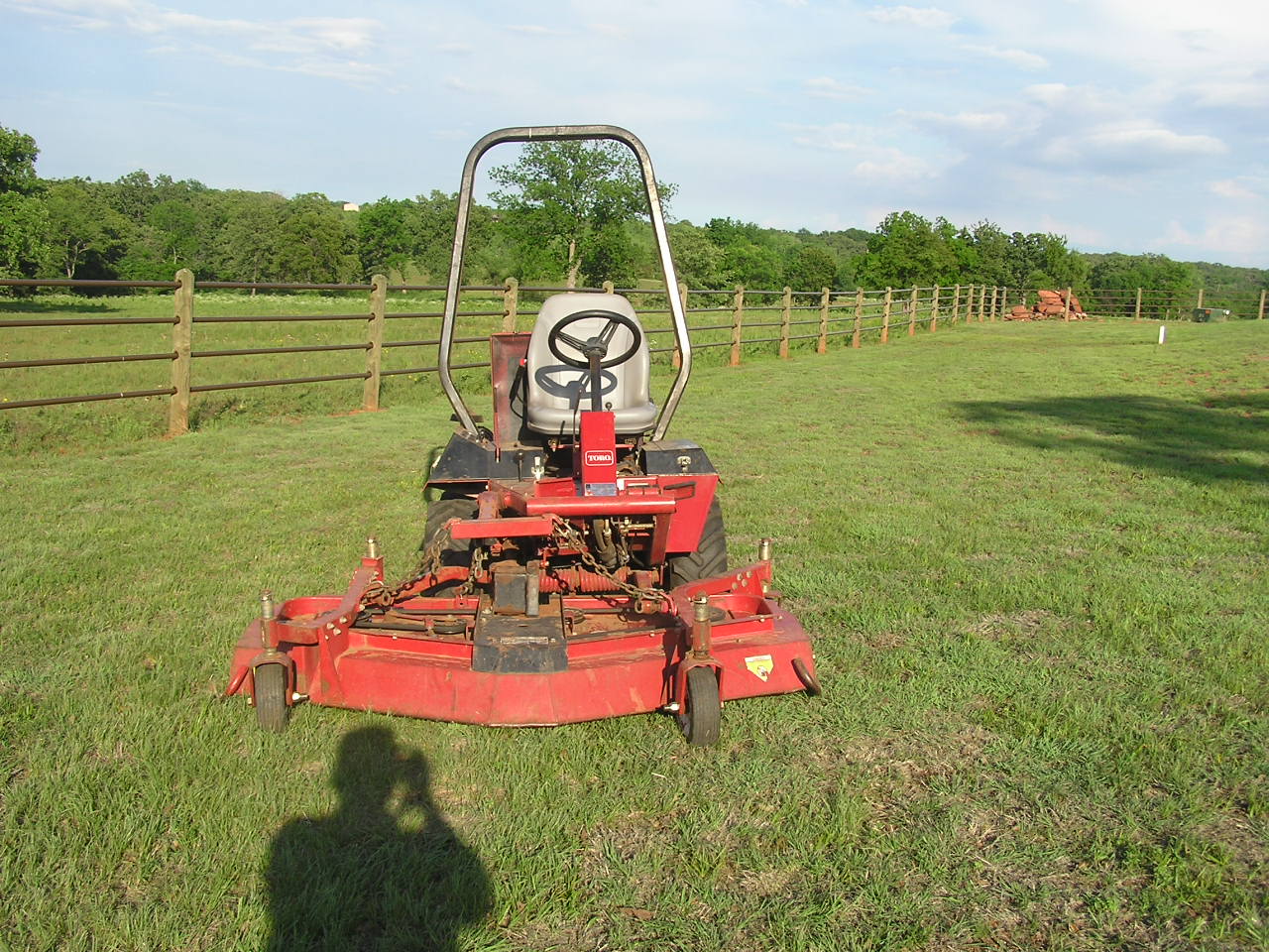

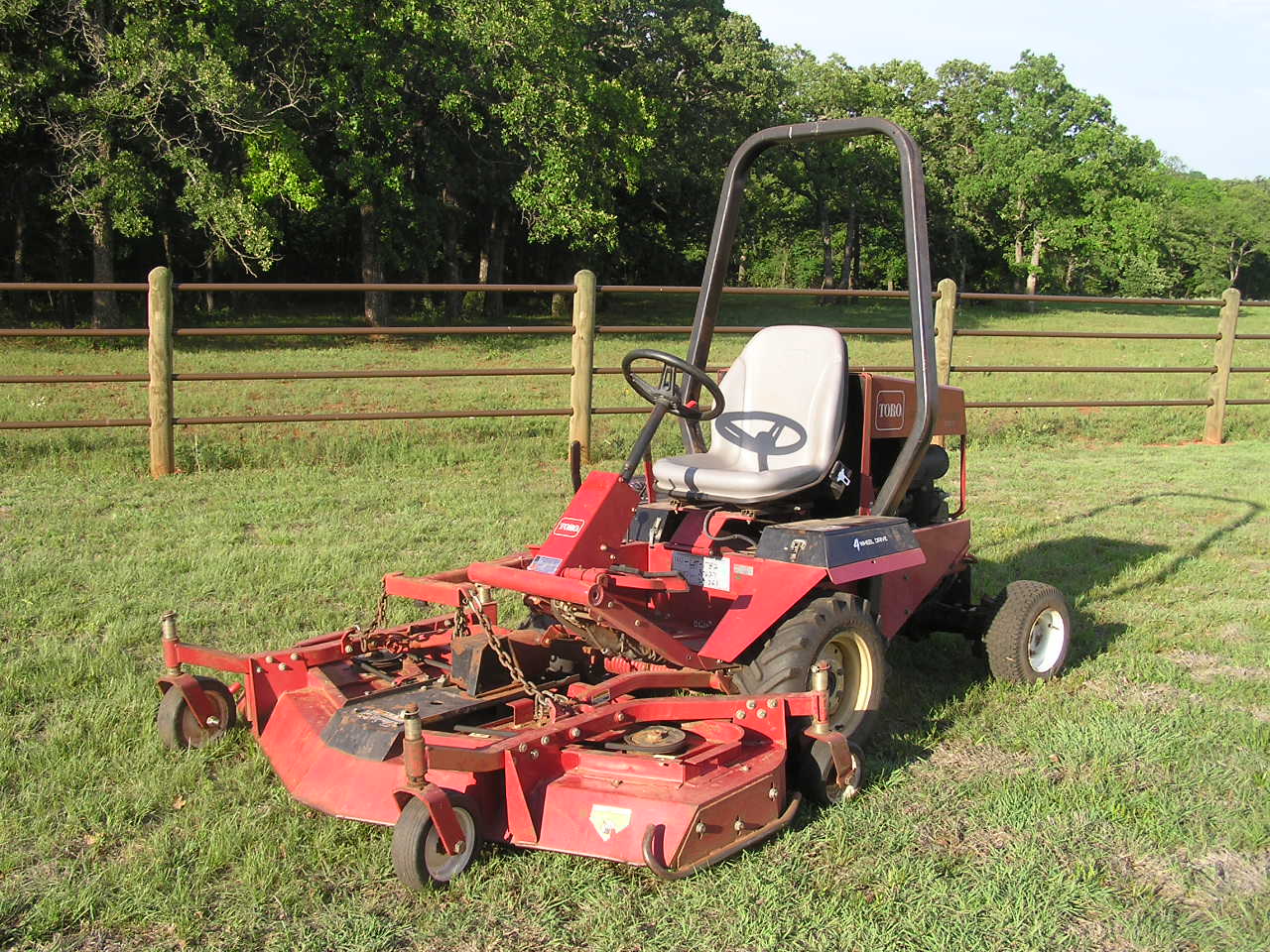

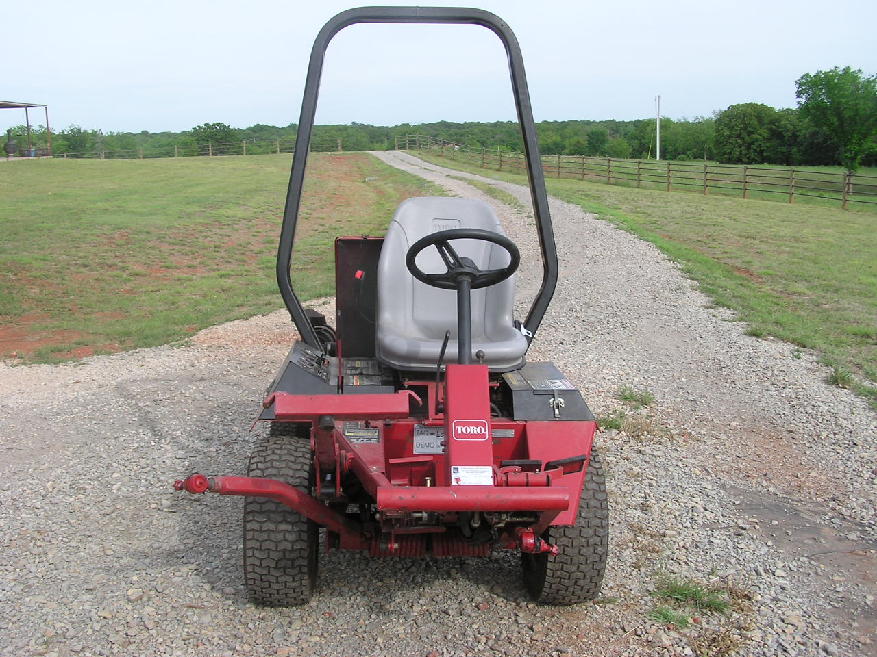

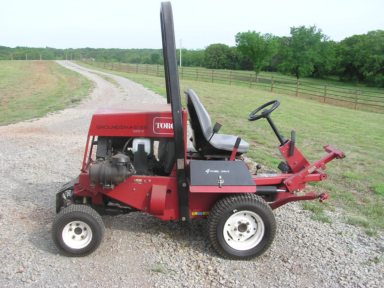

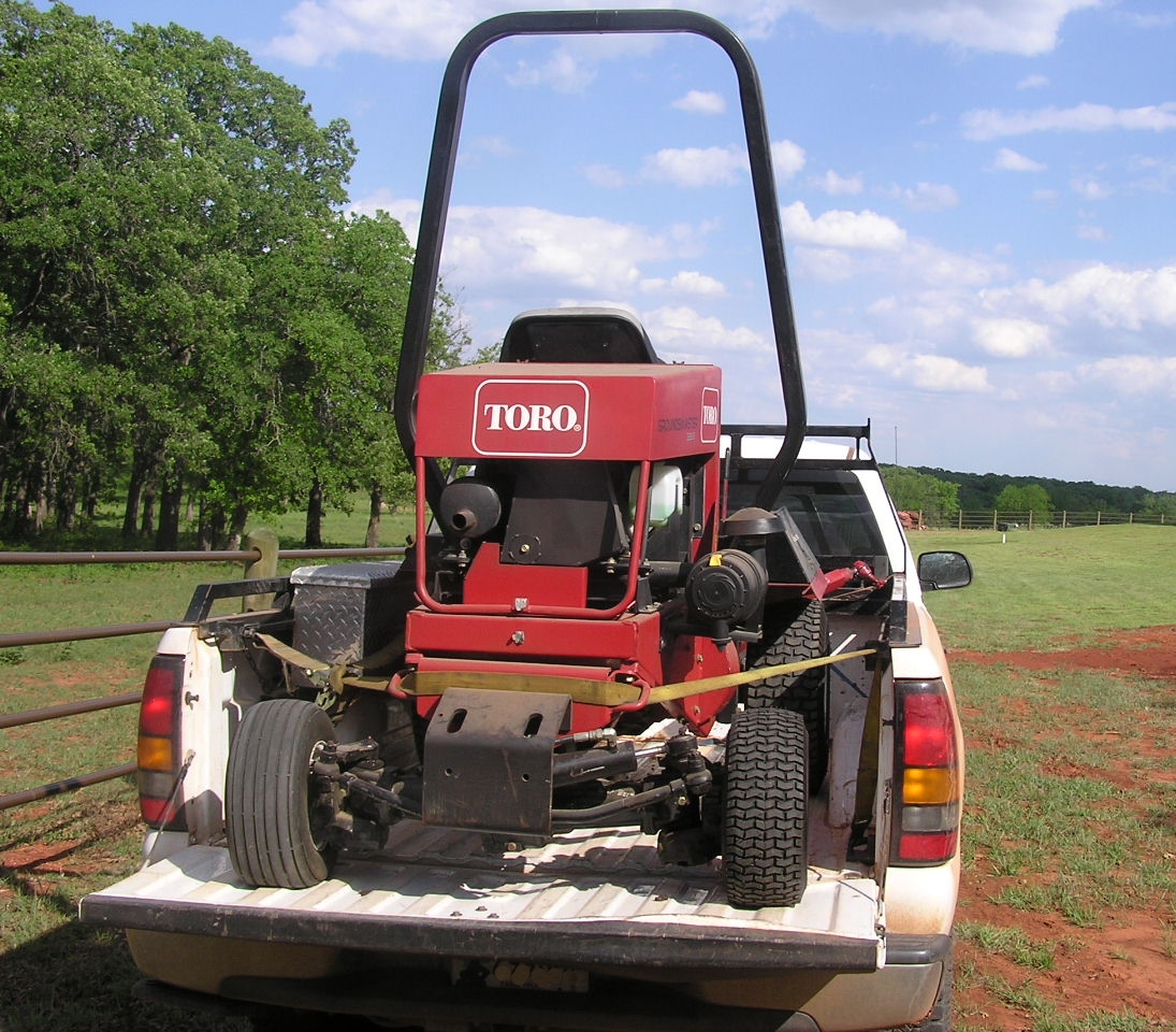

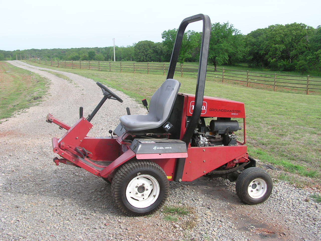

Yep, this type is also the best way to mow, IMHO! :D
The 4 wheel drive traction unit. 28hp 3 cylinder Kubota diesel, hydrostat.

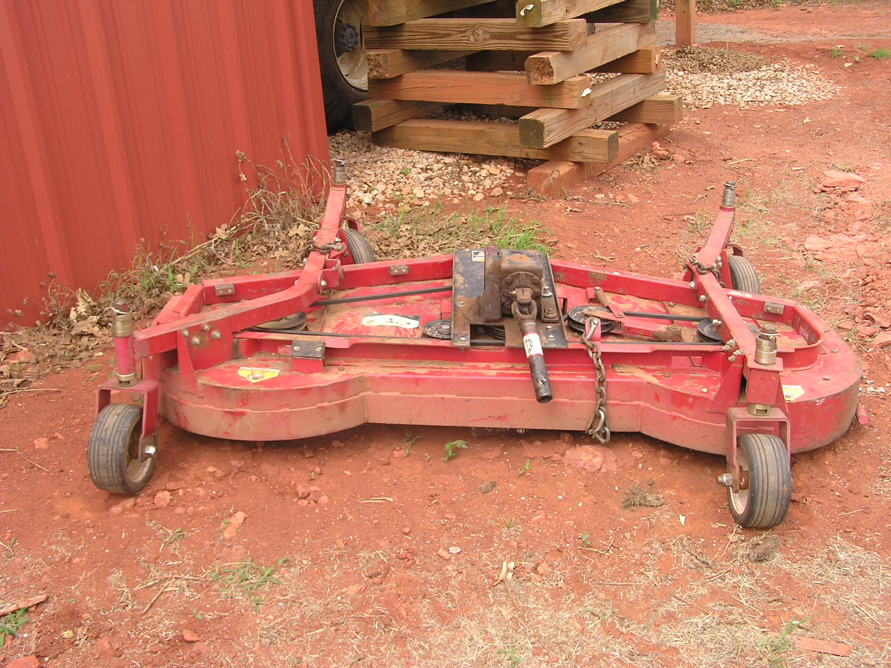

The 6' recycler deck.

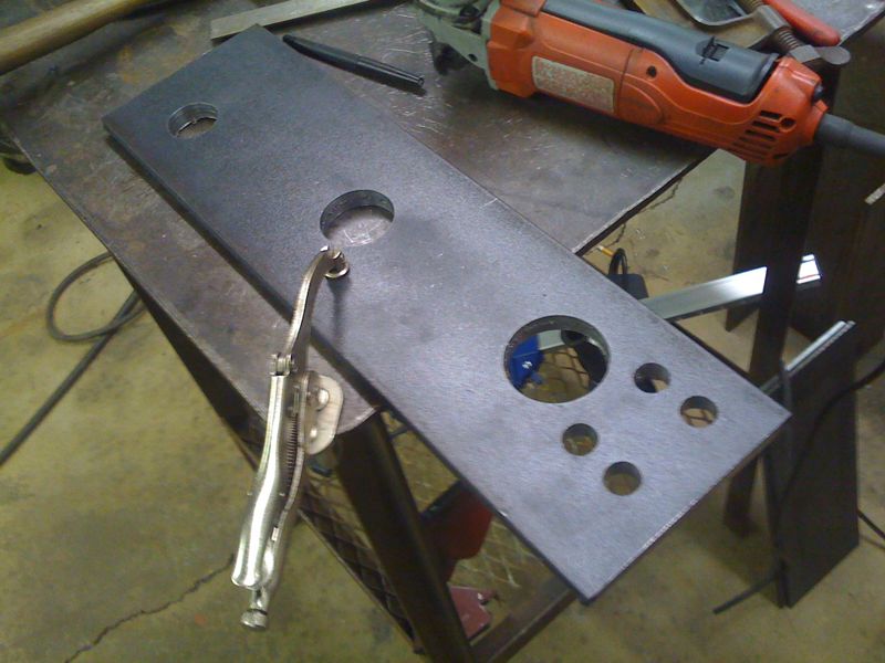

Got the pieces/parts for the mast/tower assemblies all ground and ready to tack up:

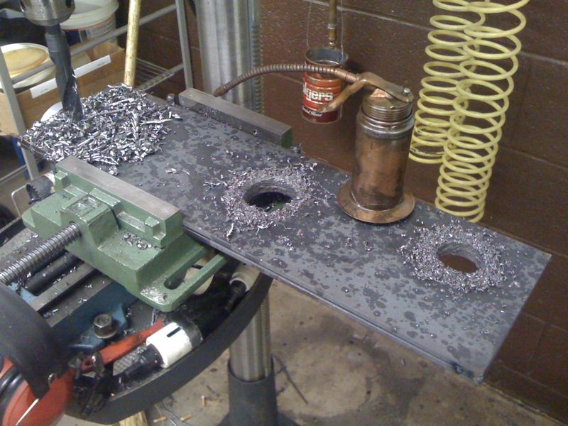

There are 4 more holes (2", one in each assembly) that have to be drilled right on the weld between the top and middle pieces ... so those will get welded up first, then all tacked together for drilling, then split apart for the weld to the bottom pieces.
So that's what's on the menu for tonight.
