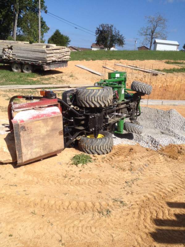

Just a reminder they are not there just to annoy us. They do save injuries and Lives!!
While moving gravel with a little JD1025 today I got to try them out :(
Bucket was low, Ballast was present and being careful. Rear wheel got in a very small rut and was all she wrote. Hold on tight and tuck in. I was very lucky today.

It looks fairly level. I dont see how that could have happened with the listed parameters. ... The seat belt was of no use, as you could have just stepped off as it rolled to spare you the jolt.

Looks are deceiving and to step off, easier said than done! It had a bucket full of gravel and lots of humps & ruts. I tried to correct it when felt it lifting, but was quickly beyond point of no return. If this had been in water I'd have needed a seatbelt cutter.

When you are doing something like that keep the bucket as low as you can and if it starts over set the bucket down on the ground. Ed

Thanks for the tip. I guess I didn't get it down quick enough. Seemed to just have time to hold on and tuck. You just can't be too careful around tractors & equipment no matter what the size. If this had been closer to edge of new basement it'd have been a 9' drop with lots of rebar sticking up

Sounds like you were moving or turning a bit too fast. That conflicts with the careful parameter. W/O seatbelt its extremely easy to step off on the low side, but carries its own risk. ... If ROPS prevents further roll youre home free and would actually fare better that the jolt from staying in the seat.

Yes SPY I was trying to move forward while turning. Not fast, but the wheel got in a rut and lost its balance. Didn't teeter or give much warming, gust went. I'll take the jolt of seat belt over a body part being smashed & pinned. I have larger tractors without ROPS or belts and hope I could jump, but may be wishful thinking. I'll admit I'm new to fel and learned a lesson today unharmed.

With a full size tractor, distances are too great. With ROPS you must stay in the seat. If youre not wearing the belt, hug the steering wheel. ... W/O rops you must jump to the high side. Thats something you wish you could practice at.

How much ballast is that empty bucket??? You need at least whatever the loader can lift, plus some.
I can lift 1800 and have 2000 in ballast. At times more ballast would be better.
These are anchored by the rear wheels so you must have enough to keep them on the ground!

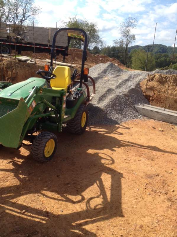

I don't think I had quite enough ballast either. It had been fine up till then though. Also a good point about a rollover on "flat" ground. You never know when you might hit s soft spot, rut, rock, groundhog hole etc. I handy been using ROPS & belt when mowing but may start. As to relying on a park brake I had set it last week and was in front of, behind another tractor when it popped & released. It's nose was sloped down into the barn and had been set about 5 min when it released. More ballast is on my next agenda. image-1950181969.jpg
Also as I look at the pic, my bucket wasn't low enough either. Crap!

Yeah, look at that, bucket way too high in that last pic. That is not a height to use for moving around. The other thing is that if that large rock/concrete in the rear scoop was meant to be ballast, it's movable and can shift. Could actually become a liability, as it could shift sideways on you.
Yea, I see that now. I was in the process of lowering bucket, but should have before I moved and hit the rut :(
I did have the boulder strapped in and tilted up with top link.
I can see now both were bad ideas

I think you had too much weight in the bucket to begin with. When the tractor bounced rear wheels lifted from ground and the tractor rotated on front axle pivot. Since the pivot is below center of gravity (your loader bucket was also likely above the CG) the CG shifted left plus the momentum of the rotation flipped the tractor on its side.
