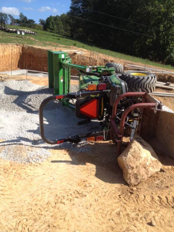

The Boulder in scoop didn't shift, but the whole 3pt was a little wobbly. Turn buckles needed tightened. A small stabilizer bar would be nice too.
I turned it back over with a chain and ford 841. I didn't let it sit long enough before trying to start. The starter would only start to turn over then stop. Waited about 30 min and it started and burnt off the oil. Finished spreading gravel next day without incident.
Phew, yeah, you have to be careful -- you can bend a rod trying to start an engine after it has been tipped over. Maybe you got lucky the starter didn't have enough guts to do that. Normally you can remove the glow plugs or injectors (whatever's easier) and turn it over to expel the oil. Then button back up, check fluid levels, and start.

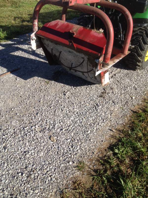

Trying a new ballast set up. It will still utilize the dirt scoop, but using concrete. I oiled everything up real good to keep from sticking to scoop. Also inserted som rebar to help secure and pulling out. If concrete is out, should be able to scoop it back up. Put a cpl pieces of wood form in to cover the two big bolts to keep from getting hung up. I'll find out after it dries image-1378012766.jpg

Trying a new ballast set up. It will still utilize the dirt scoop, but using concrete. I oiled everything up real good to keep from sticking to scoop. Also inserted som rebar to help secure and pulling out. If concrete is out, should be able to scoop it back up. Put a cpl pieces of wood form in to cover the two big bolts to keep from getting hung up. I'll find out after it dries <img src="http://www.tractorbynet.com/forums/files/safety/442900-rops-seatbelts-work-image-1378012766-jpg"/> <img src="http://www.tractorbynet.com/forums/files/safety/442905-rops-seatbelts-work-image-1993827629-jpg"/>
I found out today it's Not coming out? Removed the forms , did a little chiseling, and taping bucket with 3 lb sledge. I hooked a chain to rebar and trailer hitch of my truck to try and pull out. All it did was drag the truck. It WILL come out at some point, just not sure best method. Any suggestions??
Meanwhile I have around 5-600 lbs ballast.

I don't think I had quite enough ballast either. It had been fine up till then though. Also a good point about a rollover on "flat" ground. You never know when you might hit s soft spot, rut, rock, groundhog hole etc. I handy been using ROPS & belt when mowing but may start. As to relying on a park brake I had set it last week and was in front of, behind another tractor when it popped & released. It's nose was sloped down into the barn and had been set about 5 min when it released. More ballast is on my next agenda. View attachment 441580
Also as I look at the pic, my bucket wasn't low enough either. Crap!
Well, just be thankful that you had your seat belt on, a good ROPS and everything worked as intended and you are just fine now and no one else got hurt either. Live and learn. :)

Ballast is important, but a lot of ballast on a small tractor can present a problem of it's own. Sure, the front is balanced with the back when the loader is full, but it can be a lot of weight in motion.

1) are you able to flip the scoop upside down so it stays upside down? If so , then hold the frame with the bucket so it doesn't roll on you and sledge hammer the underside (steel) as this is the easiest way to loosen concrete. I used to relief drive a concrete truck and used the technique to remove lumps of concrete when I got issued a dirty truck.
Yep. That is about the only way to get it out

1) are you able to flip the scoop upside down so it stays upside down? If so , then hold the frame with the bucket so it doesn't roll on you and sledge hammer the underside (steel) as this is the easiest way to loosen concrete. I used to relief drive a concrete truck and used the technique to remove lumps of concrete when I got issued a dirty truck. 2) I had a near rollover years ago. I got away with it because I had dual wheels on the tractor, so it went slow enough to catch by dropping the bucket.
I might be able to back up and flip the scoop vertical. Not sure though, this sucker is really heavy now. If I take it off, I may be able to turn it over with the bucket or a larger tractor. Then possibly lift it up with a boom pole so it's not flat on the ground. I like that it's in there good, But don't like that I could now never use scoop if I wanted. Also it would make it much easier to attach scoop with it out, then scoop up the concrete to put in. This is some tough 4000lb concrete that was used for pouring walls.

Trip it to dump, pull on the block with a chain (to put a little tension on it), then hit the metal of the scoop with a sledge to pop it loose.
Just buy another scoop and cut your losses. I see scoops on the side of the road for sale cheap pretty regularly.
Did the side forms come out? Looks like they could swell up and put a squeeze on the concrete.
... If theyre out it must be stuck on the bottom. Use 3/4 plywood to protect the bucket and a min 10# sledge on the bottom. Alternately a weedburner torch on the sleel bottom would probably break if free by differential expansion promptly. ... Alternately etc - a pressure washer directed at the concrete to steel junction on the sides will cause a separation force and with or w/o a prybar applied may "float" it loose.
Dont wait. You have the best chance while the concrete is still green.

Did the side forms come out? Looks like they could swell up and put a squeeze on the concrete. ... If theyre out it must be stuck on the bottom. Use 3/4 plywood to protect the bucket and a min 10# sledge on the bottom. Alternately a weedburner torch on the sleel bottom would probably break if free by differential expansion promptly. ... Alternately etc - a pressure washer directed at the concrete to steel junction on the sides will cause a separation force and with or w/o a prybar applied may "float" it loose. Dont wait. You have the best chance while the concrete is still green. larry
Thanks to everyone for all the suggestions. I would jack hammer it out before I'd buy another scoop, plus this is a pretty good one. All four cement trucks came at once, so I had to do a quickly form. The side forms did come out, but still had to chisel around the pivot bolts, and behind them towards the front of scoop. After banging the crap outta it and used a T post to pry from the front. Success! It broke free and started sliding. :) also poured a little more oil in behind it. made sure it Will come out now, and pushed it back in to use as ballast. Had to use T post and chain tensioner to pull back in and lock it In place .
Once I do take it out I can do some fine tuning on the fit.

it looks to me that in all your pics, from the rollover to the later pics, is that your ballast is very high. You have a very heavy, very high framework and the 3pt is set a lot higher than I'd carry it.
Might be something to consider in your future design plans.
