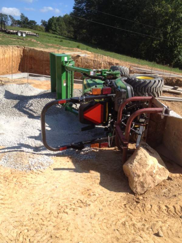

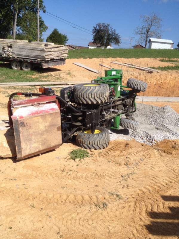

I hope others learn from this too that they DO work. First time I've ever tested one and hope the last. Even though this was a scut and a somewhat mild roll over, it could have certainly been deadly. All I can say is Use Them! Your family will thank you!
Did get the rest of the 10" gravel spread and leveled today Very carefully. Added more ballast and kept bucket 2" off ground. Still had to drop the bucket a cpl times removing the gravel ramp.

I read through this pretty quick (maybe asked and answered) but I am looking at your ballast. Is that a big boulder in your back scoop? If it is maybe it didn't help when the weight shifted on the tractor (it shifted as well and helped pull you over).
Also, how did you right the machine? You let it sit a bit before restarting (drain down?)

The Boulder in scoop didn't shift, but the whole 3pt was a little wobbly. Turn buckles needed tightened. A small stabilizer bar would be nice too.
I turned it back over with a chain and ford 841. I didn't let it sit long enough before trying to start. The starter would only start to turn over then stop. Waited about 30 min and it started and burnt off the oil. Finished spreading gravel next day without incident.
