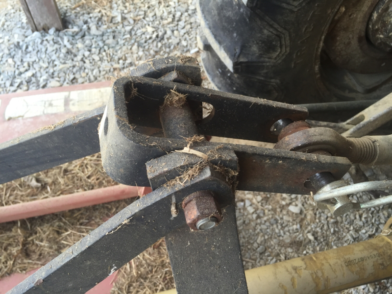

Thanks all! I moved the brace down a hole and low and behold there was the top link connect. Don't know why I didn't think of that before. Since II the brace has a chain at the end by the wheel there is no need for a swivel? Here is a pic after I lowered the bar. What has me concerned more now is how the chain is too close to the clutch. It was mentioned earlier that should be covered and I will be looking into that. I can see bad things happening because of this Why replace the bar with a chain? How will that be better....
The thought is in a bad bind the bar could put pressure on the deck and maybe go through it. So full length chain wouldn't have that ridged transition point. You really do need a cover over the clutch but you could make your own with some rubber belting or a thin piece of metal. Think you will find the is more clearance there while mowing than you think. Very seldom will you run your skid plates on the ground. It's a rough cut mower not a finish mower.

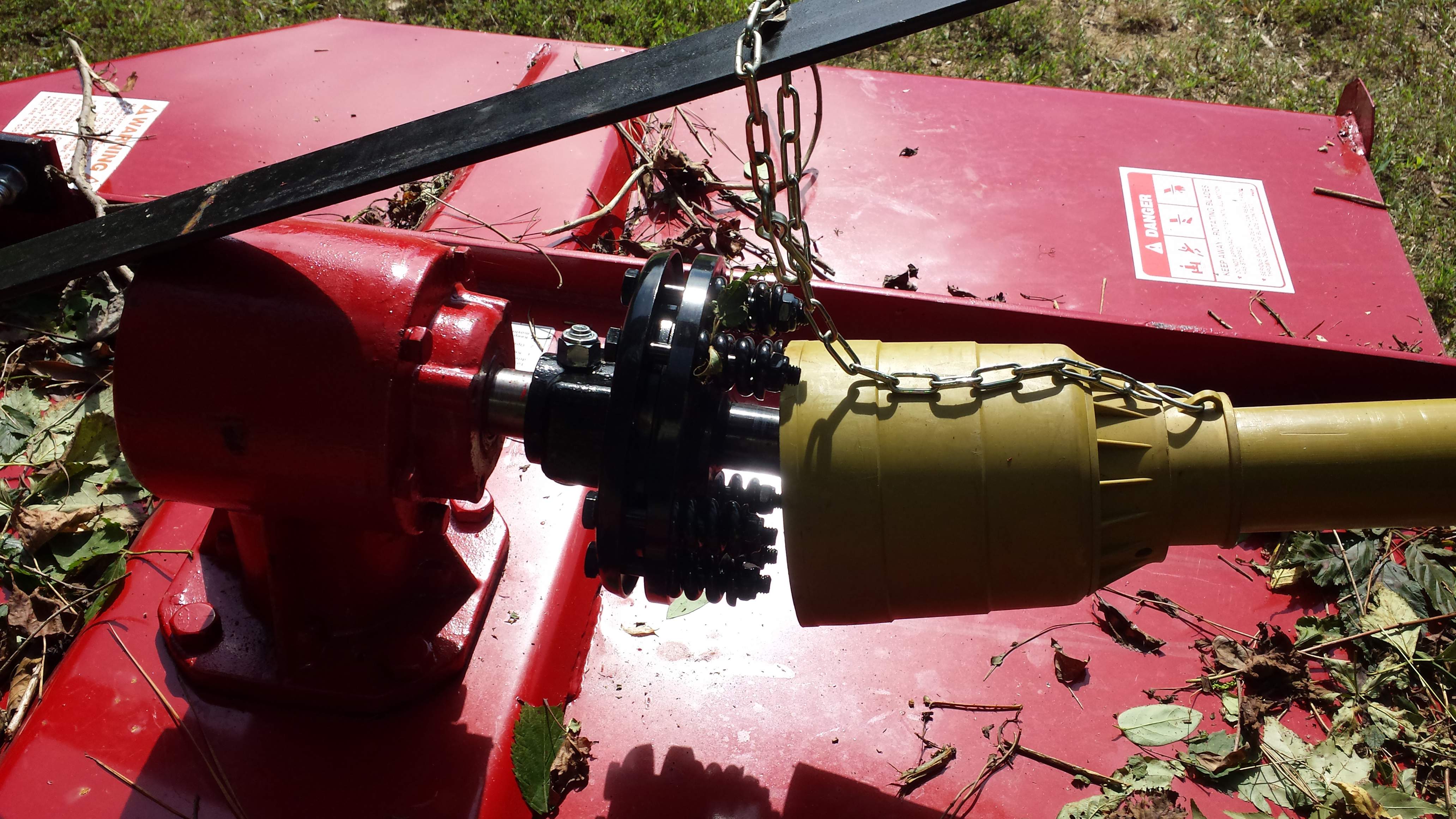

That chain is to prevent the pto shaft cover spinning. Shorten or remove it as its not neccessary. The plastic cover stops as soon as it encounters even slight resistance.
A chain in place of the brace/bar, while having some advantages, may droop onto the slip clutch. Dont let that happen!
