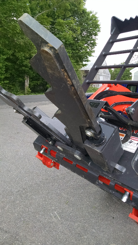

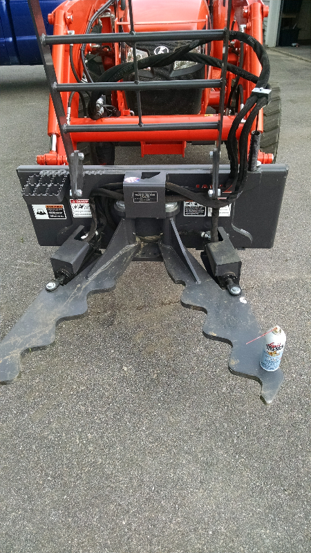

I went with the Jawz for several reasons.
I wanted both sides to articulate. The jaw are on the same circuit so they self-center. So it is ok if the tractor is a little off center. With only one moving jaw the loader may get torqued to the side a little as the jaw closes. You then are gonna put these huge forces on the loader with it twisted some which seems might put the loader arms at risk.
These things are primarily designed for skidsteers which are easier to position on center and have more robust loaders.
I also decided the wavey jaw pattern had some advantages in versatility. Just my intuition.
Lastly, I wanted stout greasable hinges and protected cylinders. You are operating these down in the dirt so frequent greasing seems prudent.
I also use it to move and place granite rocks for walls etc. Here especially it would be nice to have hydraulic rotation.
