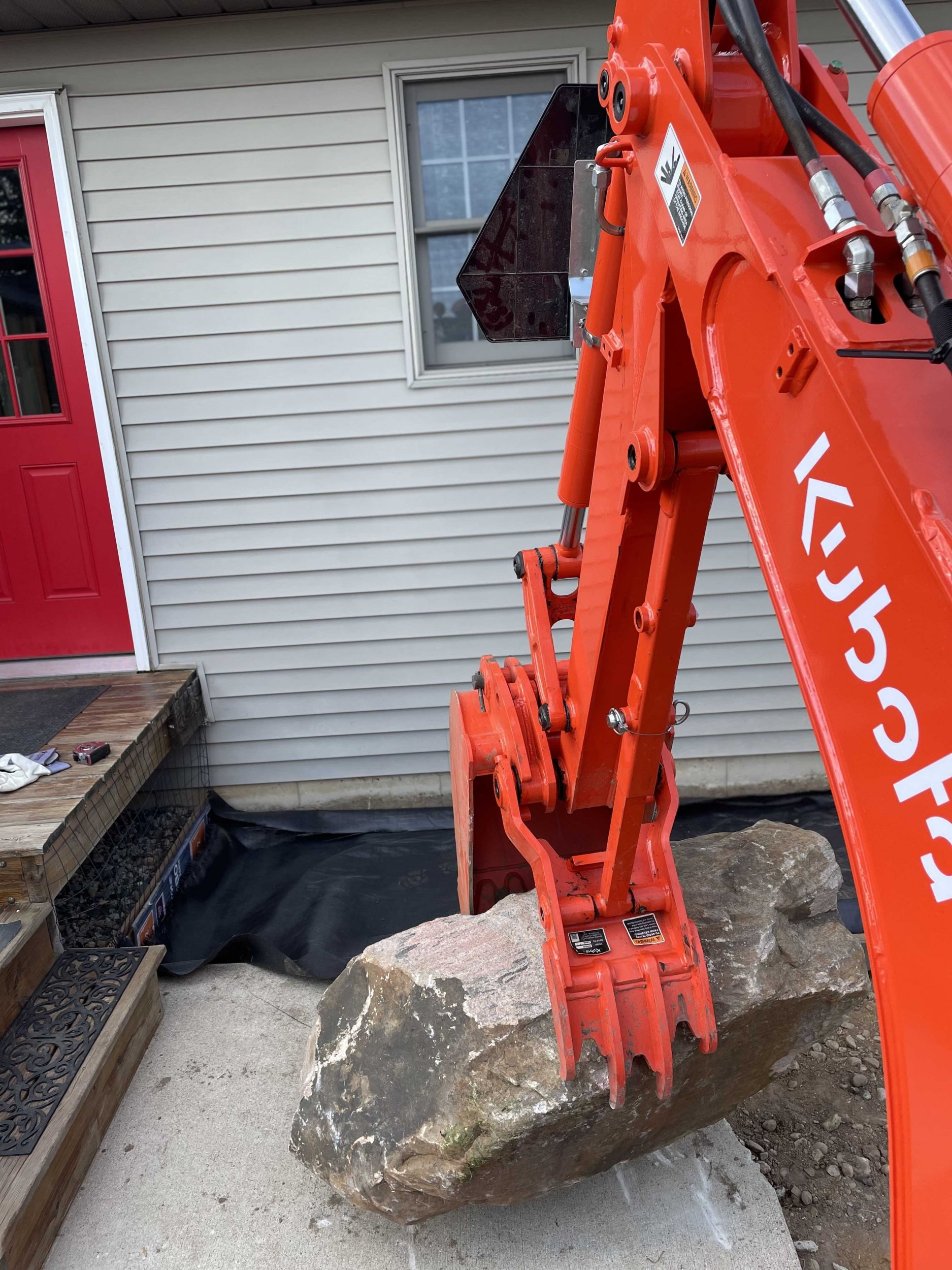

Can't beat the BH for placing landscape boulders!

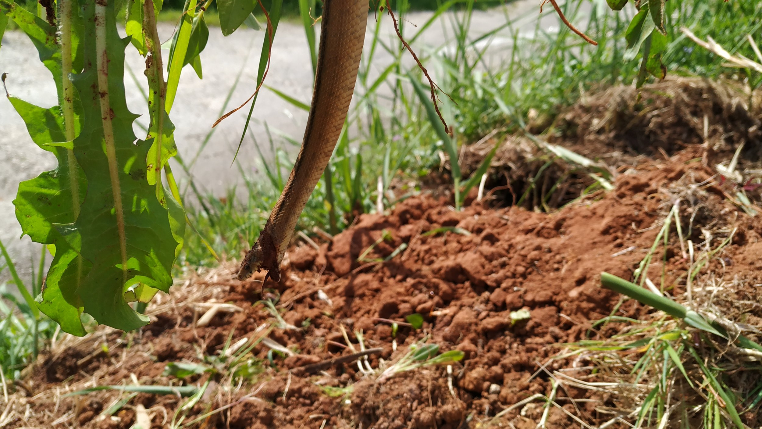

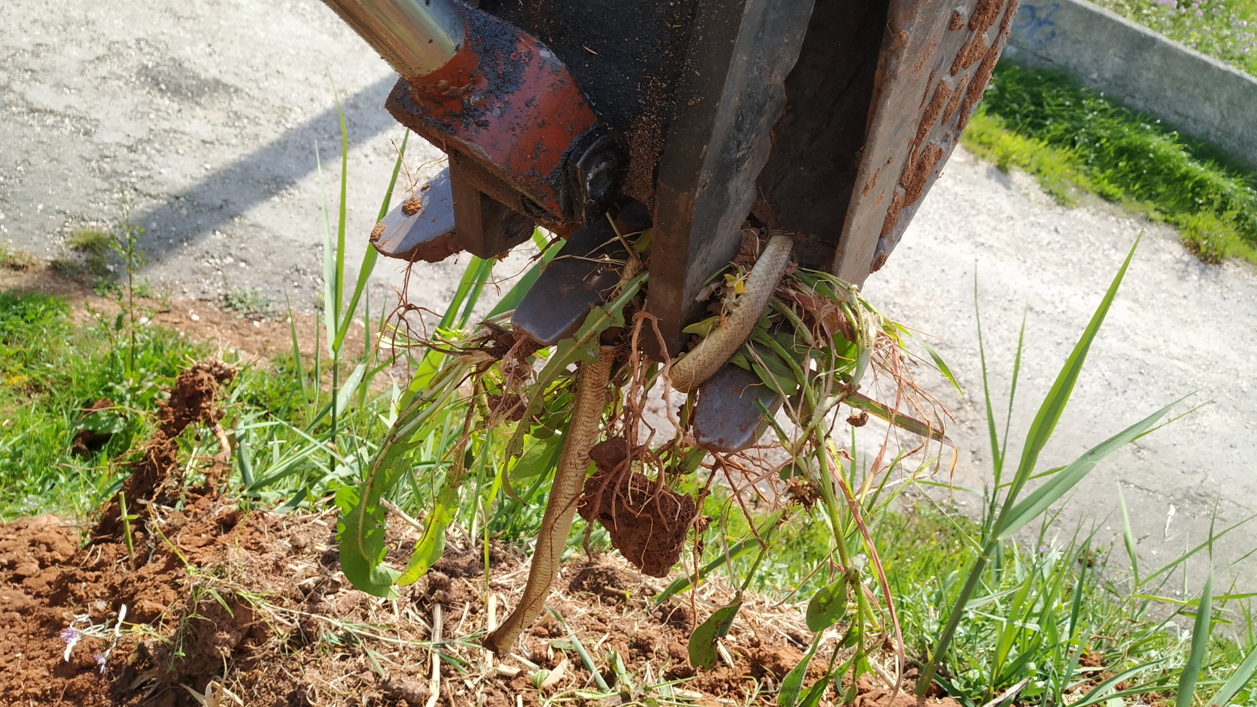

View attachment 712746 View attachment 712747
I prefer the way your bucket teeth close.
Mine meet at the tips instead.
/ Rpms for backhoe #54
I'm glad I made it that way. It's great when pulling stumps and you want to pull those thin but really annoying roots as I can just pinch those between the thumb and bucket without actually just cutting them.
/ Rpms for backhoe #55
Right! Its great for placing rocks.
I finally figured that if I keep pressure on the thumb while rotating the bucket out it will keep hold of the rock while I extend the boom&dipper. I would almost be able to gently set that rock of yours next to the wall and still keep the flat side down.
