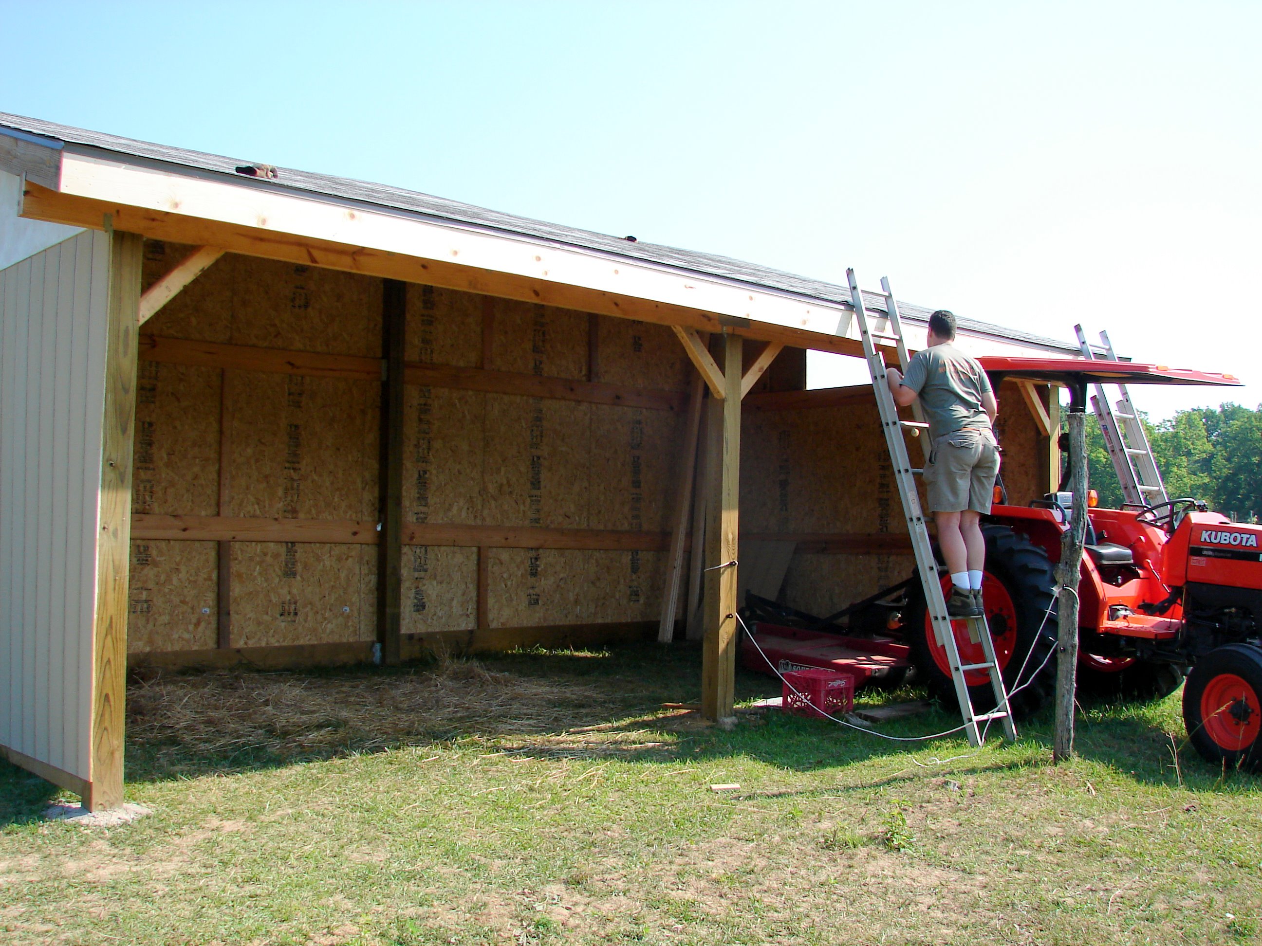

OK, today I put the finishing touchs on the framing, and all the OSB is on top. I added some more blocking between rafters and straightened out and reinforced the top beam.
I had planned to put a variety of old, mixed colored shingles on the roof. Now I am having second thoughts, especially since I found that I only had about four packs of shingles and would have to buy a bunch more to get to the 448 SqFt. that is the roof. So I put off putting on drip edge and tar paper.
Suggestions for roofing material? My considerations:
-This shed is on the top of a hill and will get plenty of wind.
- It is only my wife and me handling the materials.
- I don't have tools for cutting large pieces of metal.
- I only want to do this once.
Suggestions for siding two and a half sides? I can add more purlins if needed. My considerations:
- The horses should not want to eat or break it.
- I have lots of tools for working with wood.
- It would be nice if it looks good.
Thanks for looking, and thanks for suggestions.

I would use 29ga metal on the roof and for siding. As for cutting the roofing and siding. Check around with metal siding/roofing dealers (not Home Depot or Lowes). The place I buy my roofing/siding from will order it for me in custom lengths. It's priced by the foot but I really only pay by the inch.
For instance, I made an order this morning and the price was $1.83 a running foot (for colors) for 3' wide 29ga. metal. I ordered 8' panels that were $14.56 each. I ordered 7'2" panels that were $13.05 each. I didn't have to order an 8 footer and then cut off 10 inches. They will order in foot/inch increments. I actually save a lot of money on siding doing it this way and it saves a lot of cutting.

Have you researched what happens when you put metal roofing on sheeting? From what I've been told, and I don't know this for a fact, but metal on sheeting creates moisture pockets that lead to premature failure of the roof. You will have to put wood purlins, or strips across the OSB before you attach a metal roof to it.
Felt paper and shingles are used on OSB sheeting, but other materials need to have some degree of air cirulation. If not, then it needs to be totally sealed on the bottom. Spray on insulation works for this, but not much else will have the same results.

While in the process of obtaining a permit for my pole barn, I came across a variety of metal roofing. Several different brands and styles. But they all came with a set of installation instructions. Some required felt covered plywood or OSB as an underlayment. Some required felt coverd pw or OSB with purlins on top. Some required purlins only. Others had different instructions for a variety of applications for the same product. Pick a product that is designed for your application and follow the manufactures instructions and you will be fine.

I have to bring up what Eddie said before...did you replace the header on the tall side with 2x10's? Looks real skinny up there, there's going to be quite a load up there, and don't you guys get snow too? Heavy!!

Thanks Coyote, yes, I did add to the header after jacking up the sag in the roof line. It is straight and sturdy now. We get maybe a few inches of snow a couple of times a year on average. For the once in a blue moon times that we get a lot of snow, I would think that most of it would blow off the roof since the shed is on the top of the hill with open pasture all around.
Firefighter, I am not worried about condensation because the shed will be open on the front and I have left most of the bays between the rafters open so that warm air can exit through the high side. We want more coolness than coziness.
To make it cooler, I have decided to use white shingles for the roof. Part of the decision is because I had a couple of bundles of white shingles (and I am ~frugal~), and partly because I can handle shingling by myself better than large pieces of metal. (I am anticipating that I would be getting any help from my wife up on the roof. We'll see.) I put on the first couple of coarses this evening before dark because it is beautiful weather here in the Bluegrass State.
